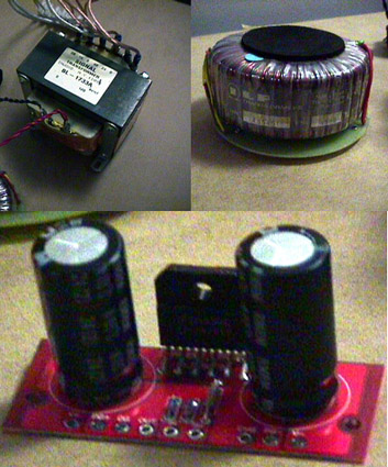

Coulomb said:I have a spare 750VA 2x30VAC Toroid, I could use that then? 42VDC Rails.
Anthony
It might be too much, especially if you add 750VA transformer's regulation factor. Just build supply and check DC voltage, it shouldn't be more than 40V.

lets see if i can get some more people in the spirit of building these things. a struck gold today at the parts center. found me a toroid out of an older electronic test equipment thing that gots dual 22 secondaries (my first toroid too). also snagged some 2200uf 35v caps to hold me over til parts express gets here. so figured i'd post a few more sub-par quality pics of the work in progress. this one includes the transformer i bought from apex jr a while ago (it'll get used for something one of these days), the newly discovered toroid trans, and my first gc board with today's salvaged caps. now just waiting (no rush though, take your time) for Brian's build instructions (just to make sure i'm 100% right in hooking these things up) and i'll be up and going with at least a stereo pair (the 6-ch will wait til i can get some good connectors)

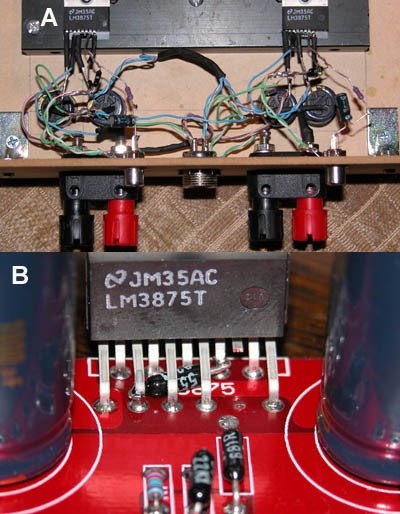

I've completed soldering the components to the pcbs. I haven't done any soldering in 20 years, but things went pretty well. I was worried about burning the chip when I soldered the negative feedback resistor, so I clamped the chip and resistor together on a 1/2" copper plate that I have down in the basement. this weekend I'm headed to You-Do-It Electronics this weekend to round out my supplies (wire, speaker posts, inputs...). I plan on starting with cheaper parts and then upgrading as time and $ permits.

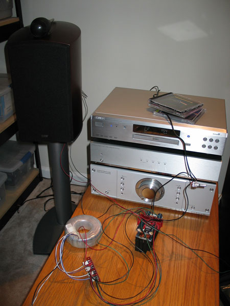

Listening to it
I got my other channel thrown together, checked for any dc on the output and then tested on the spare NHT, all is good. So, I moved it over to the B&W Nautilus 805s, using a Philips 963SA as the source.
Very good sound quality. Sorry, but I can't begin to describe sound in the way that Stereophile, WhatHiFi, et al do. Never the less, I don't hear any real flaws. The bass may not be as good as I think it should, but I am still in the prototype stage. I only have a 2x14 150VA transformer, I'm waiting on a proper one from VM. And this is the "standard grade" parts version I built first to make sure I wanted to invest more into it. The wire is all Radio Shack 20 gage stranded, and the input is one of those cheap Sony interconnects they (used to) throw in with their components.
Hm, maybe the bass is pretty damn good, just got to a better track on "A momentary lack of reason." Pulled it out and stuck in DSotM, straight to "Money." Very good sound!
The only problem with this amp is my 4 month old daughter is asleep in the next room 🙂

I got my sound approximate 5:30 Pracfic time. One Word "Beast" it is loud as hell ! It even louder than my Old IGC that I assembled b4. THe bass definately tighter and louder than my IGC. Treble still good. 😀 If I have this setup (this NIGC + my bookshelf speakers) and play music like 75% of the full volume in HK at night. I will be complained by 8th-10th floors above me. hehe😀
Dear Fellows, I must say that I start very late this hobby, I would like to share with you my first attempt to build a NI-GC (using Peter D schematics, plus a CAP in the input) I did work very well (This is my first project ever), actually looks very messy. Thanks to Brian and its nice PCBs now I am going to build a couple of them (prettier that my first one). In the lower part of the picture you can see an alternative way to put the NFR. Sorry for the language
