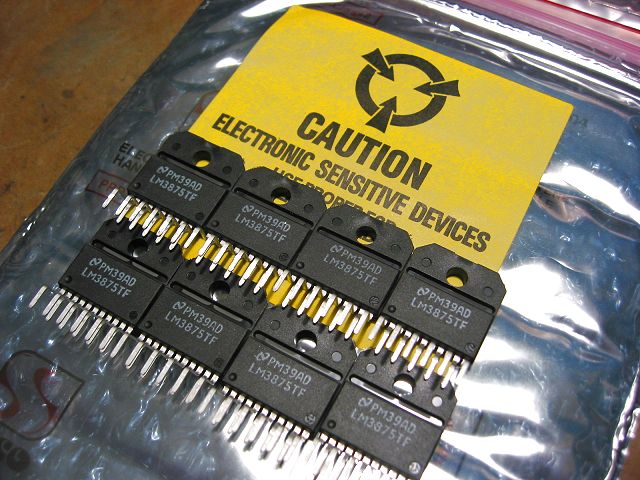

thanks for the info, looks like I will have to fire up the dremel then.chipco3434 said:Yes. Anodized coatings are insulators. Not great because the slightest scratch goes through the coating, but still an insulator.
Also what is the size of the hole in the 3875 chip? I need to know what size the tap bit should be.
AJ Bertelson said:Does anodizing affect metal the same way paint does? Do I have to sand away until I get bare metal to ground my plug?
Anodizing puts a aluminum oxide layer over the aluminum, which is the same material as the insulators that I sent out with the kits, but in a much thinner form, which could cause you problems if you accidently scratch it during mounting.
Brian
AJ Bertelson said:thanks for the info, looks like I will have to fire up the dremel then.
I used a #4 tap for mounting the gainclone with the insulated package and rubber bushing. If you are using the non-insulated version, a #6 screw will work.
Brian

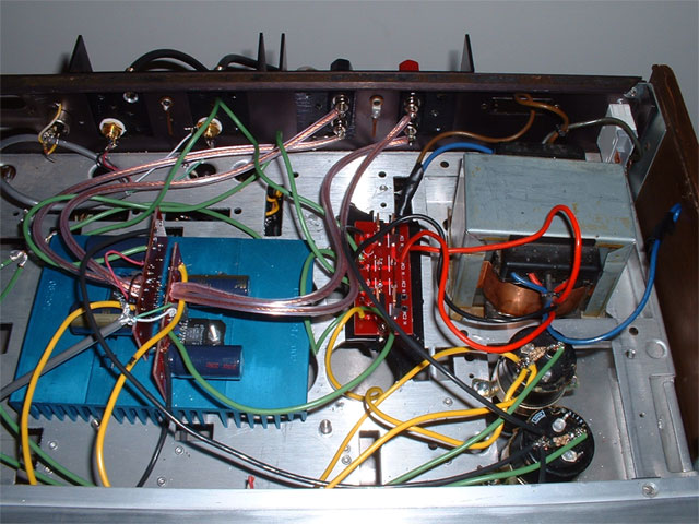

Monster Clone
For cost and convenience, I used a spare transformer I had lying around that came out of an old (circa 1980) yamaha amplifier. It had what I could best describe as two center taps on a single secondary. One set of wires measured 18-0-18, and the other 36-0-36. Since the latter was way too high, I opted to use the 18-0-18 tap for about ±22V rails and roughly 20Wrms output power. Just for the heck of it, I also threw in two 10000uF caps from the same yamaha amp. It sounded good, but I seemed to have a little bit of distortion during transients, which I attributed to clipping, given the high gain, low rail voltages, and >1Vrms output of my old CD player. So, today I decided to crank things up a bit.
I connected the 36-0-36 CT wires to the rectifier board, which resulted in ±48V rails. A quick test showed that the output voltage into an 8-ohm load to be 25VRMS with a 1kHz sine wave, slightly below clipping. Thus, my amp went from 20WRMS to just under 80. Next came a listening test. The transients sounded much better, and the bass was noticably more forceful, and also more responsive. Turning the volume control to maximum (which required me to cover my ears), I could still detect no clipping or other objectional sound being created by the amplifier. Of course, this is with very crappy pioneer speakers, but I'd say it sounded about as good as one could expect from these speakers. With the large PII heatsink I'm using to cool the chips, they get only slightly warm to the touch at moderate volume levels. I don't know what effect the increased voltage will have on the longevity of my chips, but the results seem to be quite pleasing.
I guess I should include a disclaimer: You are responsible for anything you do to your own amplifier. If you choose to run your chip amp at higher than the rated voltage, you may be risking your amps and/or speakers. I have not tested the chips with a <8Ohm load, so I don't know if it is safe. Etc., Etc.
So far, my experience with stepping up the voltage a bit has been a good one, and It seems that the LM3875 can happily operate with up to a 2x35V transformer. Naturally, I might post next week saying I smoked the chips, but I think they'll be ok. Anyway, I think I'll rate this modification "two evil grins"
. Oh, and of course, a couple pictures...
The chassis is from an ancient scott stereo I gutted.
