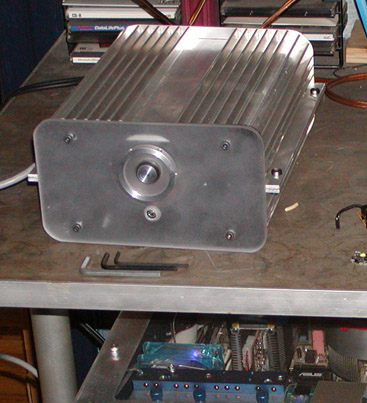

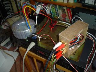

finally got my camera back
a few pictures of my clone. And yes, i have reused the case (since i blew up the left channel some time ago i figured, hey, let's just get the old thing out and replace it with brian's boards).
I'll post some pics of a completely new one tomorrow (if i can get it back from the guy i lent it to).
second picture features my "passive shunt mode pre" (ahem 😉 ) which is hellish thing. For some reason (everything's grounded properly now) if I connect it to my amp, i've got radio again. If i don;t, it's dead quiet. Strange.
Brian, if you want i can email you some larger (and better quality) versions.
Re: finally got my camera back
Looks good! Drop me an e-mail with a zip of all the pictures (higher quality is good), and I will put them in my gallery.
Brian

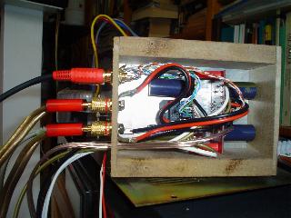

sorry guys, last one !
A second brianGT kit based gainclone. This one features an active opa627/buf634 based pre, alps volume pot. It's fully BS proof: all silver wiring, teflon insulation etc.
The shop I went to for wood didn;t have the same stuff as last time so i just took 4cm thick multiplex (which i intend to replace with the real stuff later). Have to fix some rf shielding too. Maybe I'll use some copper foil.
nice work matjans
Looks oke to me!
Can you post the schematics of the preamp/buffer? As well as inner interconnections and your earthing scheme?

the schematics are to be found somewhere in this diyaudio thread
Most of the resistors went to the underside of the pcb. I've left out the small output resistors as i couldn;t get it into oscillating so i thought what the heck. Let's at least in part adhere to the 'less is more' slogan.
