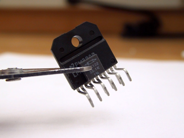

Brian:
Excuse the n00b q, Why is the precision resistor snugged up to the LM3875?
speaker
I believe he said that it was very important that they be as close as possible. There are 2 ways you can do it. You can solder it as shown, or solder it to the ends of those pins on the bottom side of the board.
There is more information on the top of this thread
http://www.diyaudio.com/forums/showthread.php?s=&threadid=28743&perpage=15&pagenumber=29
speaker said:Brian:
The resistor is the negative feedback resistor. In order to obtain the best performance from the LM3875, the feedback look must be as short as possible. This component has the most effect on the amplifier's performance.
This resistor can be soldered right in front of the lm3875, or on the bottom side of the pcb.
Brian
Brian
Ah, that makes complete sense now and is an elegant solution. It appeared that you wanted it to track thermally with the output device and I could not figure why.

I like the appearance with the resistor in the front the best.
Another option, if you are using the T package along with the thick thermal insulator, would be to place the resistor on the back side of the LM3875T, and you can probably even get it a bit closer to the actual leads. This is what I did on my prototype.
I do still like it best as pictured below.
Brian
