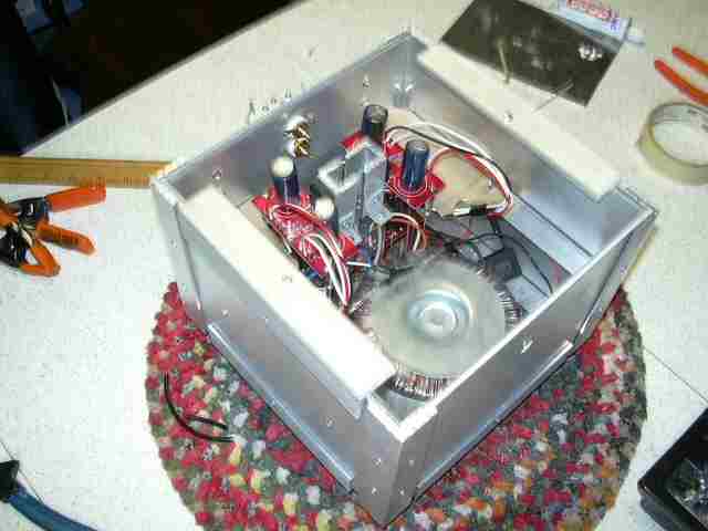

Now my amp is working!!!! So everyone can help out around here
even those that are critisized for asking too basic questions!
Here's a photo of my amp- well actually it's for my son,
I renovated some old Boston Acoustics A70 speaks for him with new surrounds, and upgrade of crossover parts
Sounds very good, but I don't think the speakers are good enough for an amp review.
Still, a great sounding setup for the money- lucky kid!!
I hope I get him used to good sound to trick him into being an audiophile!

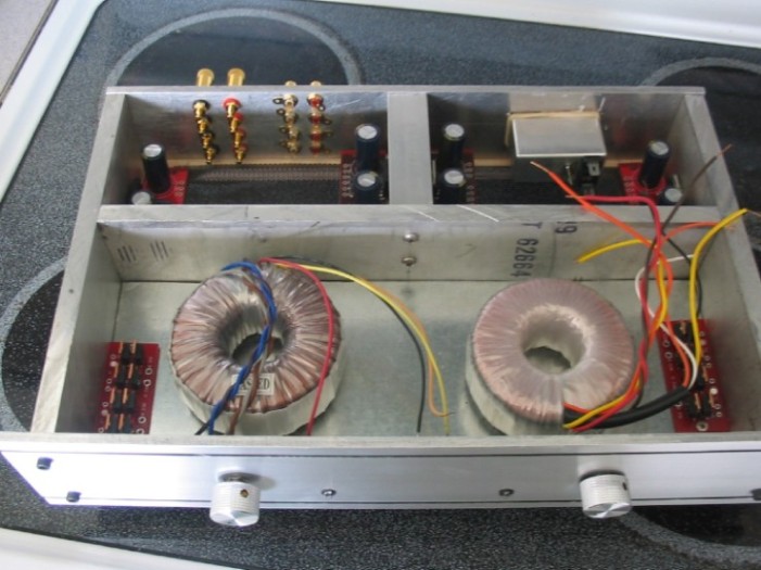

Thank you for the kind words, It is very exciting to have it work right away!!! Also I would have looked pretty lame in my son's eyes if I never got it working. When he last asked when it would be done I said a week, and he asked "a real week, or a DIY week?" A DIY week is about 2 months-It's like dog years...
I have the Avel Linberg 330VA, 2x25V output. If the leads are the same color, than I can't imagine any problem if you hook it up as I did.

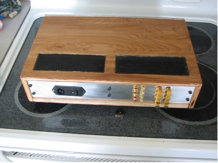

Yes, the trap is the box. As an architect, I've fallen into that trap a million times. I always want something cool to blow my friends away with, then it gets complicated, then I never finish.
I HAVE learned though.... this amp is for my son who is 15.
people that age never want anything too radical. So I avoided the trap by just ordering a Par box. Not flashy, but looks like an amp, and it's finished!! Actually looks better than the pics.
For MY dual transformer, model, I'm ABSOLUTely doing the wood plank approach. Even with the Par box, all the time was drilling holes, adjusting componants,
