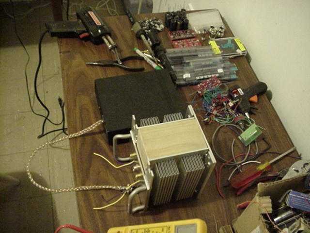

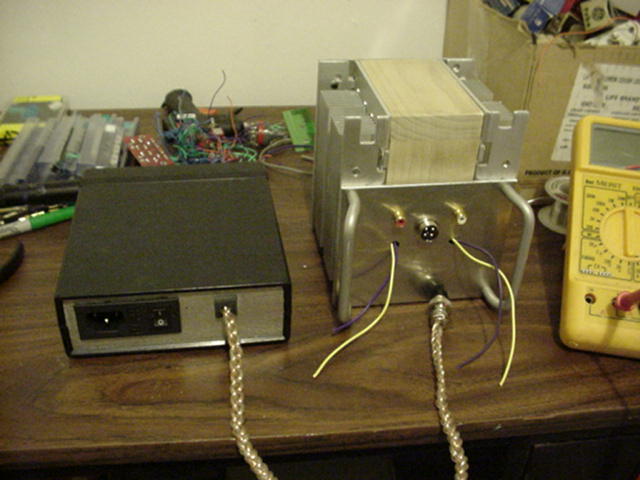

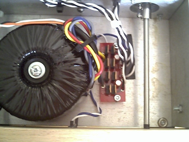

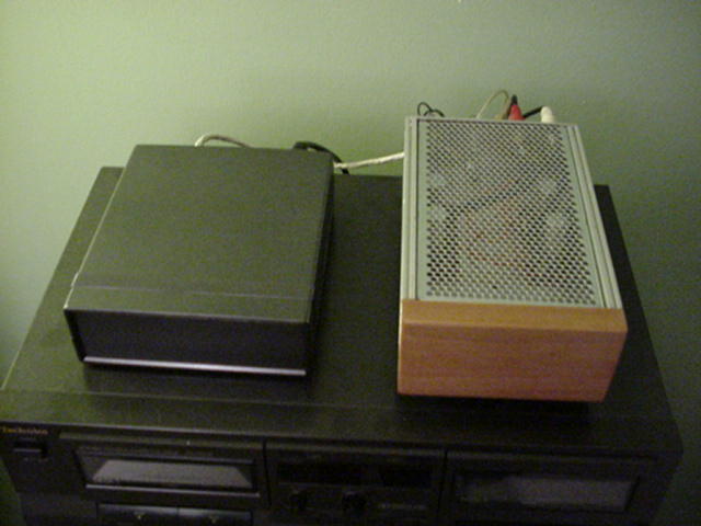

MIB said:Finally I finished mine......
This pic shows the initial testing (in the kitchen 😀) using an iPod as source. I built the clone as power-amp without volume pot, so I took the only device with volume control I had.

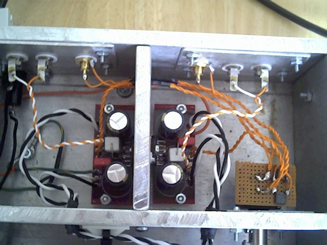

Some pictures of the two together and the internals of the boxes:
As to sound, I am pretty impressed up to now. The sound is detailled, bass is deep, and the clones do a fine job driving my 91 db efficient speakers. Loud enough for me!!!
The DC offset was nice allready from the start (11 mV and 20 mV resp.), but for safety I added the zobel network, it might go lateron.
On the downside: the amps are very sensitive towards mains peaks/dips, so that even switching of a light causes a tick in the sound. The spikes caused by my fridge are simply horrible, time for some thorough mains conditioning overhere. Connected to my home cinema receiver as pre-amp, I also hear a slight humming through the speakers, audible only when the volume is low. When volume is increased, hum stays constantly on a low level. Any idea what this could be? Grounding? I will check for ground loops etc.....

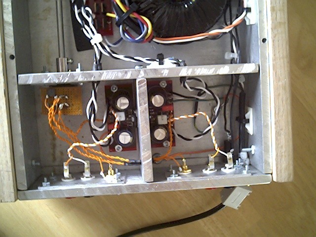

Here's mine. It's got Pedja's discreet reg. ps and buffers. The amp boards are under the buffers and the rectifiers boards were cut in two on mounted on the reg board. More details here:

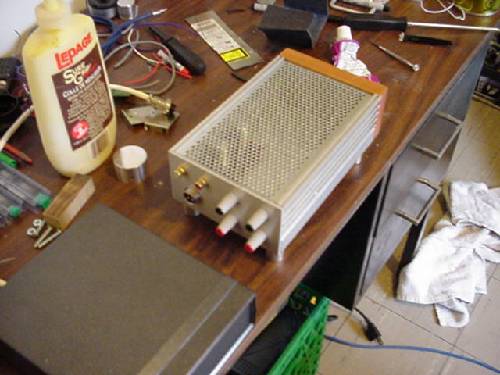

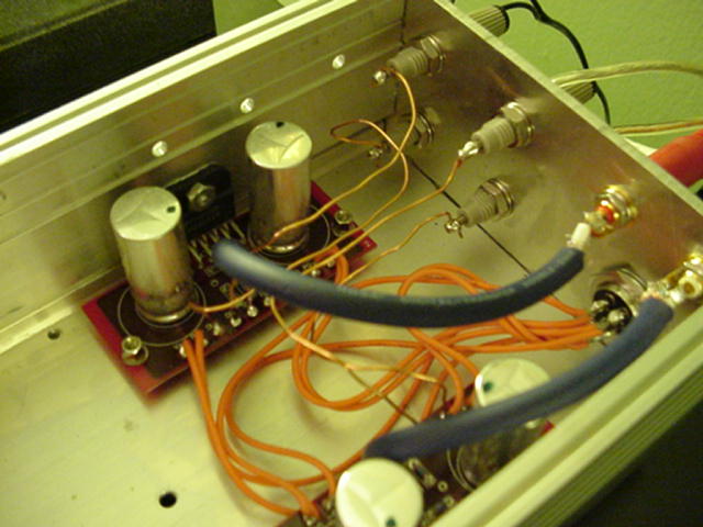

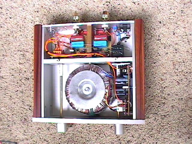

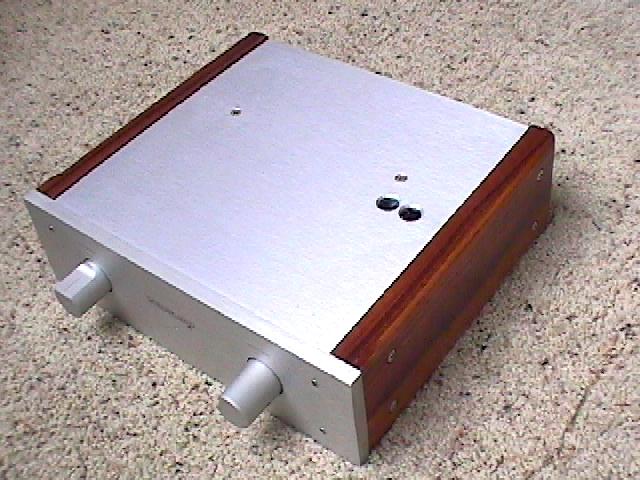

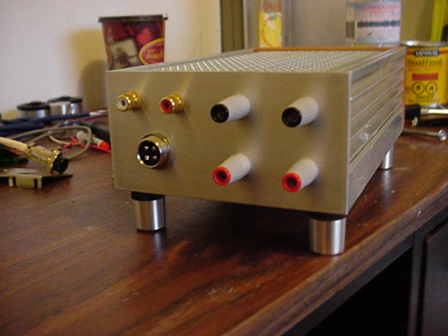

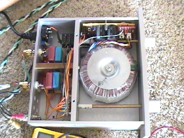

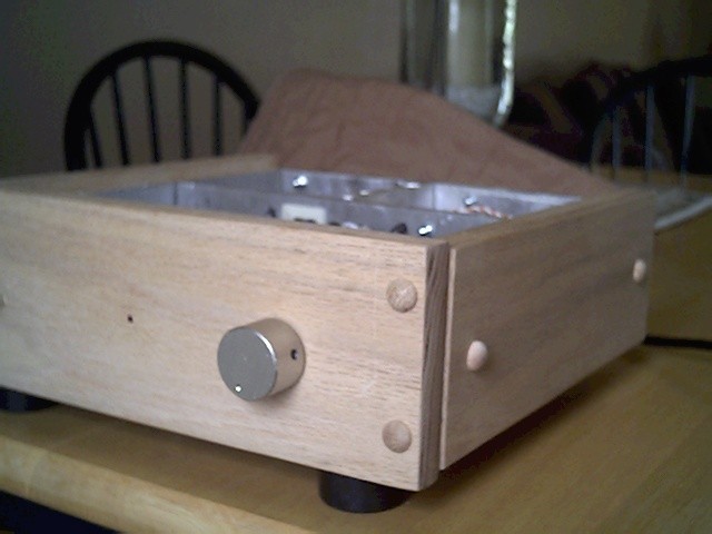

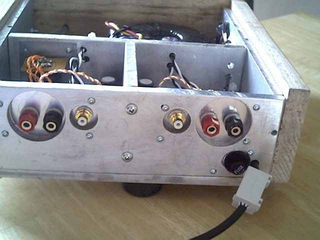

I have just completed a integrated GainClone BrianGT kit using the V2 boards. (Thanks Peter)
I had some 3/8" aluminum plate I had cut up from work (it was free) so I assembled and added 3/4" solid oak front & side pieces.
I used a series resistor (MK132) with a shunted Noble Pot and used a single pair of inputs.
There is minimal DC offset and no audible hum. There is no series cap on the input and sounds more natural than my heavily moddified Linn LK-1 & LK-260 preamp/power amp combination.
I am posting some attachments in the following posts.
Thanks,

Cleaned up a bit:

Sheldon,
Loooks fantastic. Shows the potential and versitility of that chassis. Looks like a "lever action" 😉volume control. Quite clever.....one could link 2 mono volume controls in the same fashion.
This also shows that there is room for some mods in those cases.
looks like you are running out of room though!
