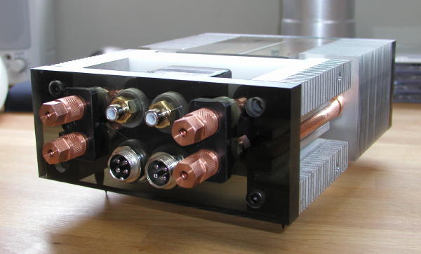

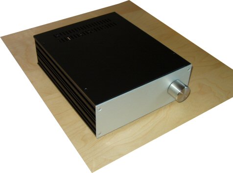

I guess it is my turn to post some pictures (this is my first post on this forum). So let me introduce my GC using BrianGT boards. Main ingredients:
- BrianGT premium kit
- 300 VA 2*18 V toroidal transformer
- DACT CT2 stepped attenuator
And here is the result:

mhr,
I like your amp. I would like to add your pictures to my gainclone gallery. If you are willing, can you e-mail me some pictures (800x600 preferred) to my mail at:
pictures@tastybeef.com
Anyone else that wants their gainclone built with the boards put in my gallery, feel free to send an e-mail to this address with pictures. Don't worry if they are too large, as I can size them appropiately.

Hi Wonderchild,
I am glad you liked my amp. The case is bough from an Italian company called Audiokit. Model is Galaxy Maggiorato and type is GX288. I have seen similar cases available from bigger vendors also, but never in the higher (= Maggiorato) version. I am not sure if they ship overseas, but inside Europe everything seemed to work fine despite their horrible web pages.
The aluminium block inside is custom made.
Mikko
PS. BrianGT: I will send higher res pictures to you later today.

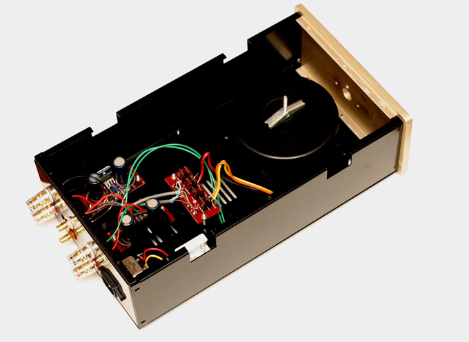

My first gainclone ever..finished...
Built it quickly in whatever I had lying around..so I could listen...have had these boards finished for ages...and finally got round to building it..it's now 3am in the morning ...but I am going to bed content.
It actually sounds very very good!
The first thing I noticed...being used to my 4 watt or so SE amp...is that the gain is MASSIVE....the other thing is that my dc voltages where ALL 36,3 V...on both channels...the + 36,3 and the minus was 36,3.. so four measurements of 36,3v..
I've found one curious aspect that I have not read anywhere else..(and one that I have read of before)..
When I have my DVD player (transport) turned off...I hear an immense amount of hissssssss...with the player...playing..or just on..the noise goes away???
The thing I have read about was...the sensitivity to the mains...switching the cd player on...a massive thump...(more a click really) can be heard.....why would the gainclone be so sensitive to this?
Any way...I am a happy chappy and will report back after it has burned in.
By the way ...I am using it as a power amp..My preamplifier is a tube based transformer coupled pushpull parafeed amp (Raleigh Audio Linestage) aka Mood Indigo.
I've always found the following link one of the most absurd on audio....but I've waited before commenting..until I had actually heard my own gainclone...
http://www.hilberink.nl/amps/lm3875schema.htm
I now know that the joke is on him!!!!

Welcome to the club, the sound is a surprise isn't it? Thank you for your post and pic. With your wire color choice, this is one of the clearest demonstrations of wiring Brians kit for the newbie builder, but I notice you've left out the mains and chassis grounding as well as a fuse, so I thought I'd point that out.
And maybe this could be the reason for your hssss ??
Anyway, I glad to hear I'm not the only one who finishes these projects in the wee hours.

Since most homes in the Netherlands don't have ground. I could not see the point of grounding to the chassis.but I notice you've left out the mains and chassis grounding as well as a fuse, so I thought I'd point that out.
The fuse was laziness.
Mark25 also from this forum, visited me yesterday and found out the reason. If the dvdplayer is switched of...for some reason the muting transistors of the dac don't engage. The result is that you can hear the noise of the dac.And maybe this could be the reason for your hssss ??
