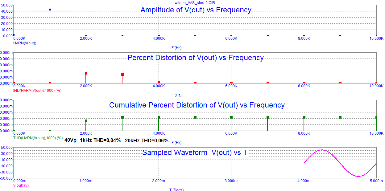

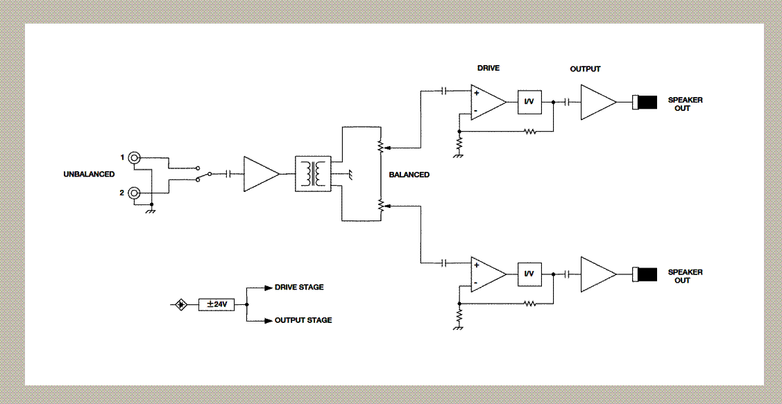

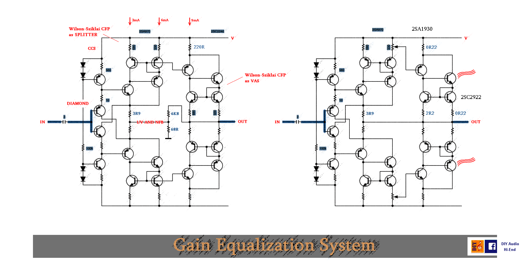

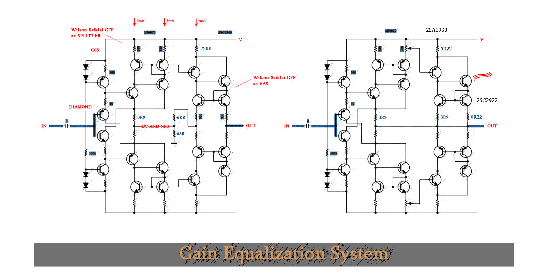

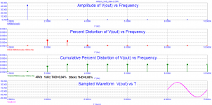

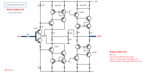

Gain Equalization System
look at this diagram
This architecture allows to obtain
an absolute equal gain (unitary)
between the two branches of the amplifier
much better in balanced mode
