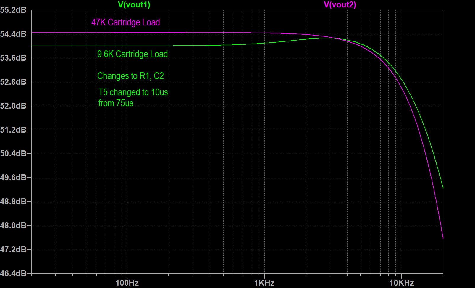

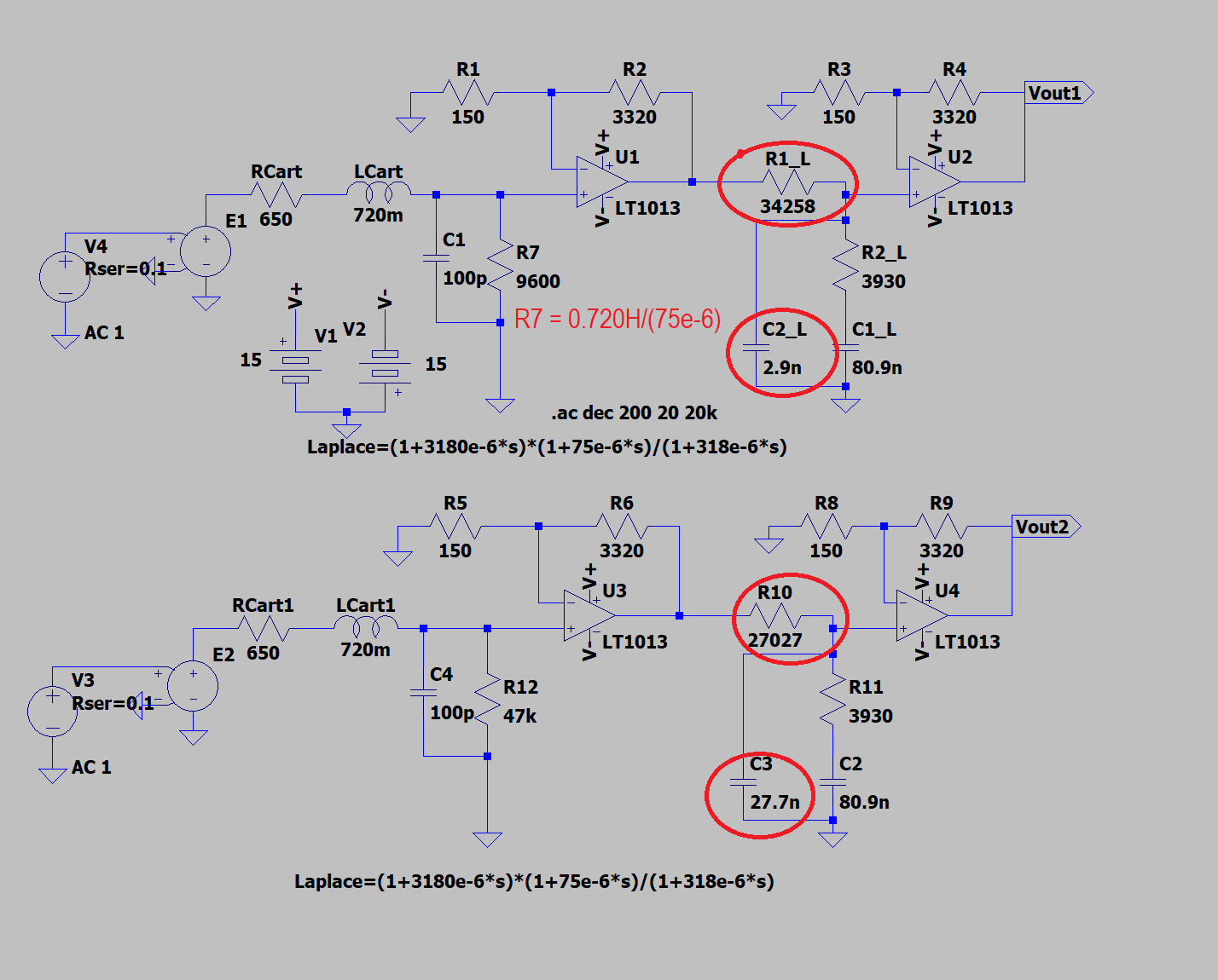

I had to dig out the Lipshitz paper (from 1978) -- as a first swipe I run the simulation with a load resistor of 47k, second swipe change the cartridge load resistor to equal the inductive impedance of the cartridge at 75us, i.e.
0.72 H / 75e-6 seconds = 9,600 Ohms
Change the values of R1 and C2 to effect a much lower T5 value of 10e-6 seconds (since you are compensating by changing the cartridge load resistor.
Hi Wrenchone,
Thanks for your response!
I will give that a try. From what I have read, this makes sense from a noise perspective—slightly more gain in the first stage.
I’m not sure what was wrong when I first put this little phono pre together. Maybe one of the Op Amps was actually damaged after all. Most of my Op Amps get recycled through different projects.
However, now with OPA604 in both input and output, it is sounding strangely good. I did bias the output 604 into class A with a simple resistor, but I don’t think this has much effect on the over all performance. I only did it because OPA604s generally sound a tad hazy to me.
My guess is that whoever originally calculated the filters for the datasheet did a good job. It sounds very “correct.”
