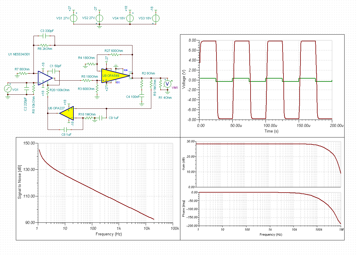

Dear,
There are errors in this schematics.
The + and - from IC1 should be reversed, this way the circuit don't gonna work. Second, I doubt if this going to work well, without any local feedback around the LM1875's. In my simulations it got wrong. I will try if I can make something from it, but I can already tell you, if you want to go nested/composite, there are better ways to do this. Still this schematic is a inspiration 😉
With kind regards,
Bas
I found my NE5534 design.
I build this amplifier many years ago, and as far as I remember I sticked to the values as in this simulation.
The first NE5534 stage is slowed down with cap C1.
The system is DC coupled with a servo injecting into pin 8 of the NE5534. This configuration gives lower noise, and has less influence into the passband then a conventional DC servo configuration.
No matter what people think about the NE5534. In this design it gives a super holographic performance, with a dead silent black background.
With kind regards,
Bas

I found that print off of the net so I'm not sure if it has been changed.
I will keep looking for the original article,I have it some where still,I hope.
