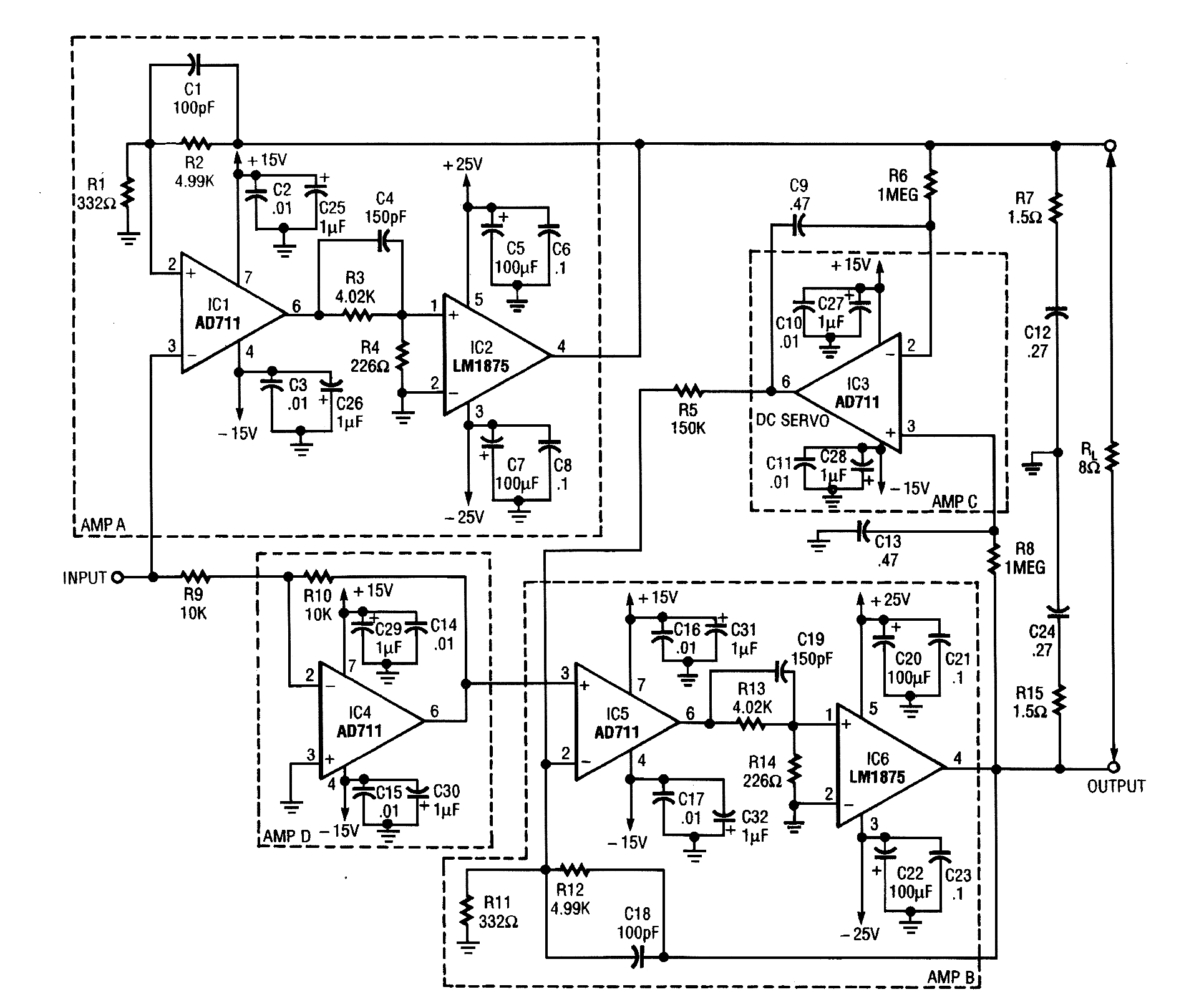

Here is the 33watt version.
I am still looking for the 70watt version.
I remember the paralleled lm1875's for outputs but the inputs each may have been in some sorted nested composite configuration.
I believe there were two articles.
The first one showed this circuit and some single ended ones to descirbe the concept of reducing the higher distortion and noise of the power amp to that of the lower noise and distortion of the driving opamp.
The second article was the BPA 70watt amp itself.
This performance was amazing for the early 90's and for what was reasonable cost at the time.
Nowdays it is even better and cheaper in cost, even, with the higher power output chips and even lower noise and distortion opamps than that of day. jer
