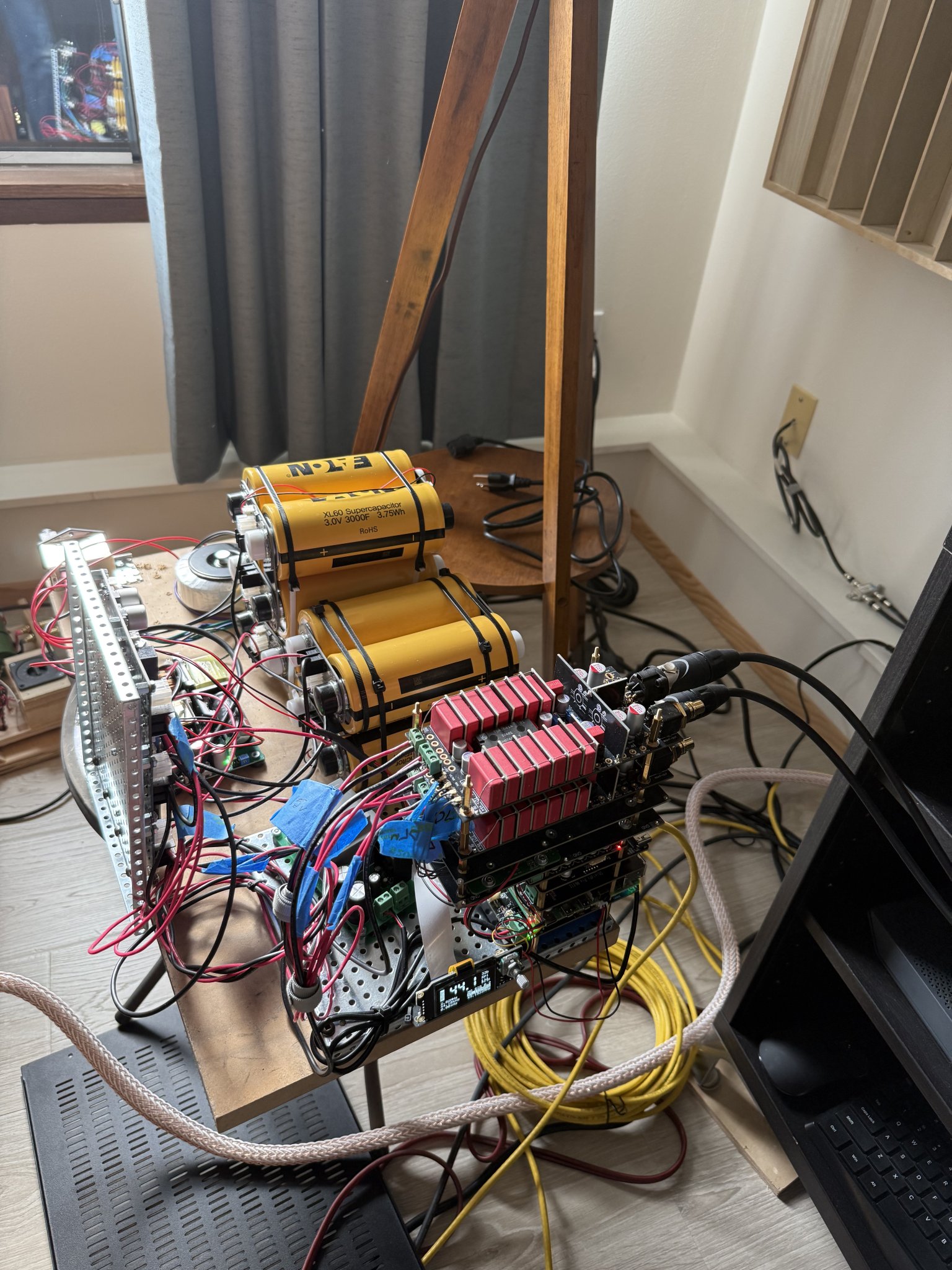

Hi folks, I've been working on this build for a few months on and off. I finished up the initial prototype a couple of weeks ago and I've been running it in since then. I've got about 20-25 hours on it. It's fully balanced with two Gabster board and the full Ian Canada stack. All is fed via the ultracaps and LiPo battery pack for the streamer.
Initial impressions:
  • Holy smokes the noise floor. I didn't think I would notice that as much as I did.
  • Bass is full and well controlled
  • Soundstage is wide and deep.
  • Good sparkle and air in the treble, but not forward like a modern DS can sound. The low noise floor really shows up in this region.
  • As others have said, the vocal region really shines. I found myself coming back to a bunch of vocal jazz tracks, which is not normally my listening pattern.
  • Initially there was some sibilance that stuck out, but that has settled in much more over time. I don't know how much that may have been due to the fact that I was still sorting the 12v supply early on or it was just the caps settling in.
My normal DAC is the modded DirectStream Mk1, which is a lovely DAC and has served me well. It sounds slow and constrained compared to the Gabster, but handles the sibilance region a bit better. The Gabster is also much more muscular in the mid-range and bass region. This is not a shy or laid back DAC. It demands to be heard.
Obviously, I'm still in the honeymoon period and I will probably find more faults as I live with it. Like others, I looked at the active I/V stage and thought it could benefit from a discrete or passive output, but so far I'm pretty happy with these little opamps.
Obviously, next steps are to figure out putting all of this into a tidy package.
