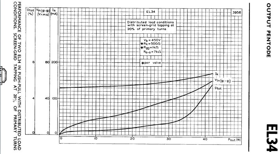

When comparing the 30W numbers to the 0W here, Ik changes 20mA. Is that solely due to G2 current? What is the impact of Rg2 size on total distortion? How about autobias against fixed bias?
The Mullard datasheet that contains the diagram you posted, seems to answer your first question. Ig2 at no signal is 2 x 9 mA. Ig2 at full signal (40 Watt) is also 2 x 9 mA. So probably Ig2 is also 2 x 9 mA at 30 Watt.

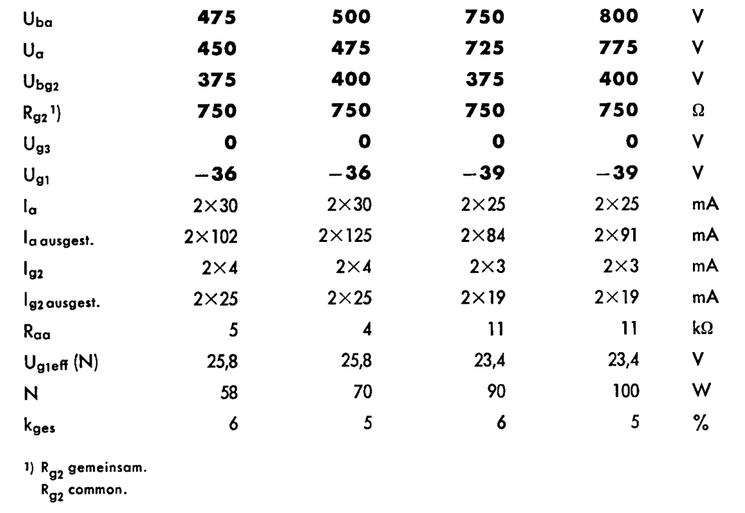

Interesting data from the old masters:
The Telefunken data-sheet for the EL34 has this table under "two tubes push-pull operation".
Now have a look at the right most column for 800V B+

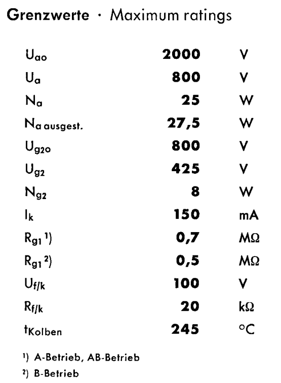

Ig2 with full signal (German: "ausgesteuert") is given as 19mA per tube, average, which gives Pg2 of no less than 14 Watts !
Thats almost 2x the max ratings of 8 Watts on the next page.
If we calculate plate dissipation from that table, we get 71 Watts, almost 3x of the max 27.
It is quite clear that whoever wrote this data-sheet did not have sine testing in mind, but was well aware of the crest factor present in music or pa programme.

Ubg2 = 400 V
Ig2 at full signal per EL34 = 19 mA
So Pg2 at full signal for one EL34 = 0.019 x 400 = 7.6 Watt. So under the limit of 8 Watt.
1st: Pg2 calculates to 400 V * 19 mA = 7.6 watts, what is ok.
2nd: Pa calculates to 800 V * 91 mA - 50 W = 22.8 watts, which also is ok.

Simply add an extra 50V power supply to g2? Regulated if you want so it keeps track with the main psu.My issue comes when trying to use some tubes in SE output stages with local feedback. If the gain of the stage is too low, I need often to operate the tube at higher current for the quiescent point to stay in the middle of the loadline. But for some tubes a higher g2 voltage is needed. Hence the need to violate some datasheet rules.
The peak ig2 hits 100mA or more when the plate pulls down to 50 volts at the top of the sine wave. It only happens over a short period of time - a small fraction of each cycle. When you slam the amp and make it put out square-ish waves you will go over 19mA on average. Still pretty hard to do with music.
I still only get 22W for the max plate dissipation, B+/(2.5*Ra-a), which theoretically does occur around 2/3 power. With a knee voltage between 50 and 100 volts, the dissipation doesn’t drop much at “maximum” power like a solid state amp would. Too much IR drop in the tube, even as a pentode.

Pa calculates to 775V*91mA 50W = 20.5W1st: Pg2 calculates to 400 V * 19 mA = 7.6 watts, what is ok.

In reality, both, Pa and Pg2 at full power out will be lower because
100W is not possible to get with a sensible 800V power supply.
A supply where a center tapped winding feeds the bridge for the anode voltage and Ug2 is taken from the tap.
My take is that the 100W mentioned in the datasheet could only happen in the lab with lab power supplies
Yeah, any real 800 volt supply is going to drop some under load - probably giving you around 700. You could get “better regulation” with a choke input supply, but the fact of the matter is their real regulation factor is quite poor. If your amp is drawing over the critical current, regulation is pretty decent. But at start up you WILL see 1100 volts which is pushing the boundaries of safety on tubes without anode caps. Perhaps for the rest of the wiring as well.

Actually, Pg2 is less than 7.6W beacuse you have voltage drop on common 750ohm resistor for both g2.
750 * 0.038 = 28.5 V
400 - 28.5 = 371.5 V
so:
371.5 V * 0.019 mA = 7.0585 W
No, you don’t calculate the drop in the resistance from the average current. The IR drop is instantaneous (it says non-decoupled g2). The peak currents are way above the 19 mA average. You have to do a bunch on numerical integration on the ig2 curves to get the actual average (or rms) values. Have fun with that. And the drop in the g2 stopper peaks for each tube on alternate half cycles - they don’t really “combine”. When one is up the other is down.
