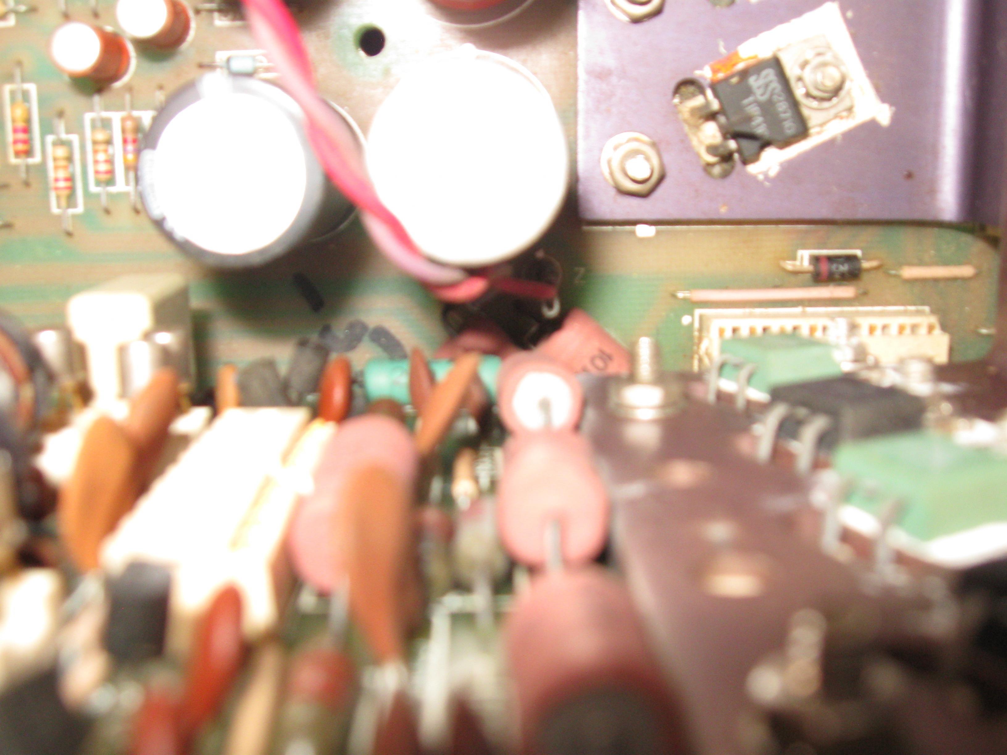

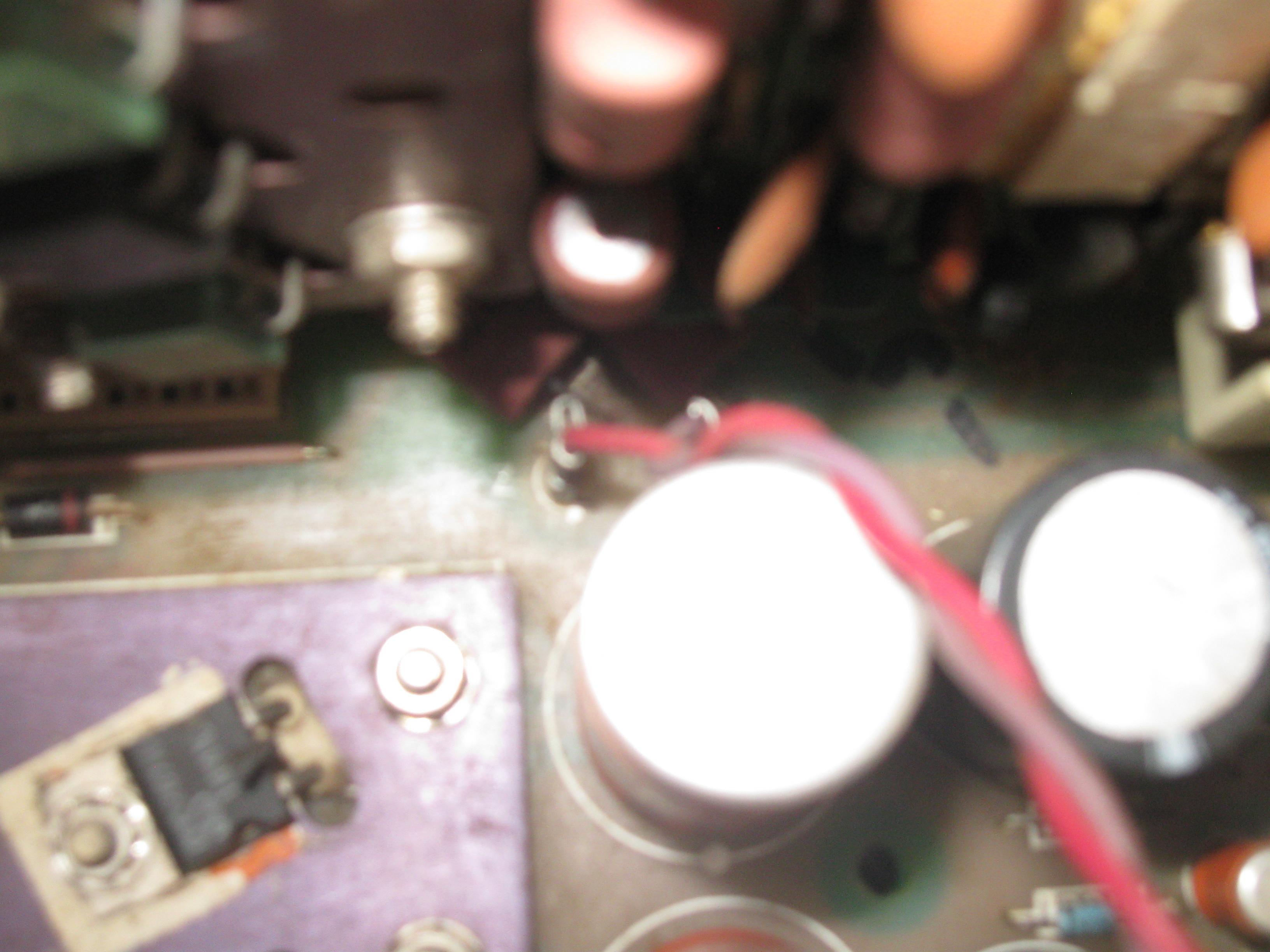

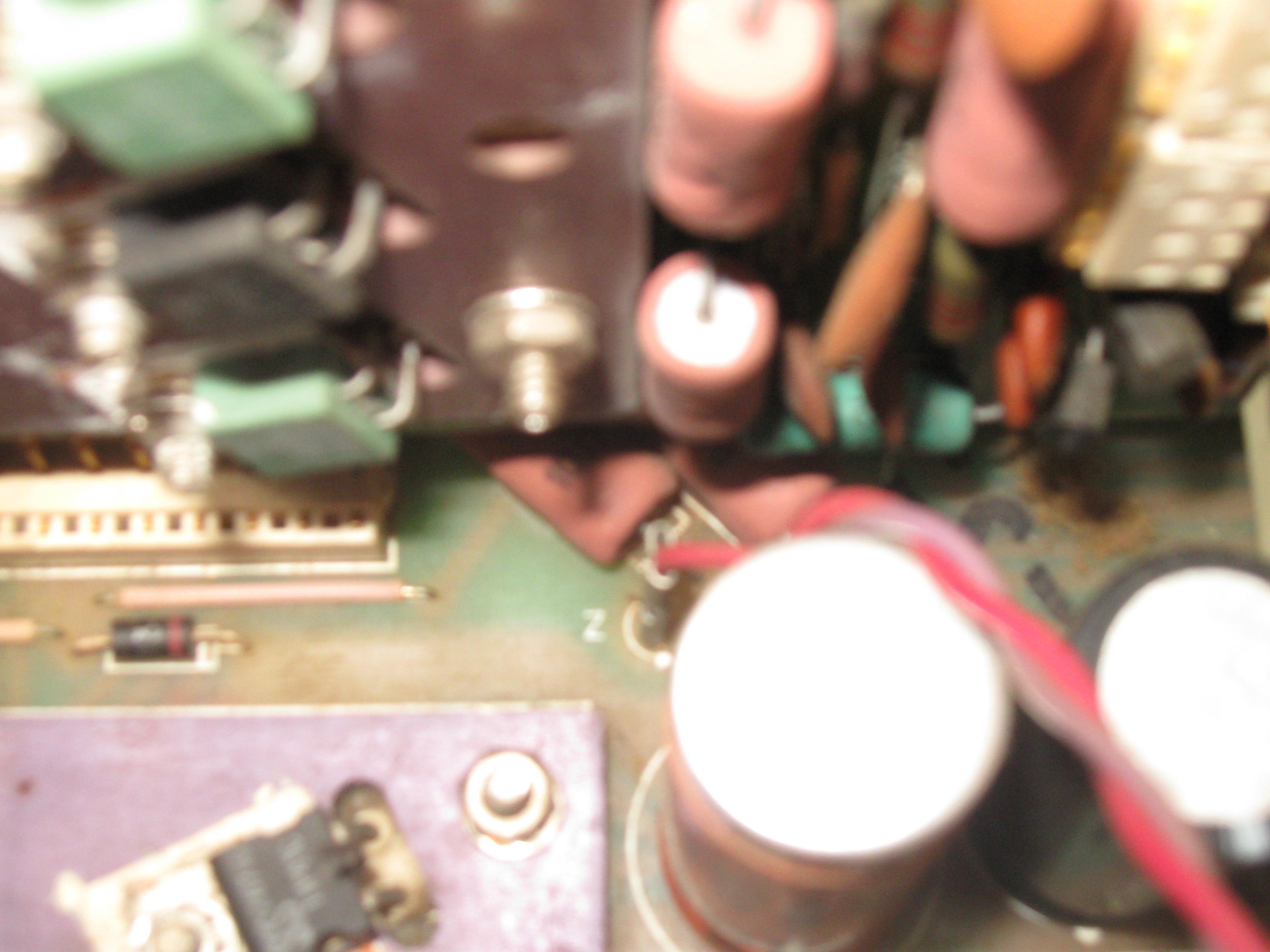

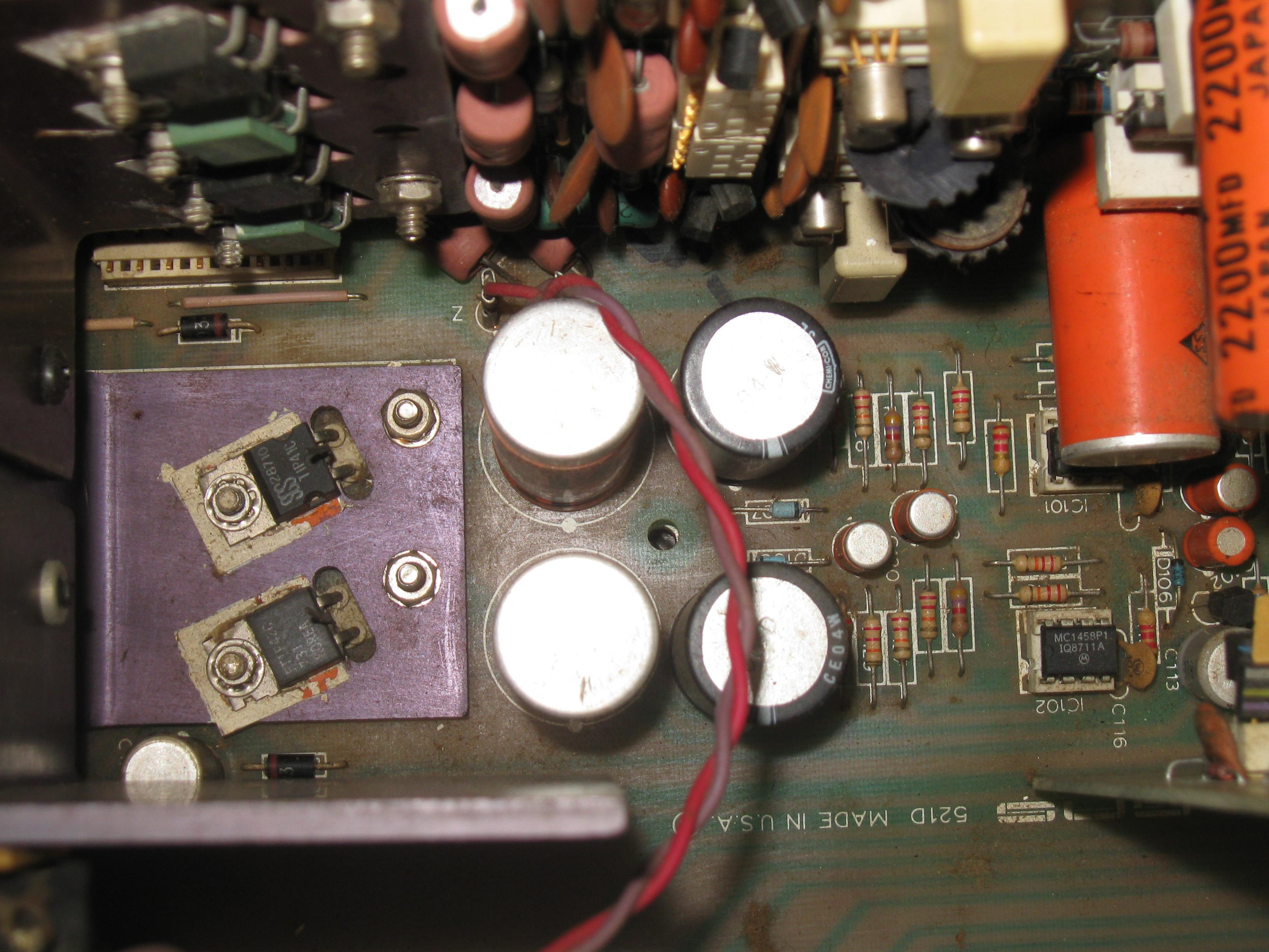

Here are some shots of the inside of the Goliath.
On the Thaedra I head amp there are four 2200uf/6.3v capacitors per channel, I only see two per channel on the Goliath board, probably at the input stage. What is the voltage rating on the two big orange capacitors? If they are 35 volt capacitors they are probably for local decoupling and you're back to +/- 28VDC supplies.
