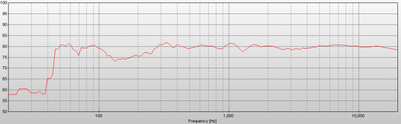

ShinOBIWAN said:Its not a lack of bass at all. Its balanced bass reproduction. The 20hz-80hz is critical for a realistic sounding system but I do agree that low bass can start the room modes off.
What its essential to do in cases where you have dips and peaks in your response is either experiment with positioning or use DRC/EQ.
You can have a tuneful and pacey bass all the way down to 20hz if you calibrate your system and take care to iron out the frequency response.
Yup. Got it in one. Linkwitz, as usual the fount of wisdom, includes a selectable 50 Hz first order highpass in his crossovers so people can compensate for the +6dB/octave tendency of room gain below about 50 Hz. In many situations using this properly changes bass from thick-sounding to balanced.
Note that Wilson speakers use a Bessel alignment in their vented systems, which rolls off a bit earlier and slower than the standard Butterworth alignment, at close to 6 dB/octave for an octave around the box tuning, and they've gotten good reviews for fast, accurate bass.
"Slow" bass can also come from room modes (different from gain), because a resonant system will take some time to develop full amplitude. For example, if a room has concrete floor and a concrete ceiling eight feet high, then it will tend to develop a floor-to-ceiling resonance around 70 Hz [1]. If there is little furniture and no carpet, the Q could be as high as 10, which means the resonance won't level out until after about a quarter-second of steady-state tone. It'll also take that much time to decay away, too, and that overhang is perceived as sluggish bass. Sorting out this kind of problem goes a long way to making bass sound "fast".
[1] Node at the ceiling and another at the floor yields a half-wavelength of 8 feet. Multiplying by 2 gives a full wavelength of 16 feet, which with the speed of sound at 1125 feet/second comes it at 70 Hz.
