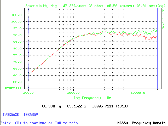

Today it just hapenned I had the opporunity to do a direct comparison between Audax A20 and Fountek JP3. Both measuring and listening in the same 3 way speaker with 2 PHL midbasses and PHL mid. We are developing a really nice 3 way during last month with a friend. We had the heads with the A20 and he built the mid-high heads again with JP3 and crossed it. So we had both to exchange as tweeters in two pairs of mid-high 'heads'. The crosspoints are 2800 3rd with dome, 3800 3rd with ribbon. Good thing is that JP3 is short so no big lack of vertical dispersion. Comparable loss in farfield, checked with RTA and MLS. Almost same power response. The IMD of the speaker was better by 1% between 4 and 10K with the ribbon. Dome head gave 2% when ribbon head gave 1%. 4 to 10k is where the treble is in music, next octave is brilliance or 'air'.
Subjectively we could here all piano notes distinctivly with right dynamics and presence with the ribbon. In comparison the dome gave a blured synthetic rendition. Less air too. Especially when a trillia was played (a caprice of piano high keys) the dome lost it all together. No musical sense. The ribbon passed with flying colors. One constant feeling was that the dome was there doing something, making it self present when no high notes were present. Psss, hsss, crrrr etc. The ribbon just came in, played its triangles in Mahler's 2nd and moved out like a distinct gentleman.
All in all I think that there must be a different way of testing the ribbons vs domes rightly. Because both measured IMD and subjective distortion was obviously lower in a directly comparable system under controled conditions. Mind you that Audax A20 is among the best domes ever. All the above are my honest findings in total unison with my friend's, both ecxellent engineer and a highly regarded pianist in his short musical career.

This is what a distinct French designer wrote to Audax for A20 since almost none of you may have come across this tweeter. A20 and A26 remain the obscure last word of Audax in the era just before Harman shut them off to the diy world:
''I´m sorry that you get my feedback on your marvellous dome
tweeter that late. I had simply forgotten about it. Please find
the curves in the appendix.
In my mind this metal dome tweeter is one of the very best
available -- soundwise and measuringwise. Mechanically its´
maximum undistorted SPL at 2 kHz is 112 dB / 1m which is
about one acoustic watt. Not many dome tweeters can play
that loud. I mention this because my way of measuring at
extreme levels is kind of unsual (with tonebursts, otherwise
the voice coil would burn out).''
