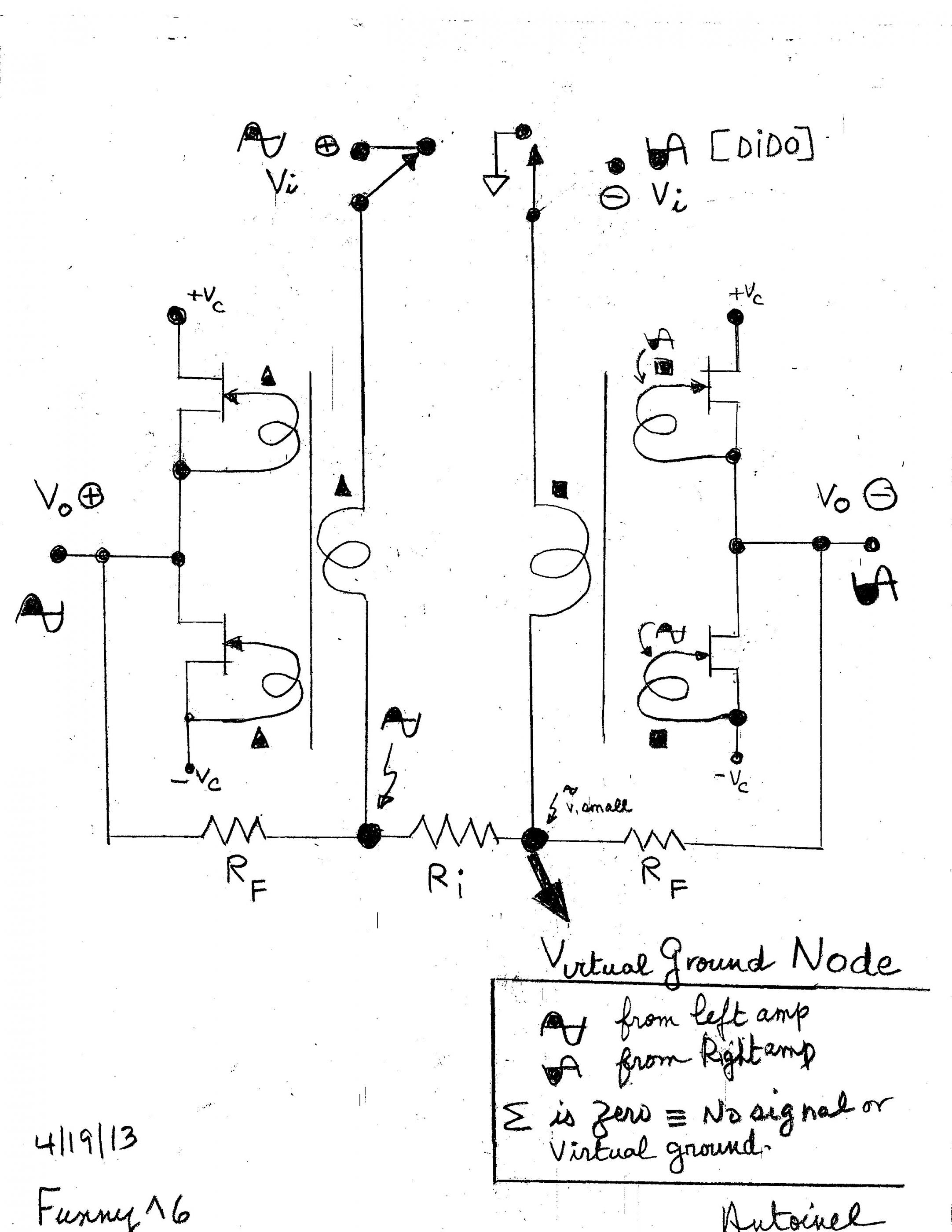

The following hopes to add detail to Zen Mod's above post. The attached picture is a schematic of Funny^6. Its inputs are driven by either differential signals or with one signal to the Left amp and none to the Right amp [depicted] . Either way the power output signals of Funny^6 have equal amplitudes and are 180 degrees out phase with each other.
Suppose that the the power output signal of the left amp is spurious distortion; meaning it has amplitude and some absolute phase. The left amp infects the right amp with distortion at the summing junction. The right amp then counters by generating an equal amplitude and an out-of- phase signal to null this infection; or it creates the shown virtual ground node. Thus, the power output distortion signal of the right amp has to be equal in amplitude and 180 degrees out of phase with the left amp. Connect a loudspeaker between the two power outputs and the differential distortion signal passes right through loud and clear.
I fully agree with the Zen Mod's post; except for this critical point. Funny ^6 lacks the ability to null distortion and instead augments it. This is a good side effect since Pass amps thrive on some level of agreeable distortion.

Zen Mod. The following excerpt from US 5,376,899 discusses Figure 7 [in it] which is Funny ^6.
FIG. 7 shows two gain stages 14 and 15 coupled together by a resistor 16 across their respective negative feedback terminals. The amplifier accepts both balanced and unbalanced inputs and produces a balanced output. It does not reject the common mode signal, but neither does it amplify it. The distortion and noise contributions of both amplifiers will show in both outputs with opposite polarity so that they will not be removed differentially at the load.

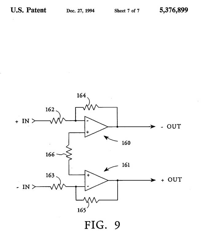

are you sure that F6 is not having feedback operation as inverting OP cell , so Funny^6 is more likely as Fig.9 in same patent ?
as I wrote somewhere - portion of output signal is opposed directly to input signal , not on some other signal node in amp .....
F6 is a non-inverting amp = OP cells 14 and 15 in Figure 7. Fig 7 fits better Funny^6 than Fig 9. In Fig 7,
  • ground the -IN input on OP 15
  • input signal a +IN of OP 14.
  • OP 14 is non inverting amp.
  • The fed back signal from OP 14 to its inverting port is now the input signal to the inverting port of OP 15; which is a virtual ground.
  • The phase of the out signal from OP 14 is + and the phase of the out signal from OP 15 is -. We have augmentation and not cancellation of power outputs from a single input signal [SIDO] which is identical to a DIDO.
Let's look forward to buzzforb's results.
after first evening coffee , I think you're having right with that ;
Funny^6 isn't SUSY , so it's not having diff. error correction ( or the other way around :rofl: )
however - 5 coil Babelfish F6 Bal , or 6 coil one ....... or even vulgar 4 coil version is SUSY ;

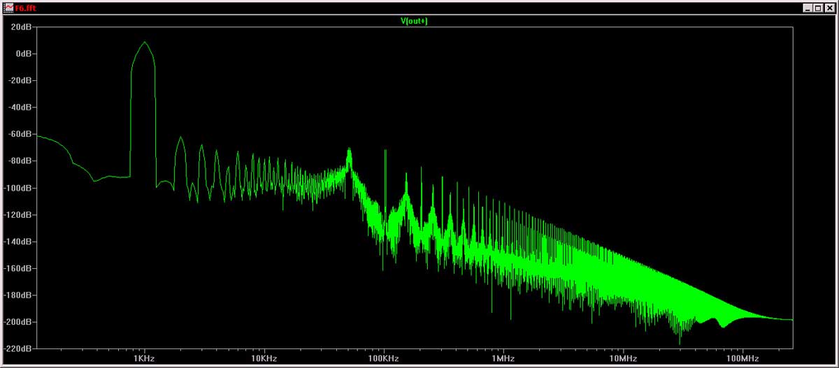

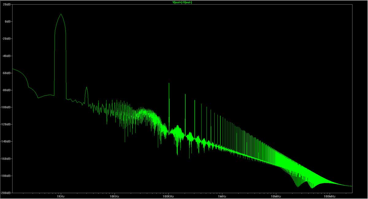

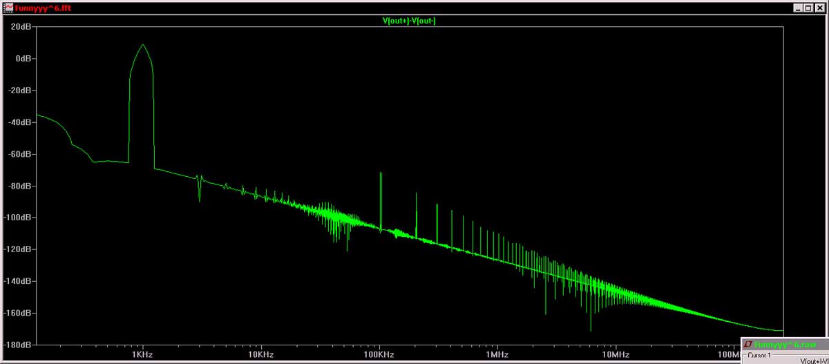

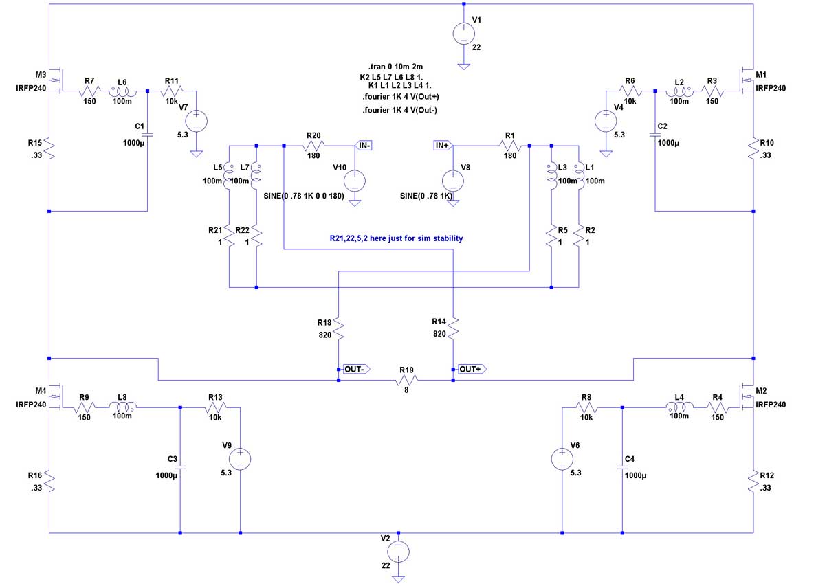

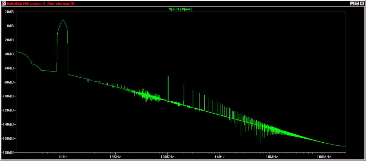

some FFTs from already seen principal sims ; outputs IRFP240 (convenience) ; ideal xformers used ( no losses) ; read pic titles if not visible in pic
sort of informative
all of them @1W/8R
