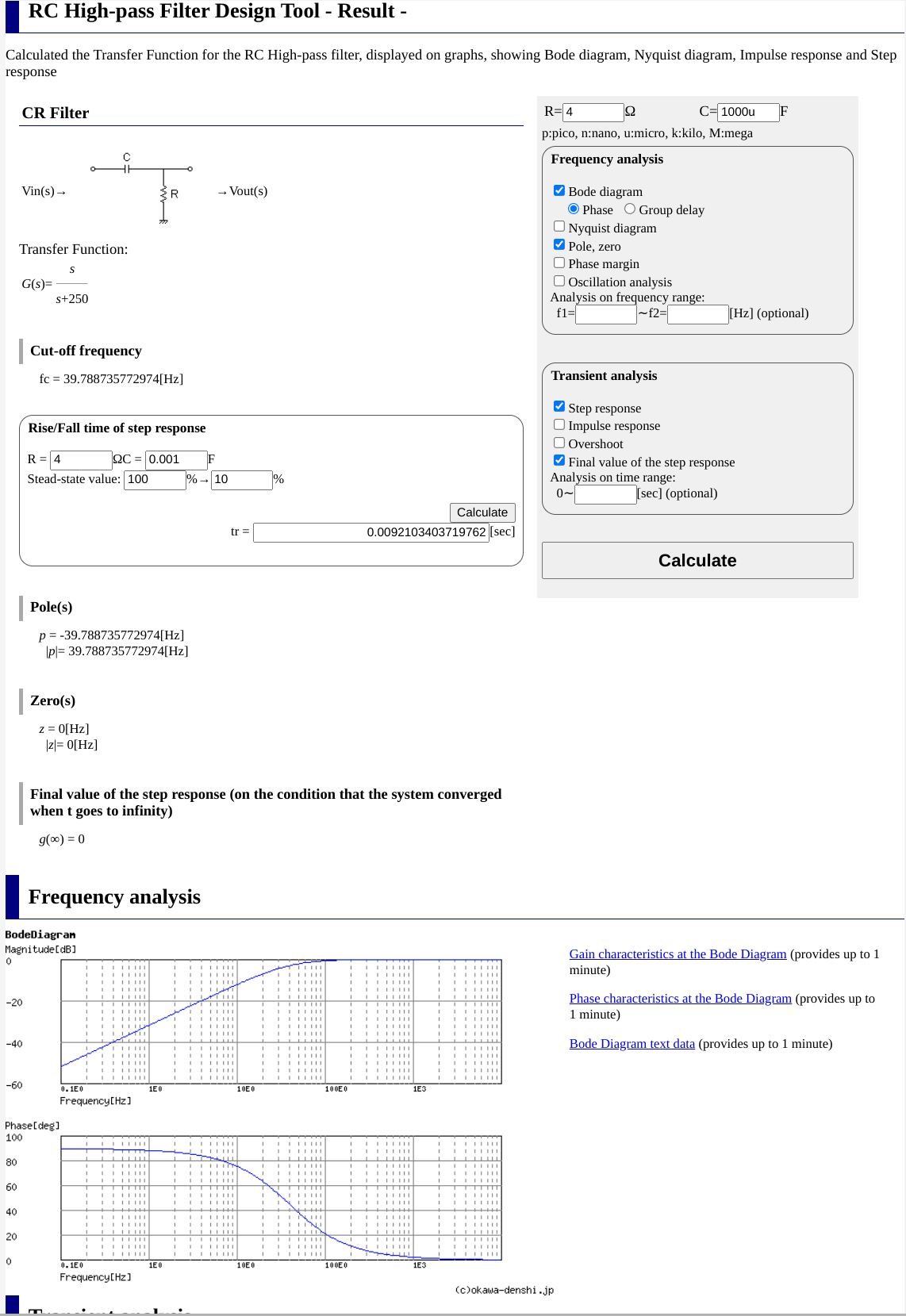

1000uF speaker output caps? How many ohms are the speakers?
I used 10000uF on mine but I assume 8R load as worst case and I want flat from 25Hz upwards.
With 10000uF and 4R load, it starts rolling off at 39Hz. With 1000uF/4R it would start around 390Hz!
It's mainly used with 8 ohm speakers.1000uF speaker output caps? How many ohms are the speakers?
I used 10000uF on mine but I assume 4R load as worst case and I want flat from 25Hz upwards.
Putting rediculously high caps in there isn't sensible, unless your're a "DIY Fanatic".
Even with 10000uF and 4R it starts to roll off at 39Hz...
With 1000uF/8R, it starts to roll off at 190Hz so either you boost the bass or you don't care for it/have a subwoofer?
Even a cheap Radio Shack stereo from the 1980's used 4700uF for the outputs IIRC 🙂

According to my calculator of choice: http://sim.okawa-denshi.jp/en/CRhikeisan.htm
The pole frequency is 39Hz, not 3.9Hz. 5x 39=195. I said about 190Hz. This plot looks more like ~120Hz.
What an I missing here?
0.159/(.01x4) = 3.975 No matter how many times I enter the numbers into the calculator.
10,000 uF is .01 farads.
He's using 1000uF The sim shows 1000uF, not 10,000uF...0.159/(.01x4) = 3.975 No matter how many times I enter the numbers into the calculator.
0.159/(0.001x4) = 39.75 no matter how many times I enter the numbers into the calculator 😀
I'm the one using 10,000uF for outputs 🙂
The RC filter formula fc=1/2piRC is for the -3dB point, so with the values given (1000uF, 4Ohm...) it's ~39Hz where the output is down -3dB.
Also, woofers have at some f point a resonance (bassreflex may have two resonance peaks) where the impedance goes up considerably which will not load down the C, so if the resonance is at or below the fc, the output swings back up before it goes down but at much steeper rate.
2200uF would bring -3dB down to ~18Hz a good enough compromise which is below most average joe speakers lowest f resonance (edit: assuming 4Ohms..).
