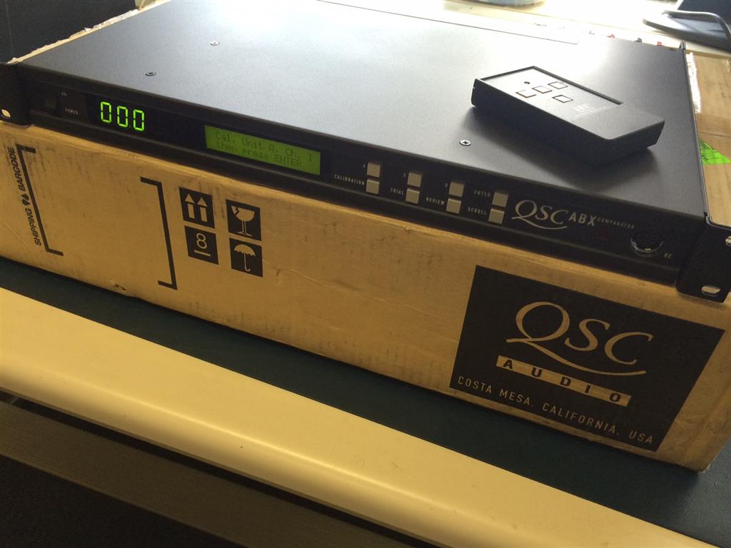

QSC used to manufacture this ABX test box -
QSC ABX_manual.pdf

Those specs are very not flash....I was being polite, they are hopeless.
QSC ABX_manual.pdf

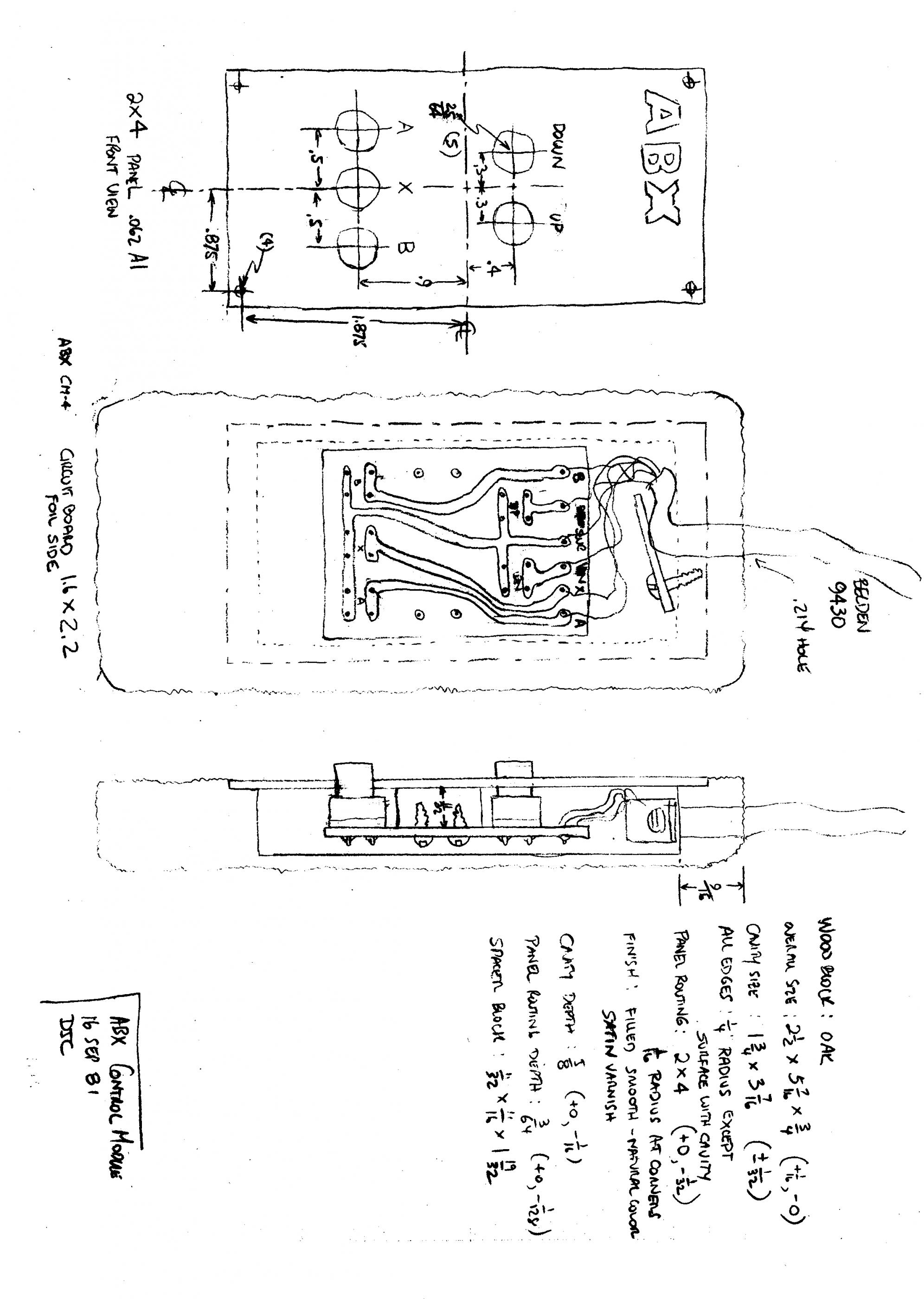

We had nothing to do with the design or construction of any ABX gear but our own. The QSC box is rated very conservatively. I have one on hand - it works far better than you might want to think.

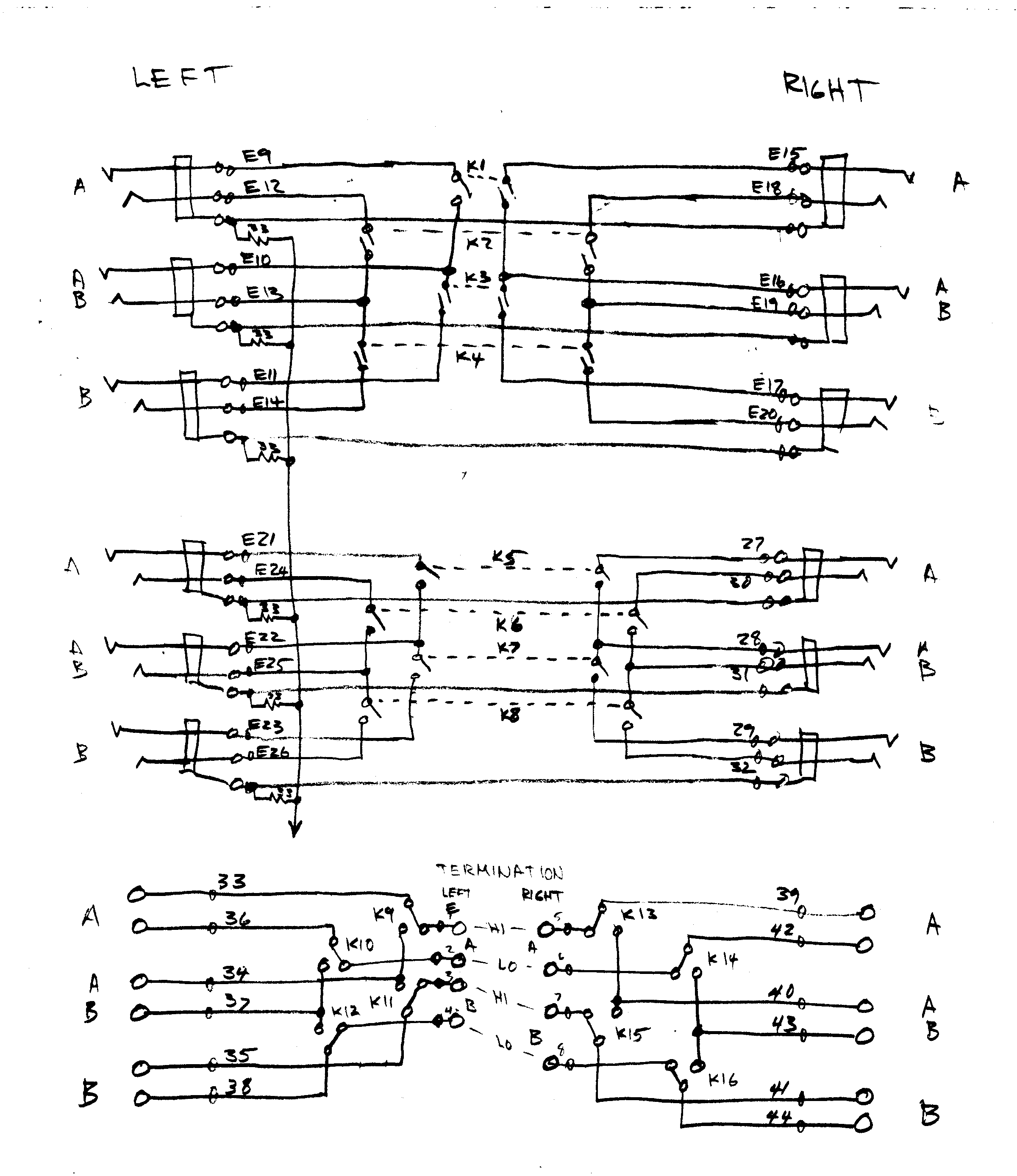

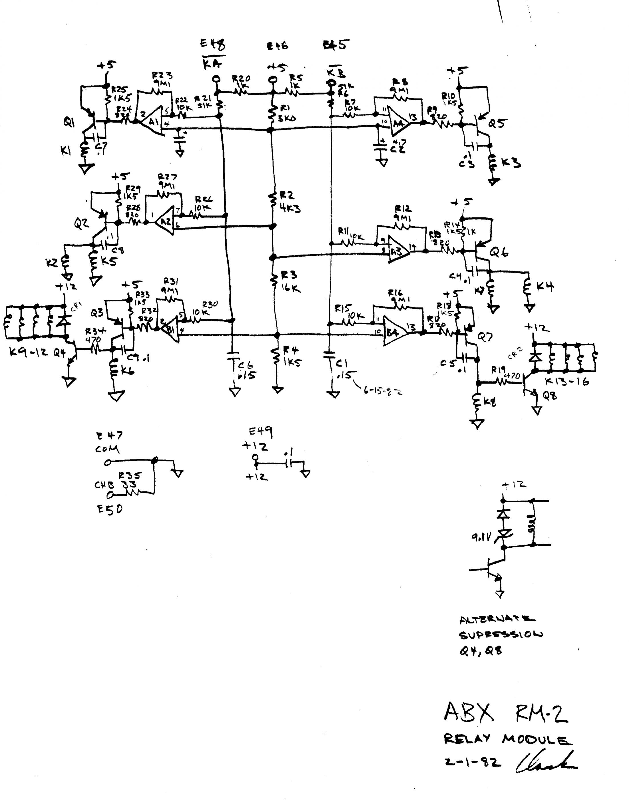

Here are the schematics of the components of our ABX Box:
Relay driver circuits:
Relay contact wiring

Logic and control unit schematic
Line level is my concern.We had nothing to do with the design or construction of any ABX gear but our own. The QSC box is rated very conservatively. I have one on hand - it works far better than you might want to think.
Why 33R earthing resistors, and where is the level matching ?.Here are the schematics of the components of our ABX Box:......
Dan.
Our goal for our switching equipment was audibly silent and transient-free switching, even when comparing phono and mic preamps. If you can do that, line level is a slam dunk.
You don't know?
Common practice for balanced circuits. Reduces the probability of hum and noise in some situations.
and where is the level matching?.
Hopefully in the UUT's.
If not, added on by appropriate means which can vary all over the map depending on what kind of UUT's are involved.
Yeah ok, correct switching to eliminate switching transient noise.Our goal for our switching equipment was audibly silent and transient-free switching, even when comparing phono and mic preamps. If you can do that, line level is a slam dunk.
Layouts and loop areas are quite critical.
Ok, I missed balanced connection.You don't know?
Still, all connections including earths must be switched to eliminate earth current cross pollution of audio signals, more especially when running unbalanced.
Yeah, ok, so what really is "appropriate means which can vary over the map" ?.Hopefully in the UUT's.
Adding attenuators of undefined characteristic and causing common earths is changing the equation by adding extra variables that deviate the DUT's from their original usage conditions.
Dan.
Not true. Like I said, we achieved audibly transient free switching of both phono cartridges and microphones.
Why should one accept such hyper-generalties from someone who doesn't recognize wihtout being told several times what are clearly schematics for balanced circuits?
It means understanding that the appropriate means for audio attenuation varies with the circumstance. That's not a run-around, it is simple truth.
I'm not here to teach a class in grounding or signal switching - there is a ton that is now published about it if you know where to look. Unfortunately it was mostly published after 1983, which means that back in the day many people had to work it out for themselves.
That's what I've been trying to convey!
Of course our attenuators and other matching devices de jour were not undefined, and had passed relevant performance tests of both a technical and subjective nature.
Being credentialed (mostly degreed) and experienced audio engineers we knew that we would have to address that issue. We used generally accepted technical practice, plus whatever we had to invent, to monitor performance and implement solutions that avoided that problem.
For example, the schematics I just published implement a novel (never ever seen it described any place else) highly reliable means for transient-free audio switching that is also described in the AES paper. Only took me about a year and a few generations of prototypes to figure it out. ;-) If you know what it is, it is common sense - stupid dumb.
