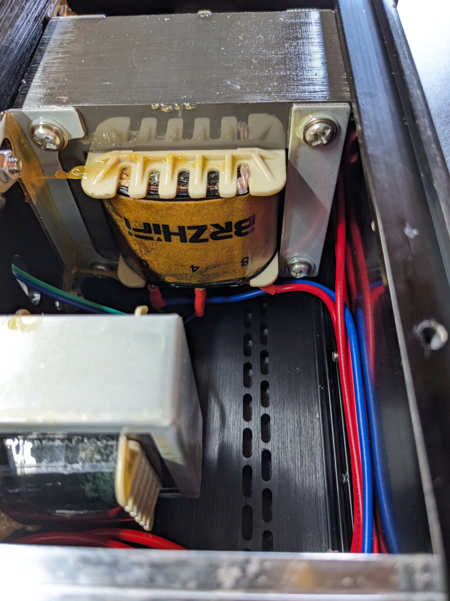

I'd also love to hear what someone with an oscilloscope, signal generator and some knowledge thinks! The output transformers are certainly on the small side and an obvious place for the manufacturer to save some money. As far as I know, really good OTs cost more than I paid for these amps. I only have JJ 300Bs installed so there's a lot of room for improvement and cost there. If the circuit is correctly configured and is operating the tubes properly it may be worth the investment.

I was just reading about Audio Note OTs and came across this line describing their lowest cost line:
"The main cost saving being the use of a smaller core, specified to the exact power level required, rather than overspecifying by 50 or 100%"
This point has made me realize that the size of the core has more to do with power handling than bandwidth, and especially at the very moderate levels I tend to listen with my LaScalas, the stock transformers might be up to the task. That would mean that my money would be better spent on better tubes.

A smaller core, all else equal, means less winding resistance (which is not only a loss issue, but also a distortion issue, because eddy current and hysteresis losses appear across that resistance, and they're very non-linear) and generally less leakage inductance. And maybe slightly less stray capacitances, maybe not. There's no such critter as an Ideal Transformer, only best choices for well specified situations.
Above about a kiloHertz the core is almost unimportant, but at very low frequencies it's pretty much the most important part of a transformer, and there size does matter. What other machine do we expect to operate well over a speed range of 1000 to one? OPTs are a tough gig.
OPT power handling at low frequencies is a second order function inverse of frequency, so every octave lower at any particular power level is four times harder to do. Quadratic limitations are a B; just look at speakers (where everything is second order).

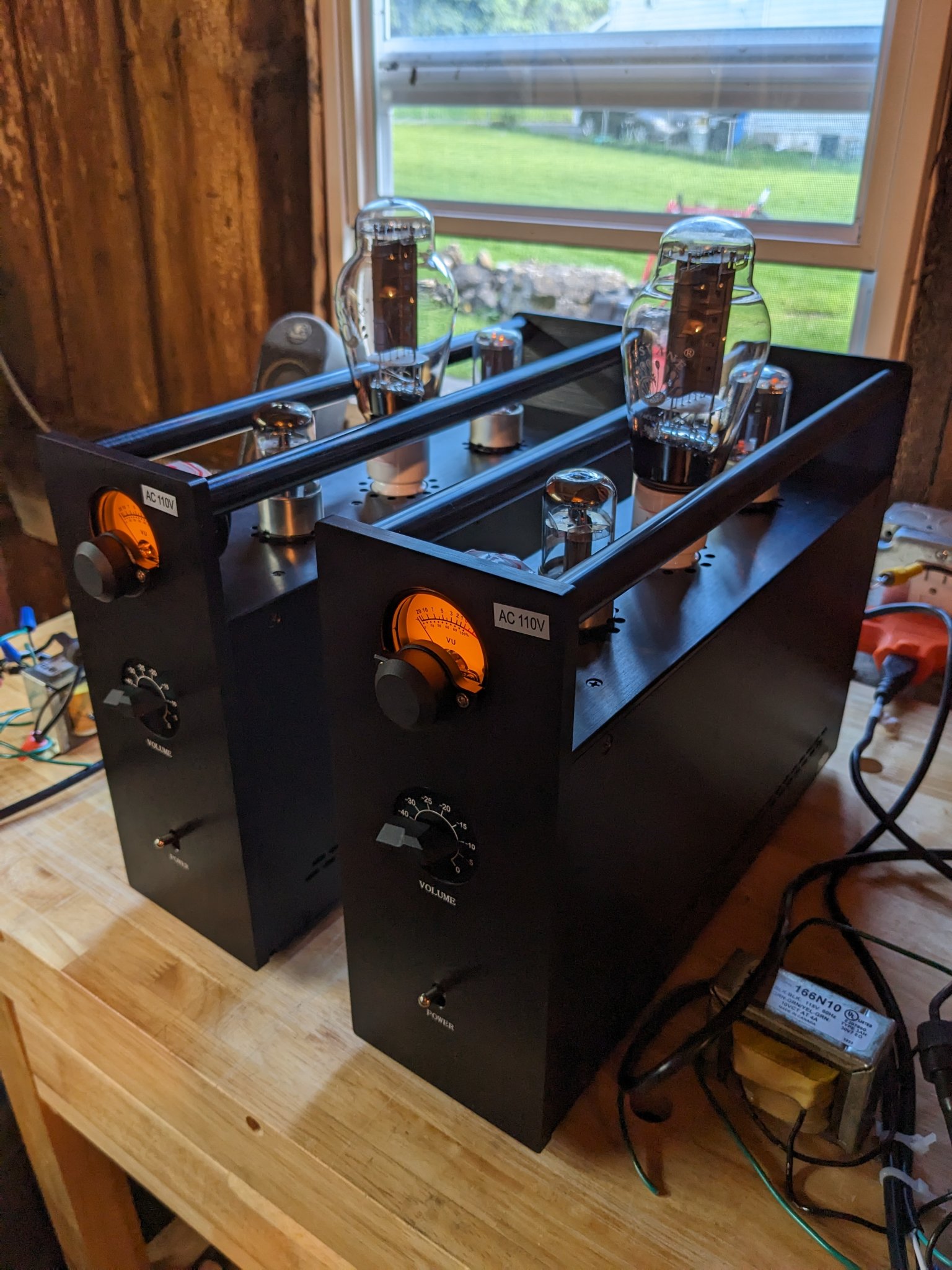

I forgot to ask what voltage you are going to feed these amps? Mine are marked 110vac so I'm using bucking transformers. My 124ish line voltage is higher than I'm comfortable with.I will report back as to how they sound

I wonder if the next step would be better output transformers. I haven't measured the stock ones yet but I intend to. I really wish that someone with some skill and test equipment would take a look at these things. I MOSTLY trust my ears, but....

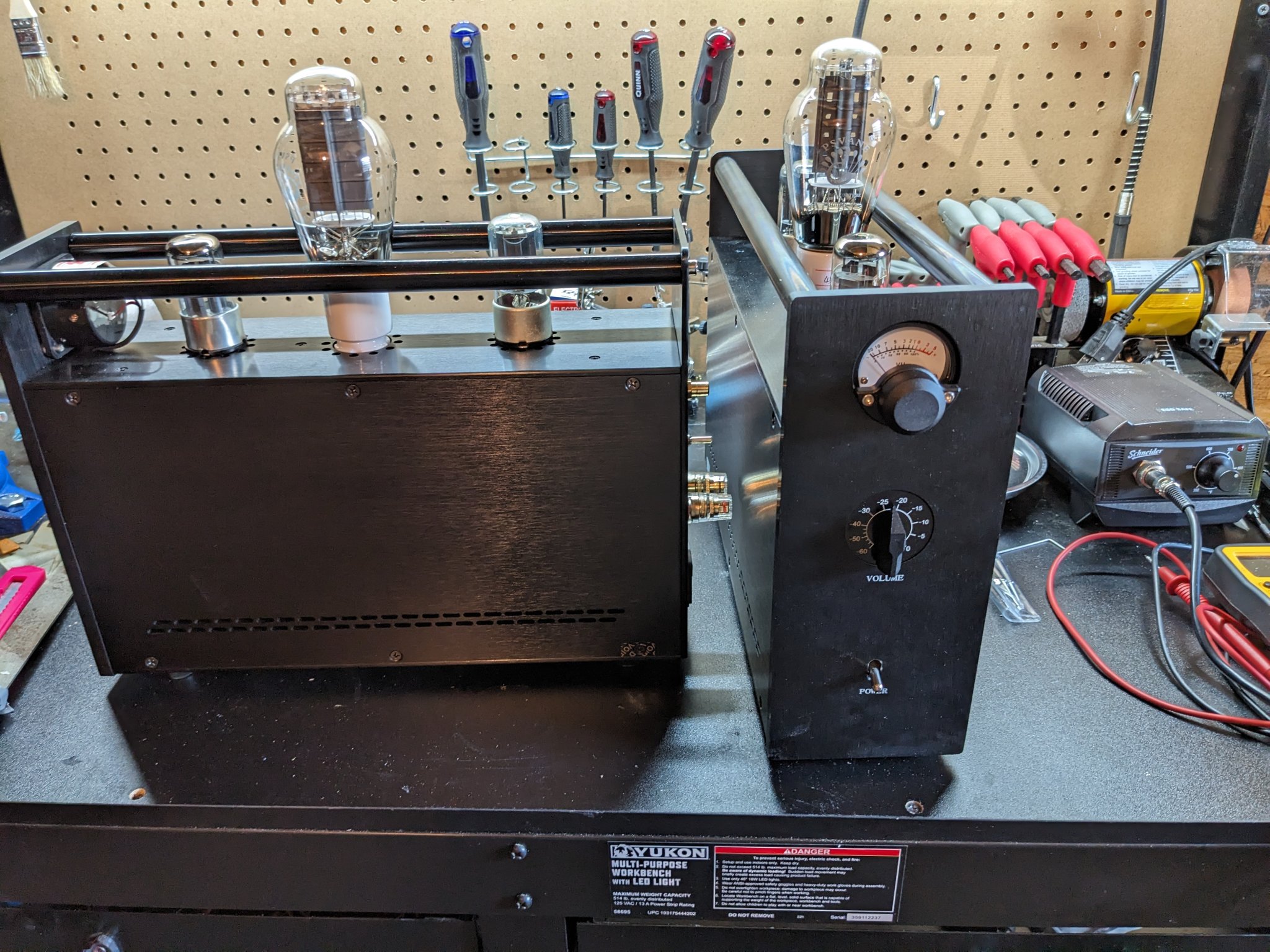

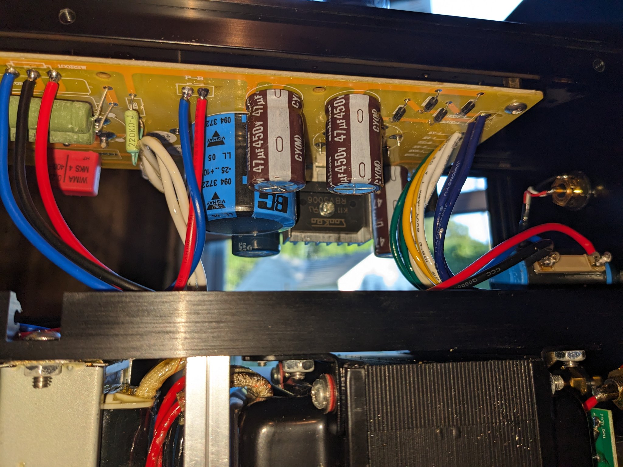

Hi Pete,Hi everyone!
I just got a pair of Chinese 300b Monoblocks from eBay and have some questions and comments, and wonder if anyone who knows what they are doing has looked at them.
The amps that I got are sold by a bunch of different people but they all look the same. There is very little actual identifying labeling, the vendor that I chose has a funKenya banner on the pictures.
I got the version that came with PSVane 300bs and Russian rectifier and driver tubes. It only took two weeks to get to Pennsylvania from Hong Kong! It was very well packaged and the packaging and contents were undamaged.

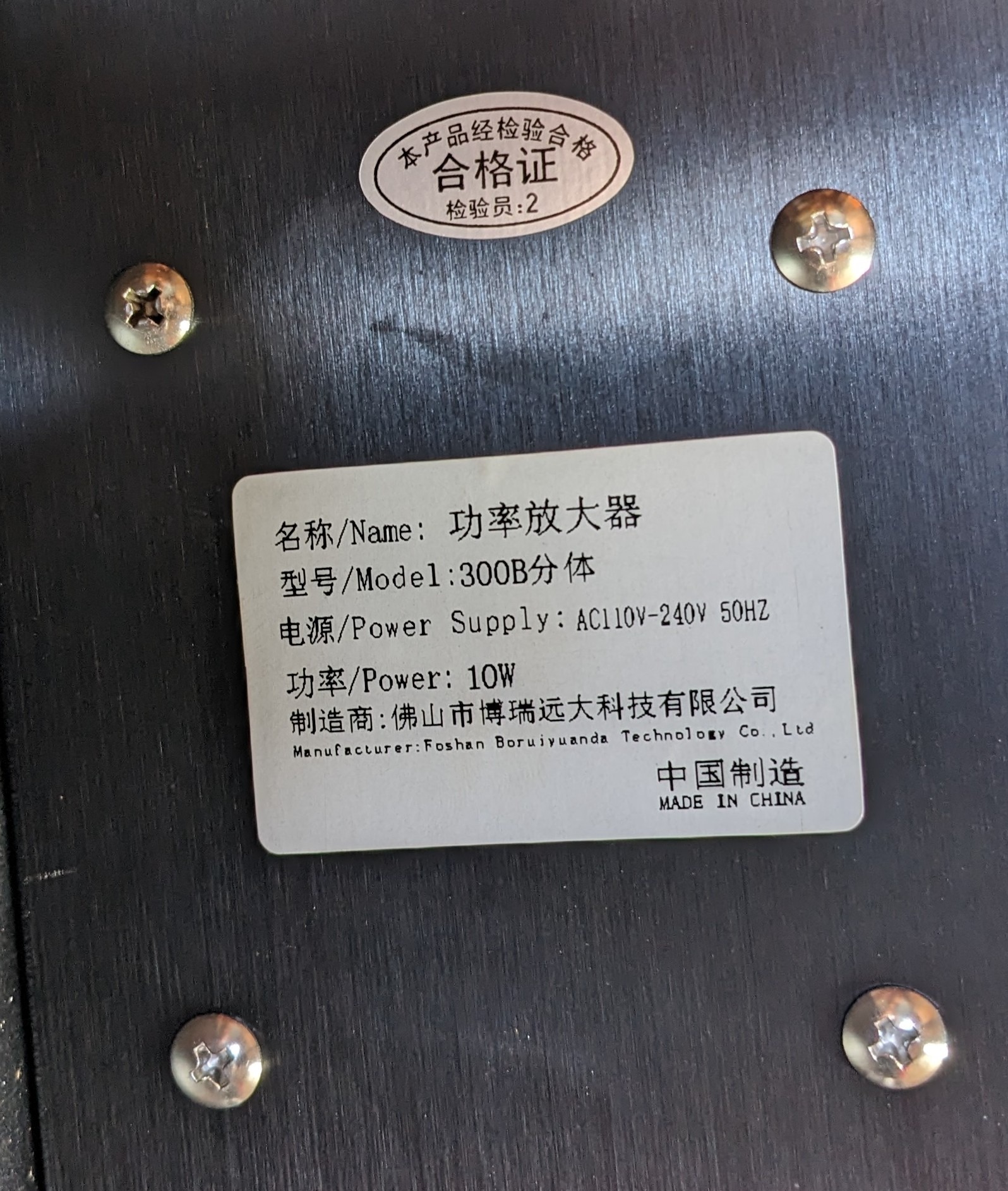

There was no manual of any sort included, but I don't read Chinese so that isn't a great loss. The case has no identifying markings at all but there is a sticker on the bottom.

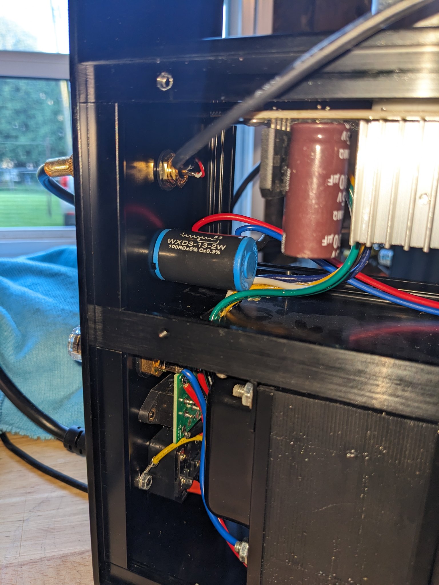

The first thing that I did was peal off the warranty stickers over two of the screws holding the side panels so that I could verify which socket is for the driver and which one gets the rectifier. The case is labeled 110 volts in several places so I checked the heater voltage for the 300b and it was almost 6 volts. I built power cords with 10 volt bucking transformers and reduced my line voltage from 123v to 110v and the heater voltage to 5 volts.
I tested them out on the workbench with small speakers and they appeared to be operating properly, so I brought them upstairs and hooked them up to the big system.
Right off the bat they sounded pretty darn good. Not really competitive with my big VTL monoblocks, but they had something to offer over the Skunkie Designs modified A12 that I had hooked up yesterday. After a couple of hours, they really started to sound pretty darn good!
I brought them downstairs and put them back on the bench with the small speakers out of phase and pushed up against each other, and the Sheffield Labs burn-in track running on repeat. I'm going to hook them back up shortly, after 4 hours or so.

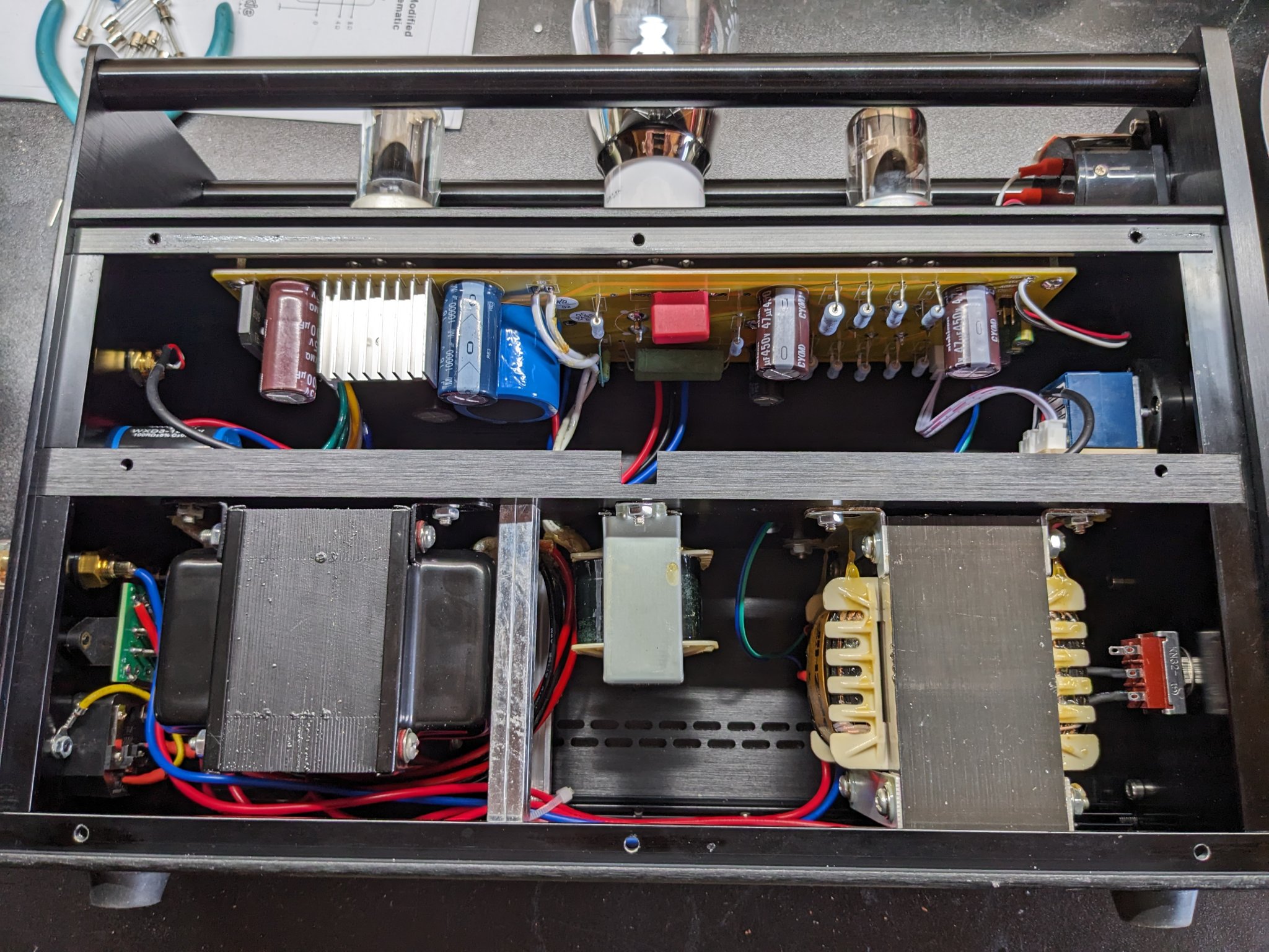

My questions:
Has anyone who knows what they are doing looked at these things? They seem more "engineered" than the A12 but I still wonder if the circuit is actually properly designed and implemented.
I would love to get rid of the Russian tubes and use more common types. It comes with a 5U4M rectifier and obviously a 5AR4 would give me more choice and availability, similarly with the 6H8C driver tube, a 6SN7 is a lot easier to come by. I'm pretty sure that I can't just use the "equivalent" tube types, lol.
There is a multi-turn potentiometer on the back but no exposed test point that I can find. Does it seem possible that this amp is configured with adjustable bias? That raises several other questions.
I'm about ready to bite the bullet and order some better 300b's for it but if I can do something about the others while I'm at it that would be great.

PeteView attachment 1203684View attachment 1203685View attachment 1203686View attachment 1203687View attachment 1203688View attachment 1203689View attachment 1203690View attachment 1203691View attachment 1203692

I use a variac to lower the input voltage and have no problems.
Quite good circuit is same as Sun audio circuit and triode.com audio amplifier 's circuit.
This circuit uses a diode bridge, which is very common these days. The rectifier tube is not used as a rectifier tube, it is just used as a damper for the voltage drop of about 60V. The rectifier tube is not used as a rectifier tube.

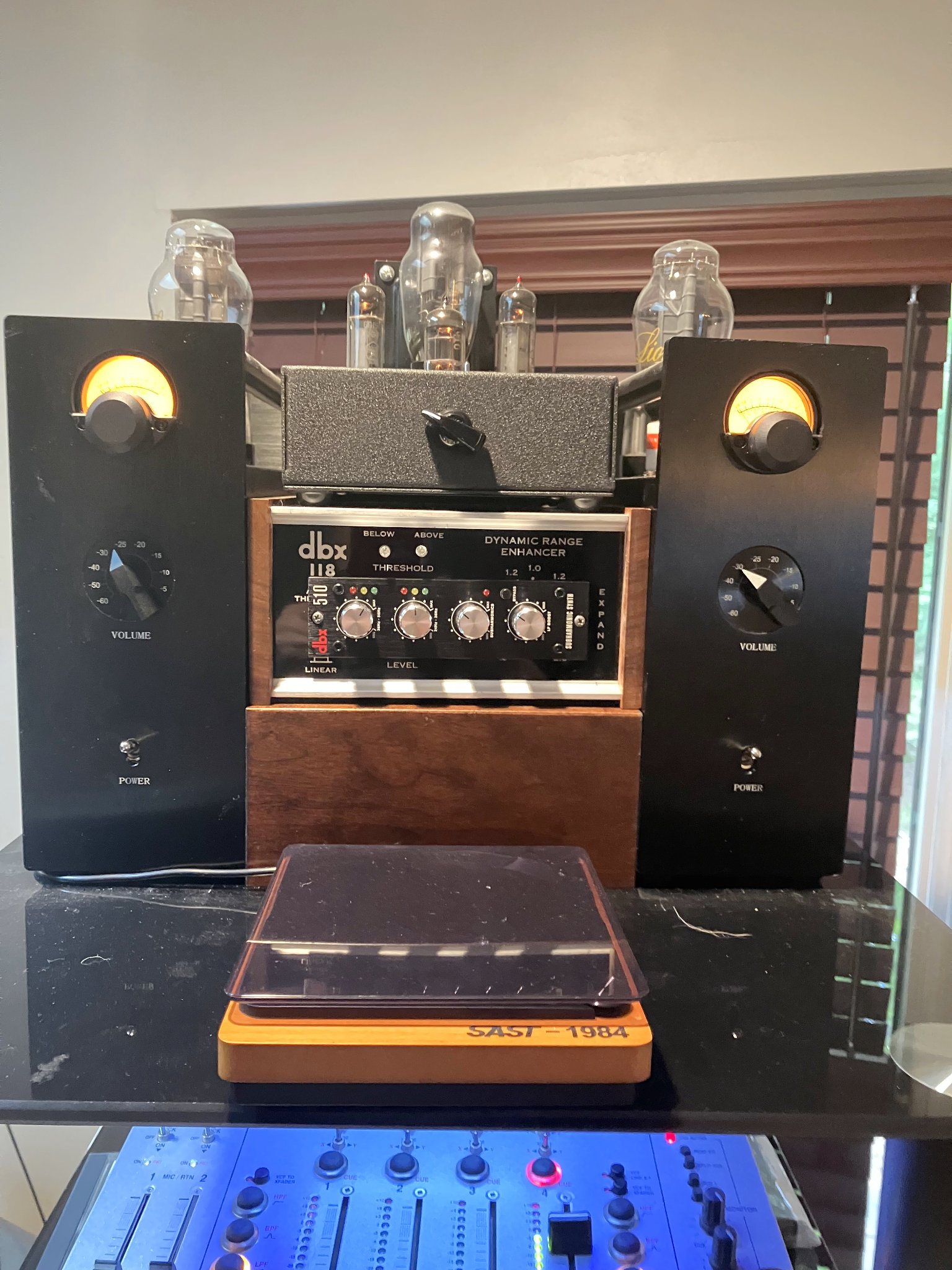

I use a Sylvania preamp tube and Gold Lion 300B's

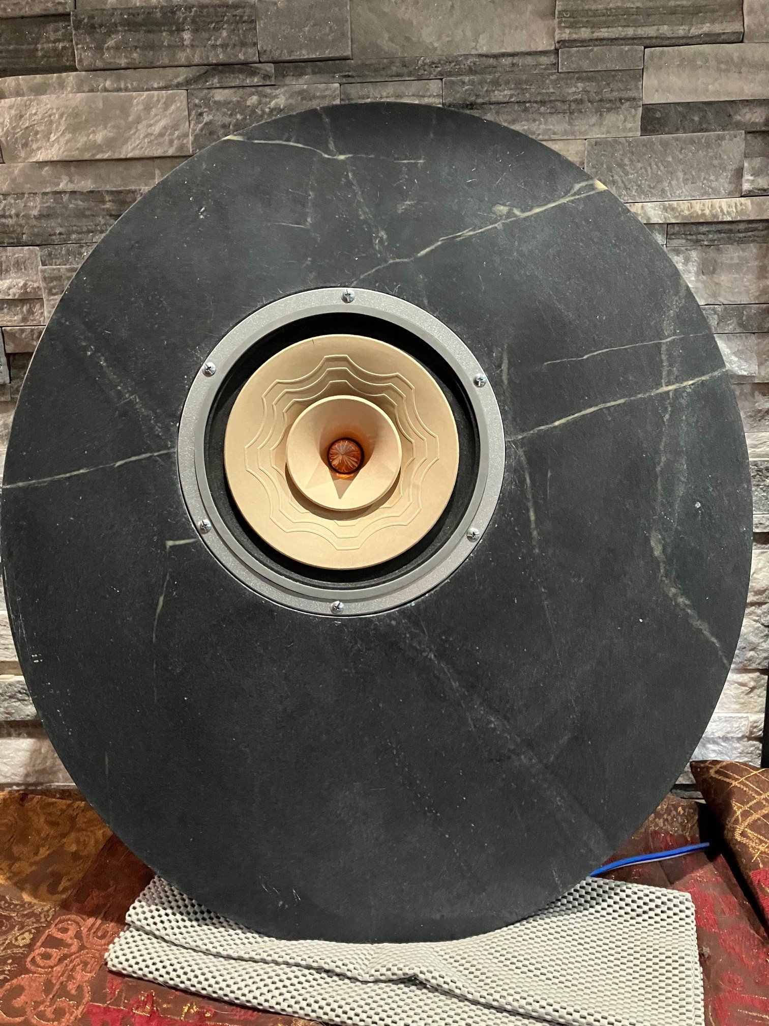

I use these amps to power a set of stone open baffle Lii S-10 speakers.

Did you ever measure the heater supplies when you were under the hood? From your first post, it seems like you measured voltages with the tubes not installed. Fixing the heater voltage at this point might be counterproductive.

This looks like the Audio Note capacitor that replaced the Wima capacitor:Hi Pete,

https://partsconnexion.com/audio-note-capacitor-0-22uf-630vdc-copper-foil/
