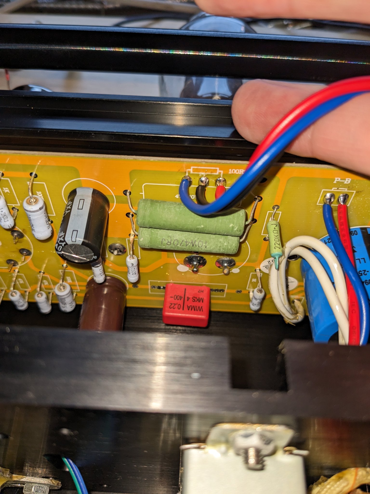

The pot on the back will probably be a hum balance control for the 300B filaments.
100R 2W, I agree that it must be a hum balancing pot. The whole amp looks surprisingly well built.
Hum balance! That makes sense, this is my first 300b amplifier. So, I just diddle the knob to balance out the 60hz hum? The amps are very quiet, even with my Klipsch LaScalas.

I followed the wires from the output transformer back to the board and took my measurements from each end to ground. They are the red and blue wires to the right labeled P and B.
I'm less sure that I found the cathode resistors, lol. In any event, the voltages certainly appear well within limits.

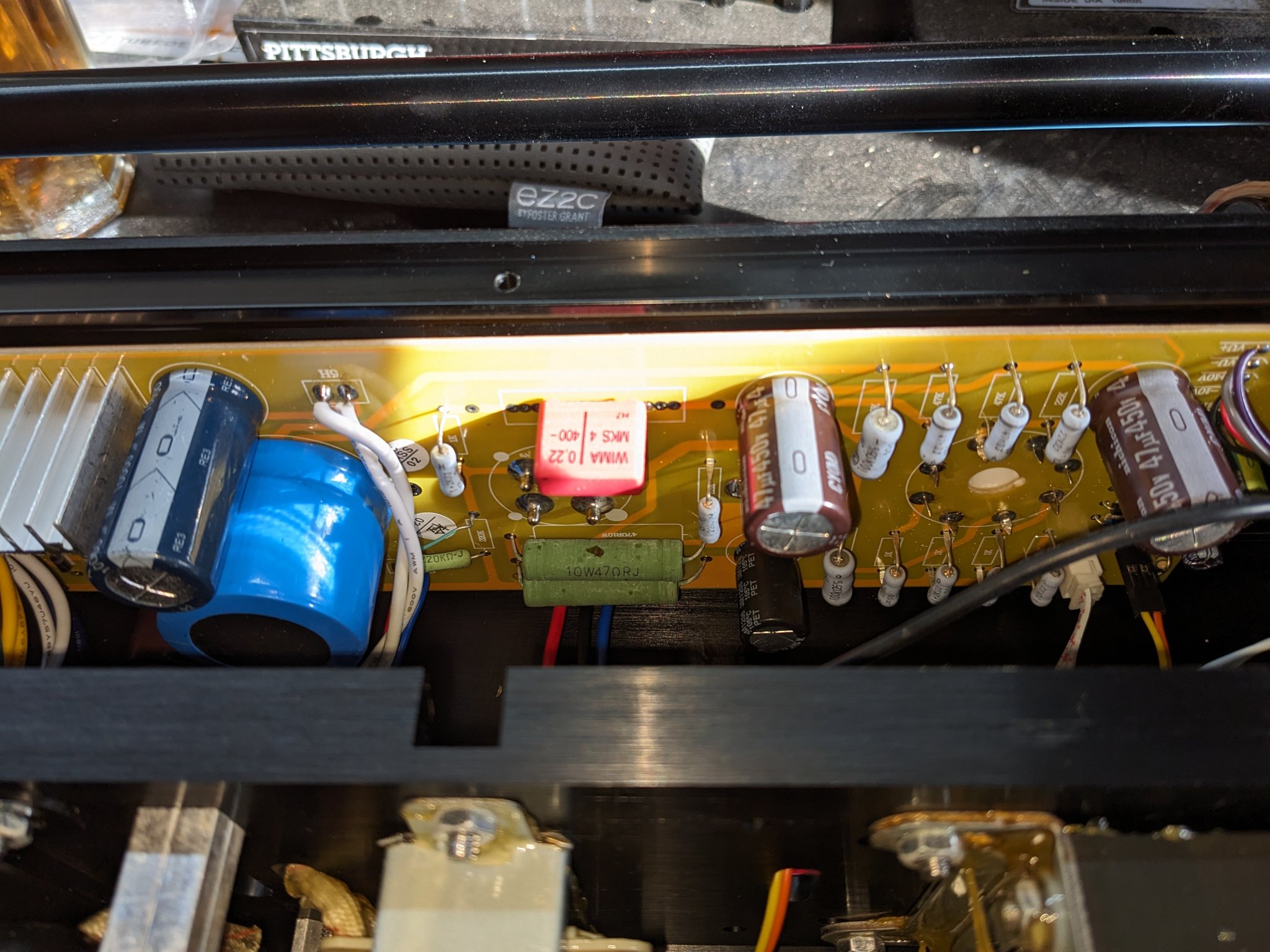

I have been listening to these amps quite a bit and I'm very impressed with them. So, I decided to replace the WIMA MKS coupling caps with something better. I decided to go with Audio Note Copper Foil caps from Parts Connection.
The removal and installation went well enough, although I think that I installed one of them backwards. My understanding is that it is "preferred" to have the outer foil facing the lower impedance end of the circuit, which is presumably the tube side. I'm not going to switch the orientation at this point, lol.
The operation was a success in the sense that they are back in the system and playing music, and it sounds like music, so I didn't break anything! At first listen, with the system ice cold it sounds good. It's currently warming up and I'll spend some more time with it this evening and report back when they have a chance to break in.

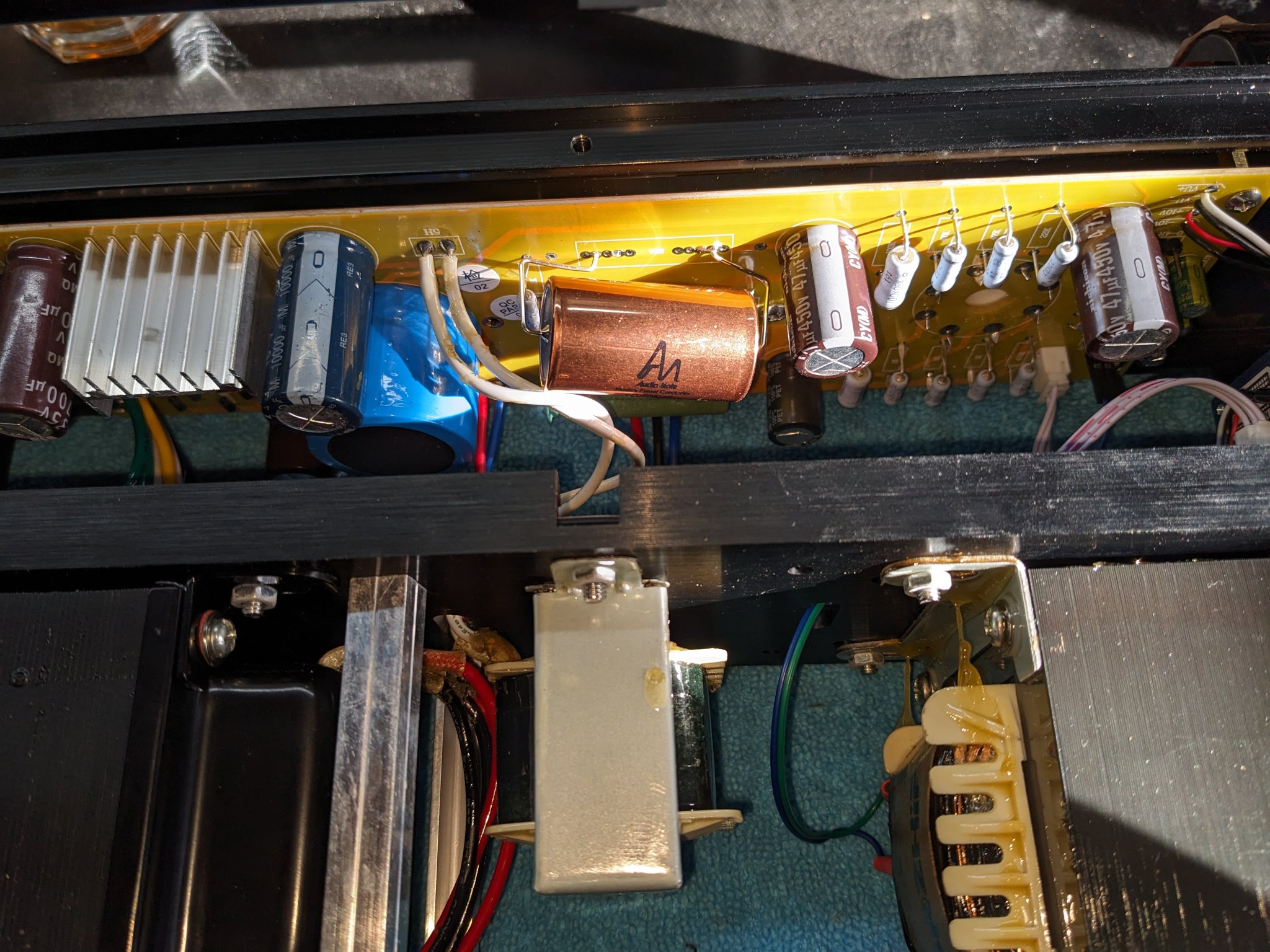

My new Audio Note Copper Foil capacitors now have 35 hours or so on them, and I'm very happy with the results. The improvements in soundstage depth and focus are substantial, as are the improvements to the system's naturalness and detail recovery.
Audio Note says that this line of caps are specifically targeted to the single ended triode market. They say that the only downside of their new mylar in oil construction is that they take longer to break in than the older paper in oil version and sound worse while doing it, but they will sound better eventually.
I looked up the WIMA cap that I removed, $1.72 each or 70 cents per for 1000. Replacing them with 70 dollar parts took the amps to another level, lol.
