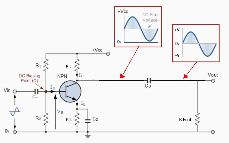

It's common to split the analysis into DC and AC.
The DC signal at the JFET gate is close to 0 V.
The AC signal at the JFET gate is a low amplitude waveform, perhaps a few 100 microvolts (centred on the DC signal of 0V) that hopefully tracks the sound pressure variations on the diaphram.
The DC signal at the JFET drain is somewhere between 0V and V+. It actual value depends on the JFET, V+ and the resistor value. It is biasing the JFET so that is in between being 'fully' On and 'fully' Off in a 'linear' region of operation. The current is always into the drain. The wanted signal signal (AC) can be viewed as a minor variation of the drain current.
The AC signal at the JFET drain will be a somewhat larger value of the signal at the gate. Only a few mV for an Electret capsule. Again depends to the JFET, the resistor, V+ and what the microphone output is connected to.
The AC signal at the Output (the end of the electrolytic capactor) will be the same as the signal at the JFET drain (into a high impedance). The DC signal will depend on what it's connected to.
The picture by godfrey shows when a resistor Rload is added the AC signal is unchanged but the DC level has changed from the DC Bias Voltage to 0 V.
The picture shows the signal having a large amplitude but in reality for an electret the signal is a few mV sitting on a DC bias Voltage of say a Volt or two depending on supply. The drain voltage will get nowhere near 0V or +Vcc.

With a positive supply and ground, current can only flow in one direction,
from positive to negative. There is a standing DC current through the FET,
and this gives a standing DC voltage across the load resistor which is also
the standing bias voltage across the capacitor so the output is referenced
to ground.
The capsule modulates the gate and hence the current through the FET.
This changes the current through the resistor, increasing and decreasing
it, but its still all flowing in the same direction. Its the capacitors stored
DC voltage that allows current reversal in the output, it does not occur
in the FET. You need to read up on single rail AC input/output coupling.
rgds, sreten.

If its used as a switch it can't be being used as an amplifier.
Used as an amplifier it must be biased (or self biased in
the case of this FET) to a DC operating point between
the rails, ideally midway, but that is not likely here
unless the load resistor is matched to the FET.
I don't know what training you have, but understanding
capacitor AC coupled inputs and outputs, i.e. the capacitor
coupling prevents any DC coupling, is fundamental basics.
rgds, sreten.
