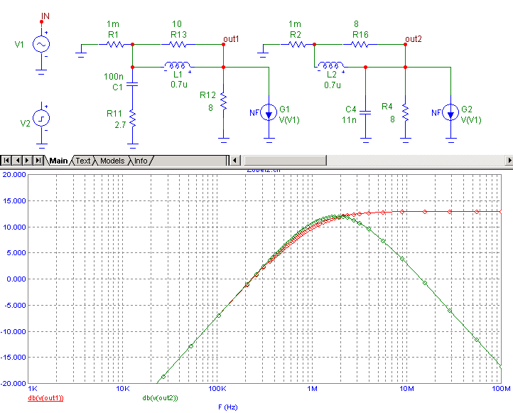

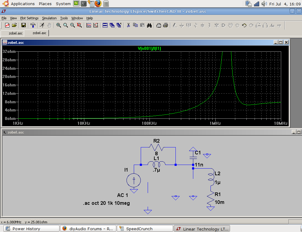

Zobel
Hi Glen,
I disagree with your disagreement. 🙂
Frankly speaking, I don't care who designed that NS Zobel thing, Thiele or even God. That network is ill designed, because at HF, the impedance drops from 8 to ~2.4 Ohm. Maybe others think it's a good idea, but I don't like at all. Also have a look at the step response.
Without consensus about the duties of a Zobel network, I'm afraid that a further discussion becomes rather difficult.
So let me point out what I think a Zobel network should and not should do.
1. Protecting the amp from HF ingress.
2. Protecting the amp from abuse, like a capacitive load or no load at all (i.e. the speaker outlet simply left open).
3. A constant and resistive impedance (seen by the amp) if the network is properly terminated, that is, also by a constant and resistive impedance, equal to the nominal impedance.
4. A minimal impact on frequency and step response, as well as distortion and damping factor.
5. I should NOT correct a deviation from the nominal speaker impedance, in particular at HF.
The latter belongs to the responsibility of loud speaker manufacturer. Happily, some decent manufacturers do this already. So putting another 'HF terminator' inside the amp lowers the impedance unnecessary and should be avoided.
Coming back to the NS Zobel vs my version (schematics below), I simulated them and it appeared that the onset of frequency roll-off of my version happens at a two times higher frequency. Also the step response looks far better (green curve), i.e. faster and without that ugly kink.
One more thing regarding RFI: Analoguous to Bob Cordell's proposal to put a cap (plus resistor) right at the input terminals, I think it's equally beneficial to put the Zobel cap right at the output terminals.
Edmond.

The only thing the output network has to do IMHO is to isolate any capacitive load to a sufficient degree with a well dampened inductor and provide a low impedance termination at HF. Works well for me and the squarewave response is infinitely better too! 😀

Looking at these 5 points I can see that you obviously don't really disagree with my disagreement that much.
Points 3 and 4 are in conflict. I think it is a waste of time attempting to design the output network to provide an "ideal" resistive "impedance" to the amplifier because the huge deviations in the impedance of most loudspeakers. I use Nevile Thiele's (and some varaitions of) networks, but with modified component values for this reason. What do you think Nevile's 14uH inductor does for damping factor and transient response into capacitive loads?
BTW, I haven't forgotten about that Philips speaker article and if I come across my Nevile Thiele articles in the meanwhile also, I'll scan them too.
Glen

The cap directly on the output should be good for RF filtering but I see one problem: When the output is shorted at the other end of a short cable. The amplifier will see an impedance peak, see attachment. The plot shows the impedance as seen from the source.
(Yes that is LTSpice running in wine)
megajocke said:The cap directly on the output should be good for RF filtering but I see one problem: When the output is shorted at the other end of a short cable. The amplifier will see an impedance peak, see attachment. The plot shows the impedance as seen from the source.
Hi MJ,
In that case we need an additional RC at the input side of the Zobel network. However, have we to take into account all possible forms of abuse? The more so as such short circuit condition should have to disconnect the amp from the load.
Edmond.

Zobel & RFI
And here is a relative comparison of the capabilities to block RFI ingress of the NS (red) vs my version (green) of that Zobel thing (notice: these two versions use the same inductance).
Clearly, above a few MHz, that NS Zobel network does nothing. So I insist that most people are blindly and mindlessly copying existing schematics and haven't the faintest idea what they are doing.
Edmond, how many amps still have 1 mOhm output Z at those frequencies? I think the usual explanation is that the output Z will be much higher than the Z of the Zobel at HF. Still, you have a point, I think.

Hi Christer,
I'm afraid you missed my point point. I was talking about the relative performance of the two circuits. It doesn't matter if Zo of the output stage is 1, 10 or even 100 mOhm. Also, I was even looking at the wrong node (see new picture: out1 and out2). Even that doesn't matter. Anyhow, according my new sim, the NS version appears to be still inferior.
Edmond.
