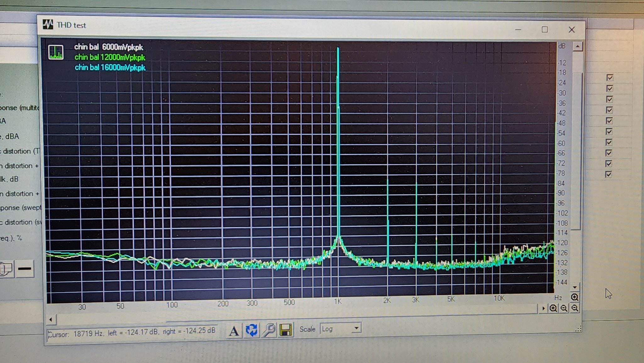

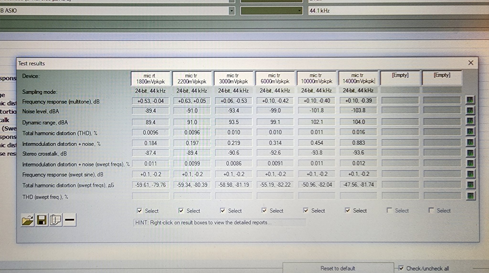

I still have not heard a decent answer to how do I select the best transistor for my audio circuit. So I figured if I could measure THD and noise floor it would be a good start.
A friend did gift me a FIIO K5 Pro. When he upgraded. But I cant get it to work with REW or ARTA because it does not have an input that shows up in windows. My dats V3. On the other hand does show both input and output. Maybe I should look at using that.
I use Right Mark audio software to measure audio circuits, it provides lots of information. THD, fr response, intermodulation, fr spectrum, phase, enough for me. And its free, just like REW. I use REW mostly for speakers. Both free. Both generates their own signal.

Since you asked.
I want the ability to see how changing components and circuits impact THD / Noise Floor. / Noise / output. I want to play with this.
Like Rods P3A amp. I have 4-5 different PCBs all built around the same schematic. So far I have built 3 boards. All with the same components. Testing should show me which board is the best. Once I know that. The next step is to start changing transistors and other components to see which improves the benchmark numbers and which ones degrade.

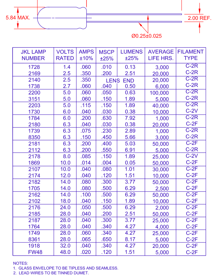

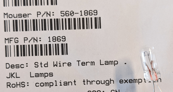

If the OP (or someone else) wants build a simple (and not that bad) bulb-stabilized oscillator...
In '90s AVT was selling diy-kit "Laboratory audio-frequency sine wave generator". In attached article the author describes this circuit and the design process. Foreign language, but diagrams and tables are "international".
Important things from this article:
  • op-amp with higher Iout (NE5532) is better for stability
  • hi-V low-I bulbs are better than others
  • higher Ub (24V) give better parameters
