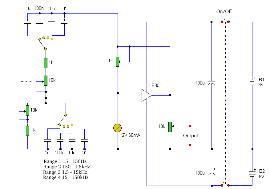

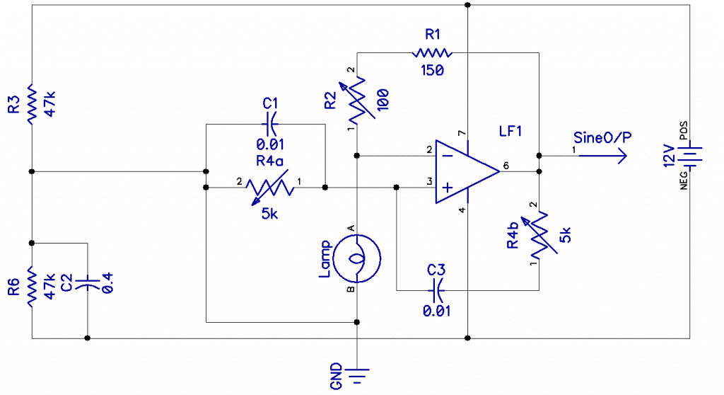

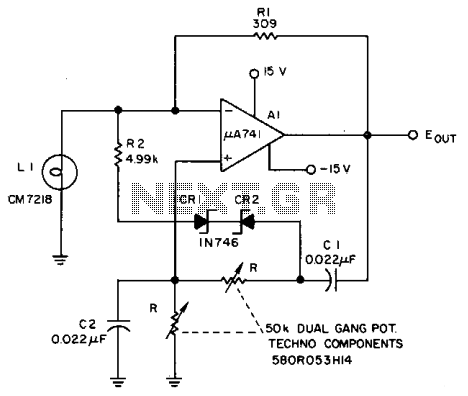

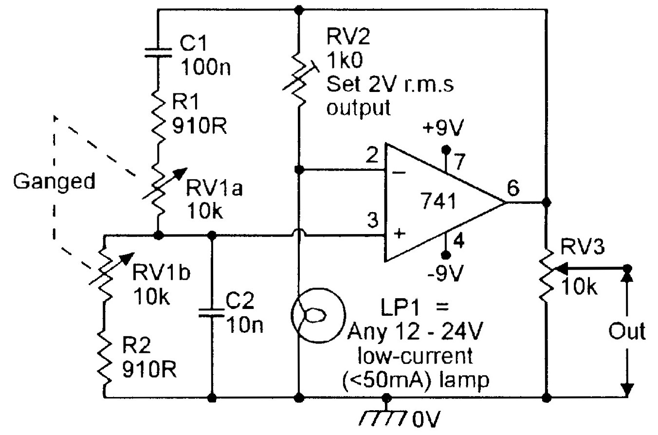

It is probably a Wien-bridge sine generator, where the feedback loop contains a small lamp (6 V/50 mA or so, miniature lamp with wire legs). A comparator for turning sine to square, and an integrator for turning square to triangle might follow. A Wien-bridge oscillator generates low distortion sine in itself.

The resistance vs. filament temp characteristic of the bulb is used to stabilize the Wien bridge generator voltage so that it does not go into clipping.It is probably a Wien-bridge sine generator, where the feedback loop contains a small lamp (6 V/50 mA or so, miniature lamp with wire legs). A comparator for turning sine to square, and an integrator for turning square to triangle might follow. A Wien-bridge oscillator generates low distortion sine in itself.
