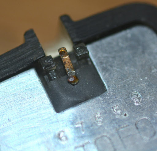

Close up of the ortofon Type A cantilever. Coil is wound vertically. Not quite tip sensing, but very little room for flex. Silly money even as basket cases
