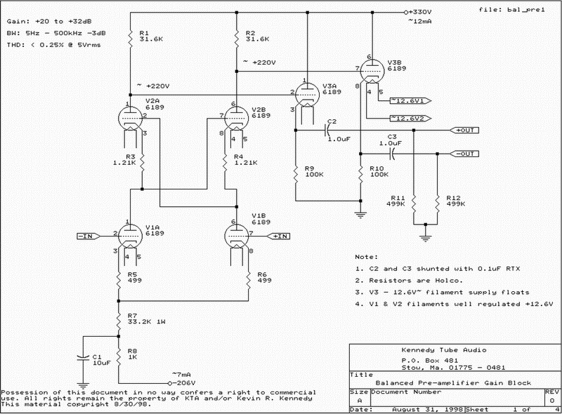

Balanced Preamplifier
This is an interesting circuit too.
I played around with a circuit like that some years ago, though using the 6S*7 and 6DJ8 families of tubes rather than the ones you show here; the small-signal performance was good, but swing was rather limited. Fine for a preamp, less so for a power amp driver stage.

With a 5691 or 6SL7, the gain was about 20 (26 dB). I've noted rise time and distortion earlier in the thread. In balanced mode, the 2nd harmonic (a few tenths of a percent) will largely cancel.
