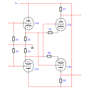

In another thread: http://www.diyaudio.com/forums/showthread.php?s=&threadid=137332 I have tried to stir up a discussion about a small amp in the Baby Huey class. I would like to use ecl82 but ecl 86 is also o.k.
I wonder if the here discussed topology with fet at the front could be used with a PP ecl82/86.
Another idea is use a double triode at the front (I have a few ecc40) and than use after that the triode of the ecl82/86 as a cathode-follower.
Perhaps this would be a nice (better ?) variant of the Baby Huey (?)

Hi Jaap
I can't remember where exactly, but I recently asked SY about the input stage shown in this thread. He said that if he had to do it again he would probably opt for a LTP input stage, with well matched anode resistors and a very good CCS - that is, the baby huey input stage.

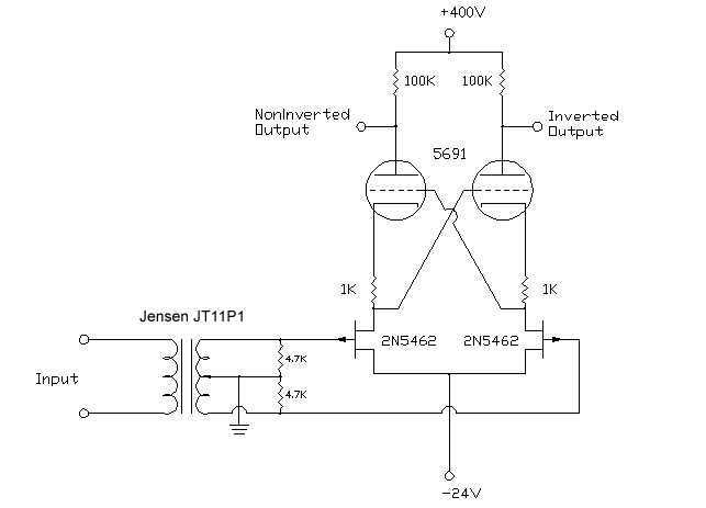

No, that's the FET's drain (plate), not the source connected to the minus rail; note that the FETs are configured as source followers, where you want the drains to be at signal ground.

SY, this is an interesting circuit indeed. But what's the bottom line? How does the Syclotron compare to a well executed baseline common cathode plus split load, as illustrated by your Red Light front end? Did you do any comparisons? Distortion, output swing, symmetry, PSRR et al?
Inquiring minds want to know what we get for the extra tube and fets
Here's the bottom line: I don't currently use it in the amps in my living room.
With an input transformer to give it good balance, it works about as well as a cross-coupled inverter using an input transformer or other balanced input. I have a somewhat improved version that I'll pick up and optimize/measure when I have the next two projects off my plate, just to see if I can work a distortion null. Without an input transformer, the balance is, as with the cross-coupled inverter, a function of mu- balance is proportional to mu/(mu + 1).
The advantage over a voltage amp/cathodyne is common mode rejection. It will be interesting to see if I can squeeze out a linearity advantage as well.
