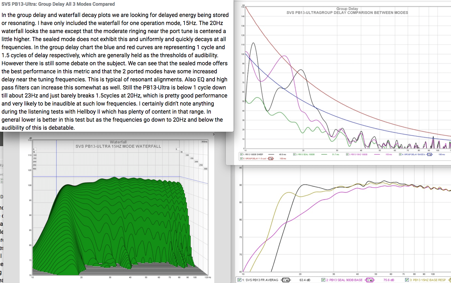

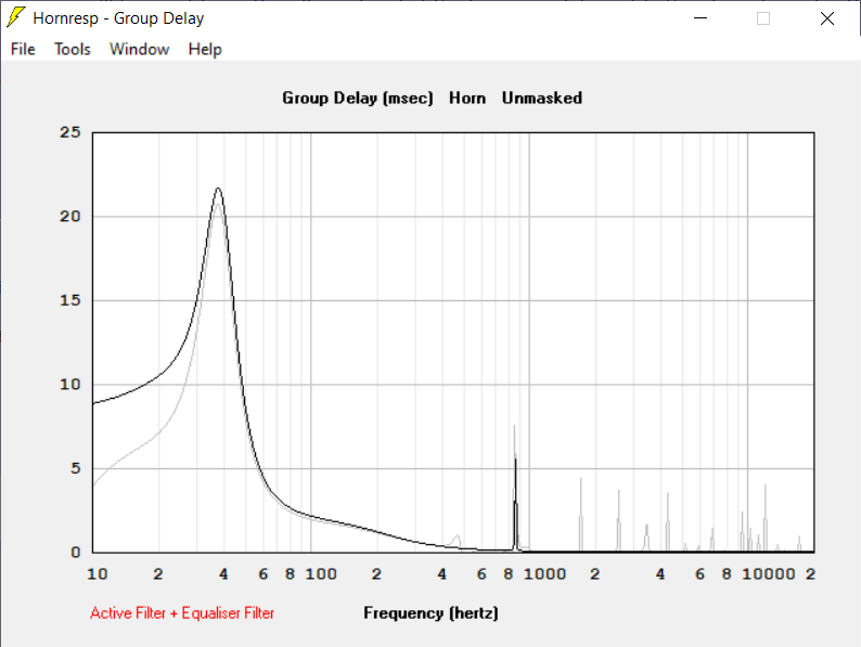

A sealed box does not have the same time-domain performance as a ported box.
The port output of a bass reflex (BR) box is in phase with the sound waves emanating from the front of the driver's cone, but lags behind the front radiation by one cycle at the box tuning frequency (Fb), hence BR designs are also known as "phase inversion" designs.
This is clearly evident in Josh Ricci's test of the SVS PB13, which can be operated sealed, or with a 15Hz or 20Hz Fb.
https://www.audioholics.com/subwoofer-reviews/svs-pb13/pb13-measurements
In the group delay chart, the blue line represents one cycle at the given frequency, 100ms at 10 Hz, 50ms at 20Hz, 10ms at 100Hz, the red 1.5 cycles of delay.
The green trace of the sealed is basically 1/2 wavelength all the way down to 10Hz.
Around the 15Hz (purple) or 20Hz (black) Fb, the ported delay goes just over the red 1.5 cycles curve, above 30Hz it matches the sealed response.
As you mentioned, whether those issues are audible or not is another discussion, but the issues are inherent in the phase-inversion that makes a BR cabinet perform as it does. Can't get something for nothing...
I certainly can hear (and feel) the huge SPL advantage around Fb compared to sealed, but can't hear the time domain difference over the typical decay times of LF program material or room modes.

My post said specifically a sealed box with additional processing. I've included some attachments to show what I mean.

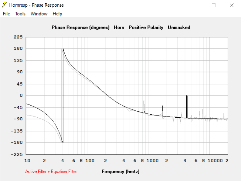

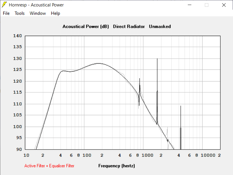

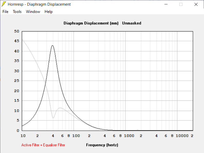

On the attached Hornresp screenshots, there are two very different subwoofers. They each use a Beyma 15P1200Nd. Grey is 100L ported tuned to 40Hz, black is 50L sealed with a single EQ filter (around 10dB boost at 39Hz) and a 2nd order highpass. I matched the frequency response curves as closely as I could in the time I had, and then checked the phase and group delay. Excursion is included as a minor point of interest.
Chris

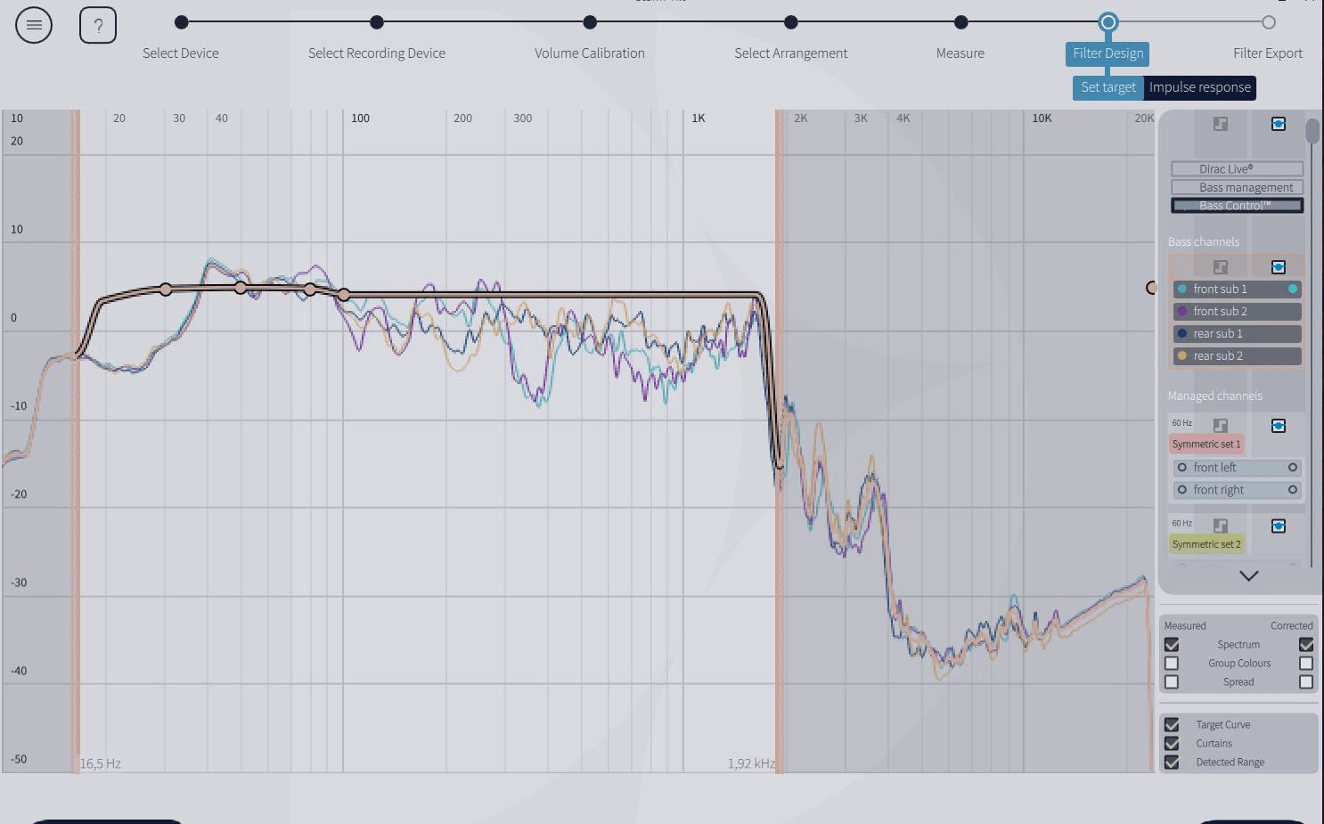

@chris661, I am very happy to have found this thread.
Currently, I run four of these elements in my home theater, housed in 150-liter sealed boxes.
I have been operating them without a Low Pass Filter and using Dirac Room correction to equalize them to flat.
I can boost the low end with Dirac, but I am wondering if it would be more beneficial to use an LPF like you have.
I feel that I am missing some infra-bass by running them this way, so I am considering adding either a Linkwitz Transform or an LPF.
Which one would be preferable? Is there any point when using Dirac to equalize these anyway?
I am thinking to test your 18hz@ 12db/octave. (is this Butterworth or Linkwitz Riley slope?)
Here you can see the response from my room.

The lowpass filters I used were just a convenient way of getting the frequency response to a useful shape: flat from ~20Hz-70Hz, rolling off above that.
In your case, I'd recommend EQ to boost the response below 30Hz. I expect you have plenty of headroom, and these drivers can take a lot of power!

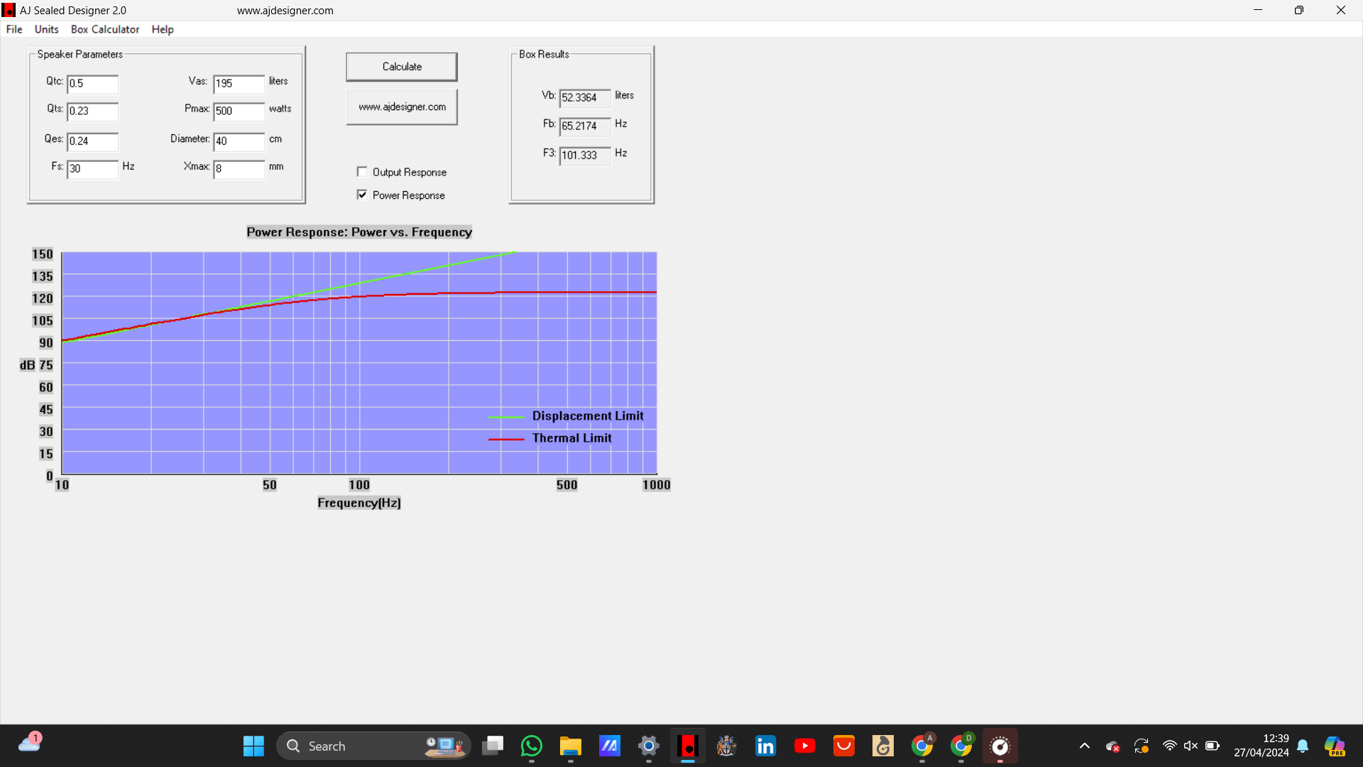

I have a question about cabinet size vs processing, vs phase issues. (Or group delay, or whatever the correct term would be.)
Obviously, sealed subs need quite a bit of boost using a low shelf filter. And filters have phase issues. (Something I don't have a good grasp on, but I know this is a thing.) Plus we want the subs to be as phase-aligned with the tops as possible.
So would it be correct to assume that one benefit of a larger enclosure is that there is more acoustical LF extension? In other words, you need less gain on the low-shelf boost, and hence less phase anomalies?
Would it also mean that a processor with FIR filters would be preferable?
There are lots of good PA power amps with built in DSP which enable you to tune and balance the sound easily to a very high sound quality standard.
The ability to limit driver excursion and / or power input is usually a standard feature on this types of loudspeaker management gear.
A domestic use case would be around 500 watts AES (the drivers are rated at 1,500 watts continuous and 3KW peak power handling) and only 8mm cone travel... The drivers are AES rated with a plus/minus 13 mm Xmax and 30 mm before damage.
So running a single sub at one third of max power holds 108 dB continuous SPL ... A pair in with around 4dB room gain will hold 115dB SPL at 30Hz... DIY build cost around $750 using high quality 24mm Birch Ply and a nice spray paint finish...This makes a mockery of the snake oil rip off "High END Audiophile" sub woofers at $5,000 to $10,000 each!
