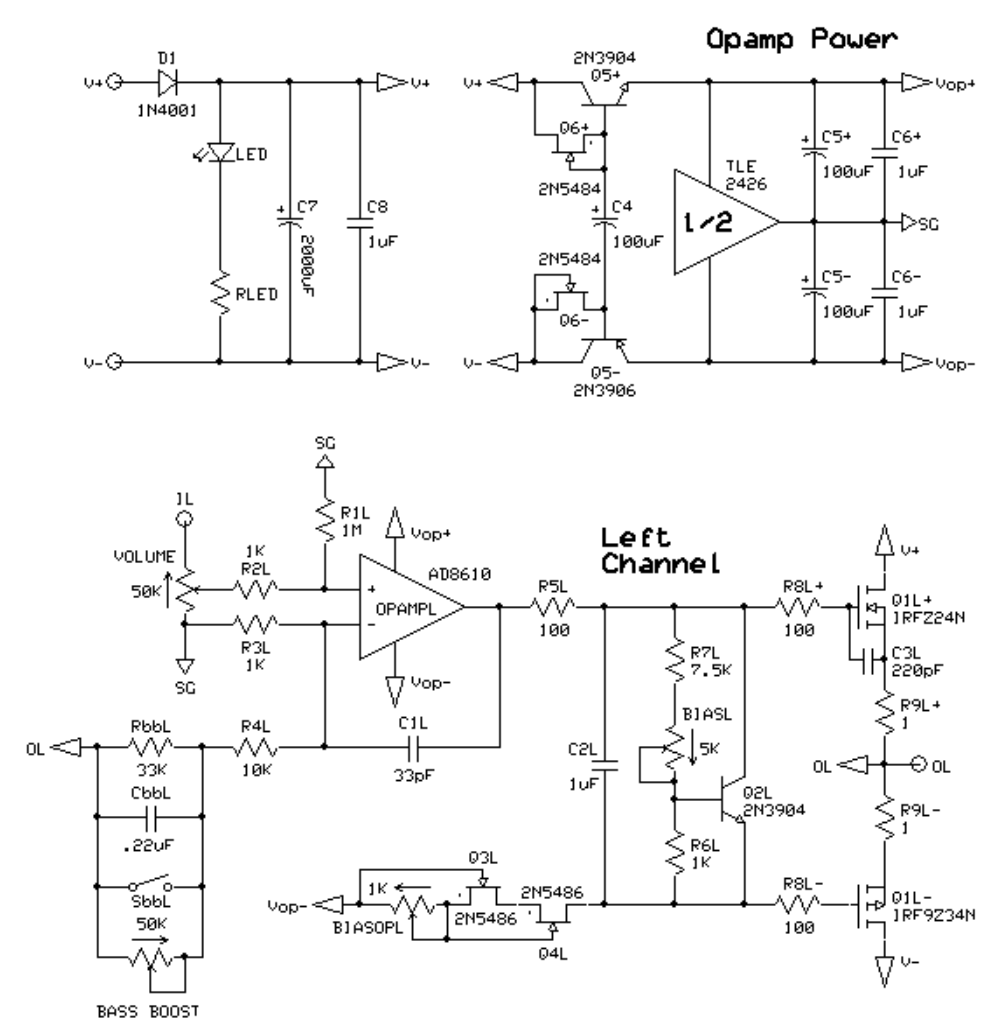

I am sorry for the confusing response. Let me include the original schematic here:
This is what I am trying to replicate with a fully differential OPAMP without the bass boost circuit (SbbL is short circuited). I will use the notation of this schematic in the followings.
  • The OPAMP power circuit is a capacitance multiplier to separate the power of the opamp and the MOSFETs. In this circuit a virtual ground circuit (TLE2426) is used whereas I am using a symmetric power supply (AMB sigma 22 @ +-10V).
  • The OPAMP circuit is a standard inverting circuit with global feedback having a gain of 11 here (5 in mine). There is a 33pF cap to set the bandwidth.
  • The BIASOPL, Q3L, Q4L circuit is a.cascade JFET constant current source circuit (which I think is the issue)
  • The Q2L circuit and the surrounding resistors is for setting the operating point of the MOSFETs.
First BIASOPL is set so the R5L resistor has 0.5V across it so 5mA current from the output of OPAMPL into Vop-. SInce the MOSFETs are basically open circuits at the gate the current will flow through R5L, R7L, BIASL, R6L, Q2L and the CSS circuit. Initially BIASL is set to its minimum (fully counter clockwise). In this case no current should flow through Q1L+ and Q1L-. Then BIASL is set while the voltage is checked across R9L- and the quiescent current of the MOSFETs is set to about 80mA, 80mV on R9L-.
The PCB design replicates the schematic for sure and shouldn't affect the DC behavior of the amp AFAIK.
As @Nisbeth was saying I am trying to merge the AMB lab's M^3 amps channels into one fully differential channel. This amp is originally 3 channels, two for L/R and one for ground which is a voltage follower circuit.
From what I understand about fully differential opamps, they really try to force the signal and its invert created from the input signal servoed around the mid voltage between the supply voltages or the VOCM if used. Since I am trying to draw positive current from both OUT+ and OUT- of the opamp, it might interfere with the OPAMPs behavior (handwaving argument, I know). I don't know if I should reverse the whole second stage in a way where the CSS circuit is connected to Vop+, has 2N5484 JFETs in it so current would flow into the OUT- of the OPAMP (still using the notation for the original amp here). I really don't know if this is a good idea or complete nonsense.
I actually had trouble sourcing the JFETs and it would be great if the CSS and the capacitance multiplier circuit could be changed to something which don't use MOSFETs. I bought them from an ebay vendor, but the cap multiplier circuit seems to be working fine. I have not measured the Idss of the JFETs nor do I know how that would influence the operation of the amplifier.

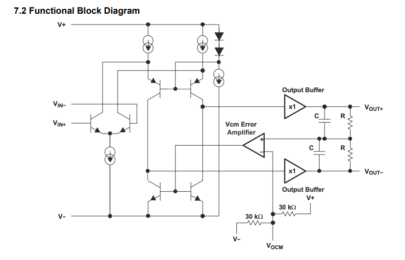

I'm not sure this circuit will work as expected. One reason are quiescent voltages on the output.
An FDA will servo its output pins so that their CM voltage is at mid-supply or whatever voltage present on the Vocm pin. But the final output will have a lot of voltage offset. The feedback does not handle it, it will only care about the differential voltage. There will be a lot of DC voltage at each output, basically the Vgs of the main MOSFET.
This is fundamentally different from the regular opamp version where the feedback adjusts for the in-loop level shifting.

This circuitt worked as is (with a different OPAMP though). As far as I know the OPA1632 has an output buffer for each output. This is what its datasheet shows:
The OPAMP j4cbo used has the same functional block diagram.
This circuit has worked for j4cbo here As long as there is no DC between OUT+ and OUT- (in my schematic), I'm good.
I am not saying this circuit only worked only if there was no DC between OUT+ and OUT-. Also, when I measured the DC between OUT+ and

Side remark to the schematic in post 6, part "Op Amp Power" :
Q5.. and Q6.. are obviously intended as ripple filters, cap multipliers.
Now, the Fets wired as current sources try to push a fixed current
through bases of the bipolars - there is no other dc path. But the
base current is more or less fixed, consumption of the stage divided
by beta. This means the Fets can not work as intended, they will be
overdriven practically always. You will probably not notice this in
operation, because ripple suppression can still be "good enough".
This is a waste of fets. Better wire these as followers, establishing fet
darlingtons. Two or four additional resistors are required and can be
high-ohmic.
