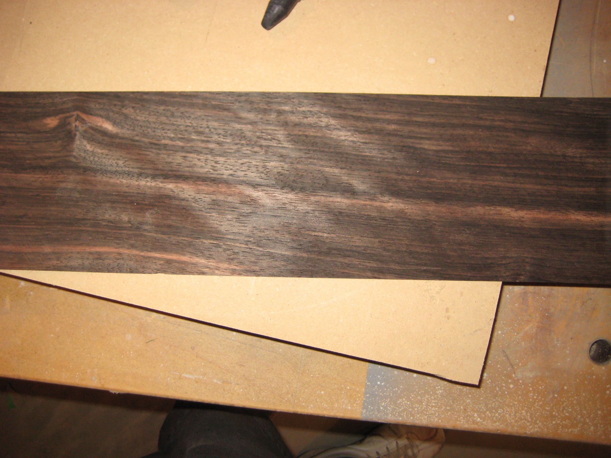

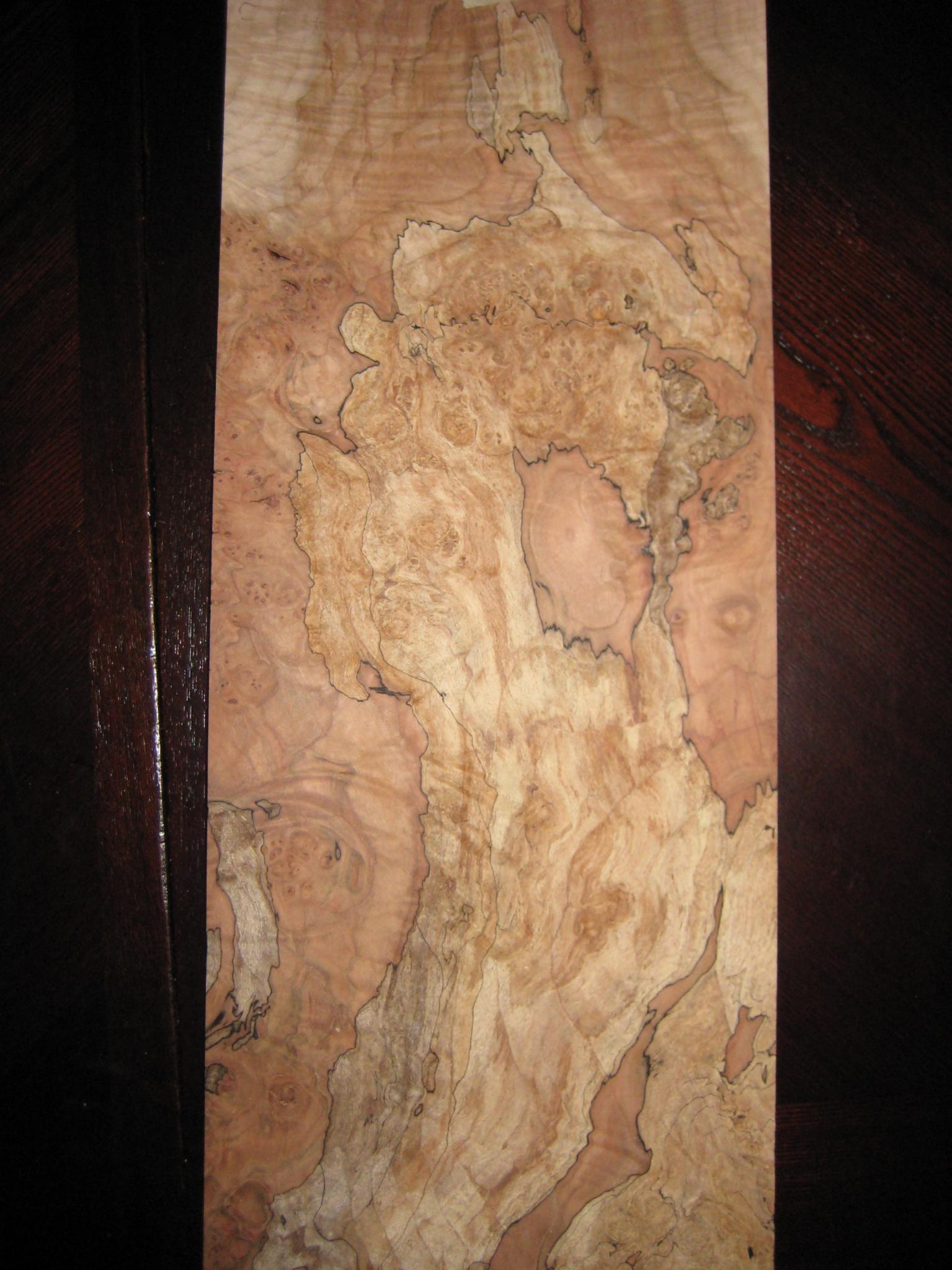

Well,, not sure if anyone is interested but with the help of Dave i have decided on a modified mMar ken6. I wanted the box taller to fit some spalted maple i am going to use on the face, no point wasting it. I also wanted the slot port on top so i am going to invert the box..
I got a smokin deal on the gen1 Alpair 6 from Bob, I gota say these drivers are built well..
I started cutting wood today, I decided to use mdf as i had it laying around and trust it with veneer. Cant stand the dust though..
A few pics of the spalted maple I got off Ebay, it was meant for a guitar😱
and tiger maple veneer and a small bit of Macassar ebony i will use as an accent..

I'd suggest that with the precious nature of your selected veneers the iron-on glue method would give you much more flexibility for positioning & grain matching/wrapping than either cold press or contact cement.

I always use contact cement ... Weldwood brand and after countless applications over the years have yet to have any problems. (Now that I have made the statement something will probably start to blister / bubble🙄
I agree with Chrisb regarding the flexibility of the iron on method 100% however. You have the opportunity to get the positioning "prexactly" before adhesion whereas with the contact cement its juggling dowels / bits of paper and lots of "body English" to position it just so.
thanks guys, i will pass on the iron on method.. just dont seem right to me. Wood glue is a non convertable coating. I cant see how heating it up after it has dried would give you a superior bond over solvent based glues.. perhaps outside where you might deal with weather (heavy expansion and contraction) but inside in a controlled environment, i think contact or a cold pressed polyurethane will far surpass "reactivated" wood glue.. Not to say it dont work😀
