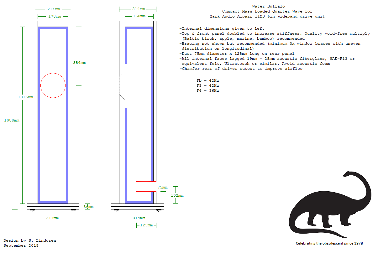

OK, thanks! Did a forum search earlier that only turned up the name in several posts, but no drawing. :(
705308d1537724811-miscellaneous-designs-mark-audio-fostex-tb-dayton-seas-etc-water-buffalo-11ms-compact-mltl-imperial-png
You're welcome!
Your call........ both are suitable for vented specs drivers. I'm a major league MLTL fan going on 57 yrs now for its bang/buck performance, ease of design/build, while a quadratic taper yields a much more interesting/pleasing visuals with a slightly different sonic signature due to how the driver interacts with its shape.
