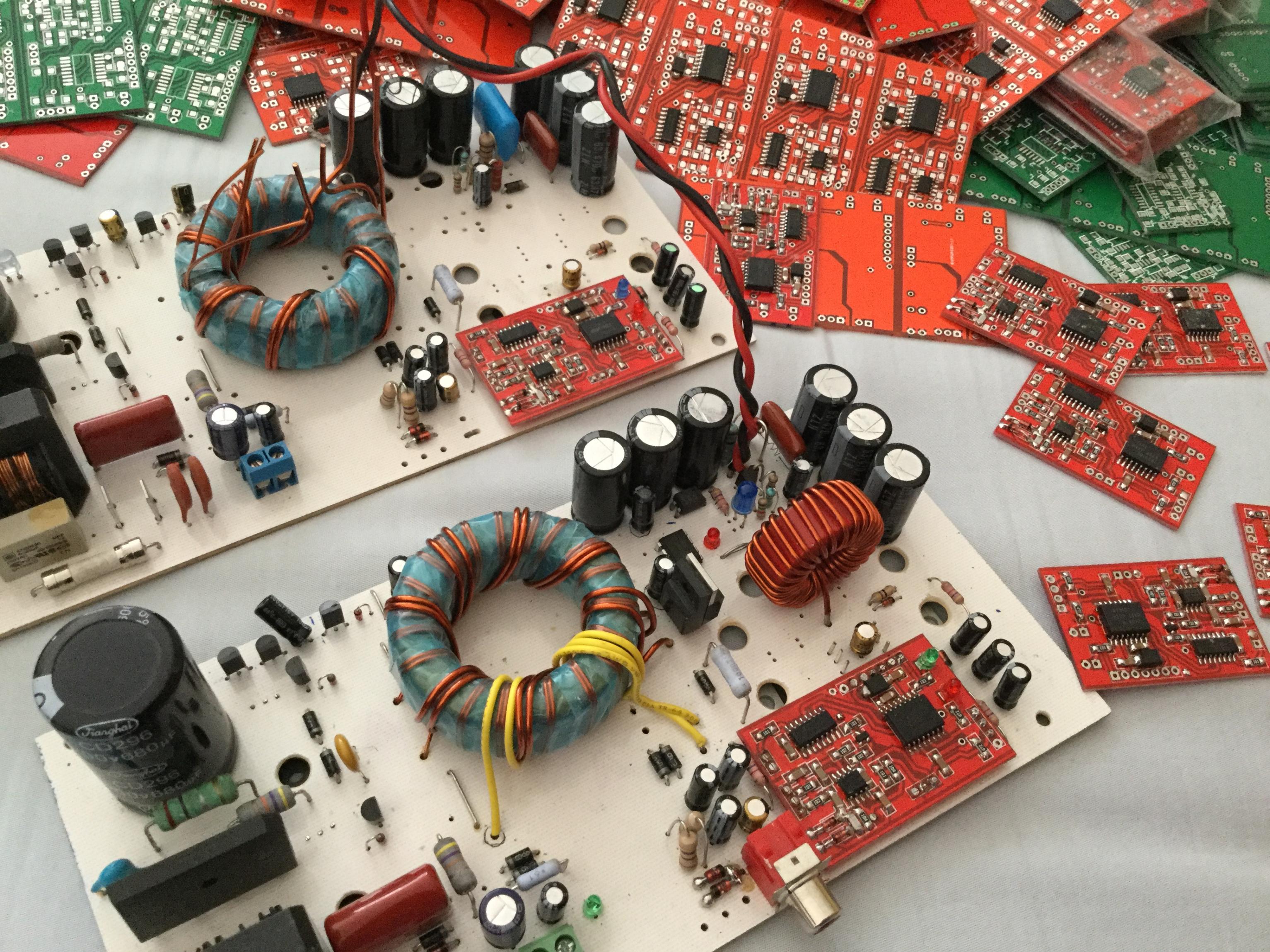

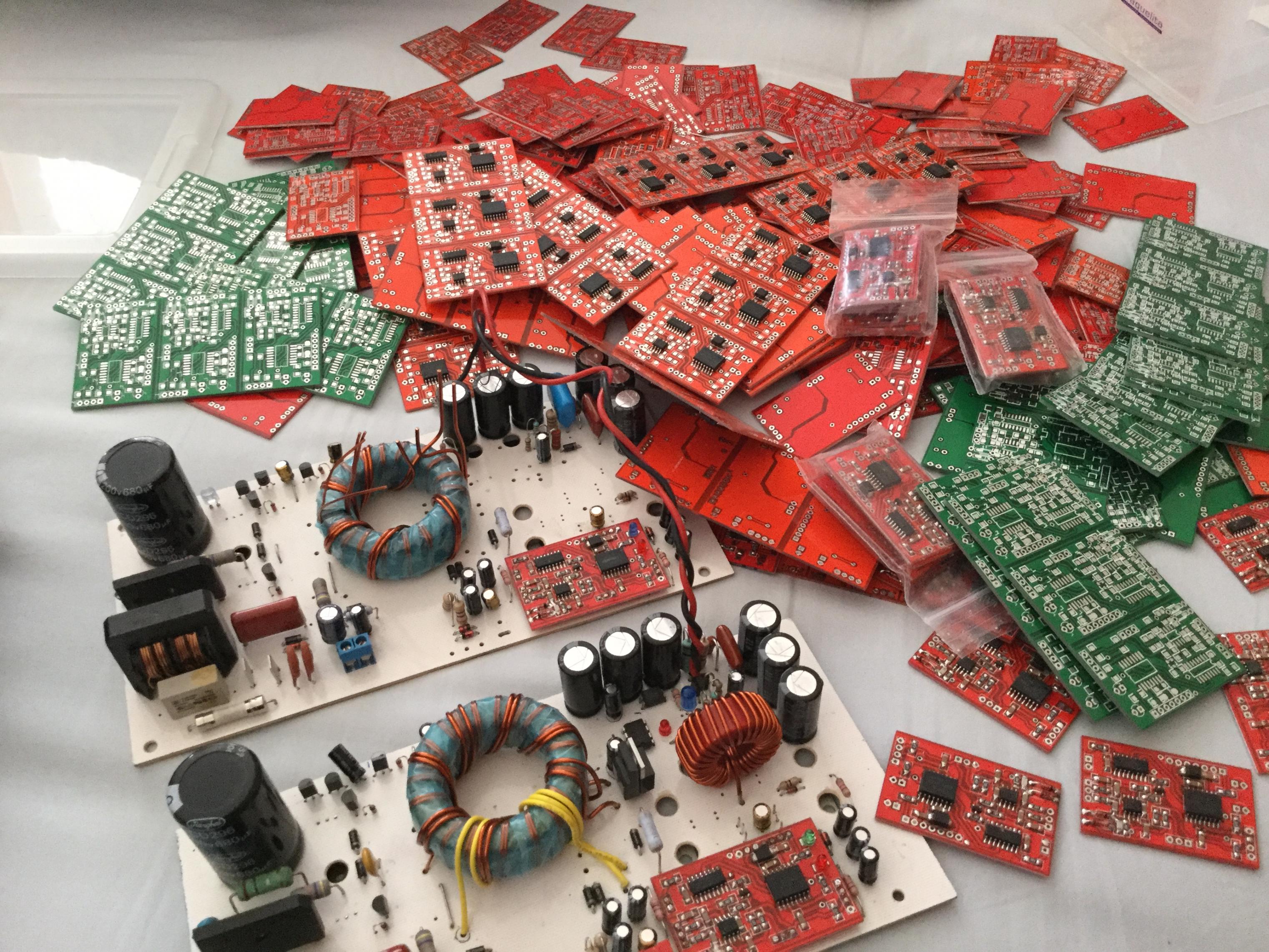

Some playing I have done, but now I did receive the line transformer for the allfet, so get wind it, need 2000 windings each side.

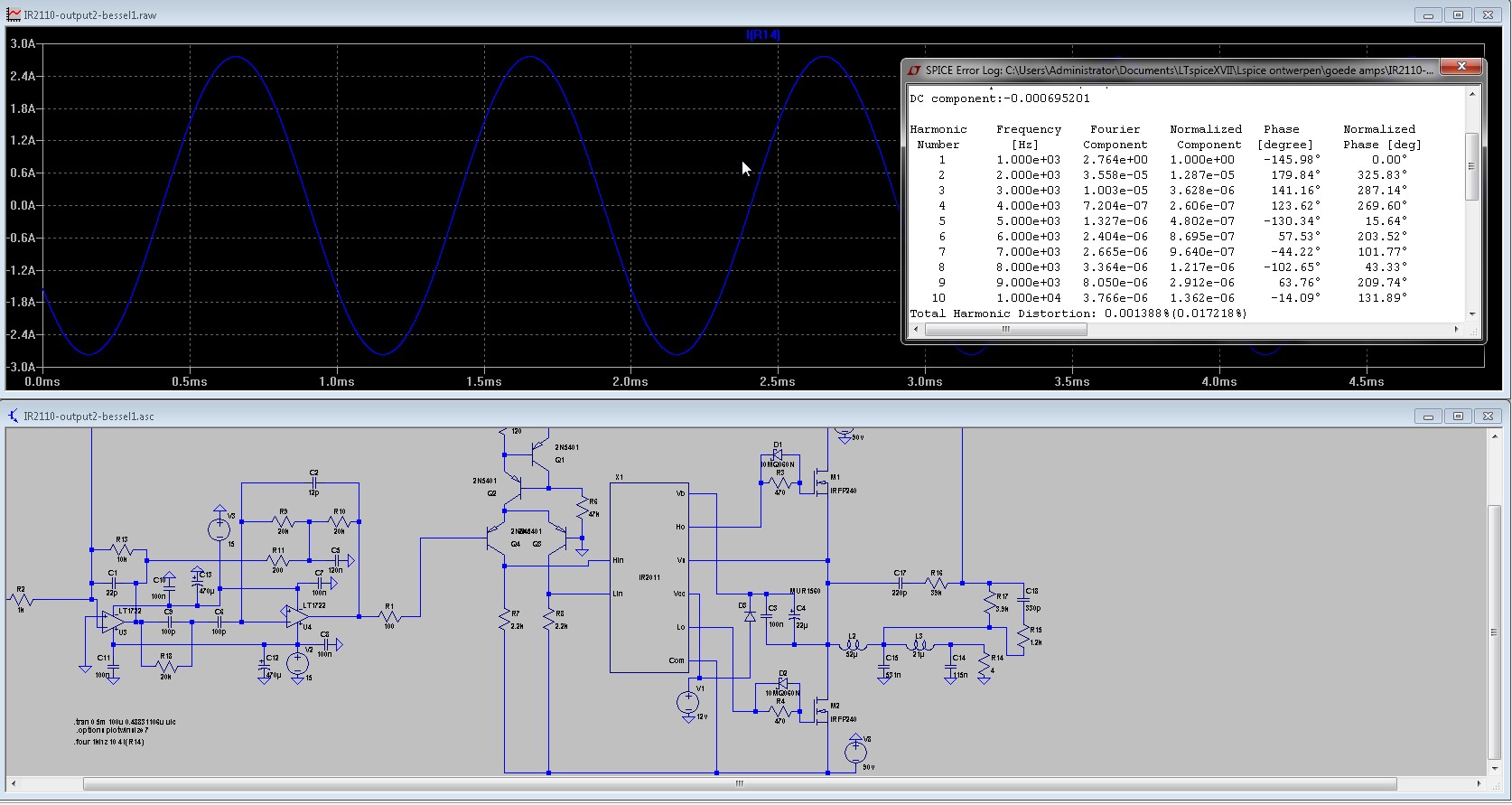

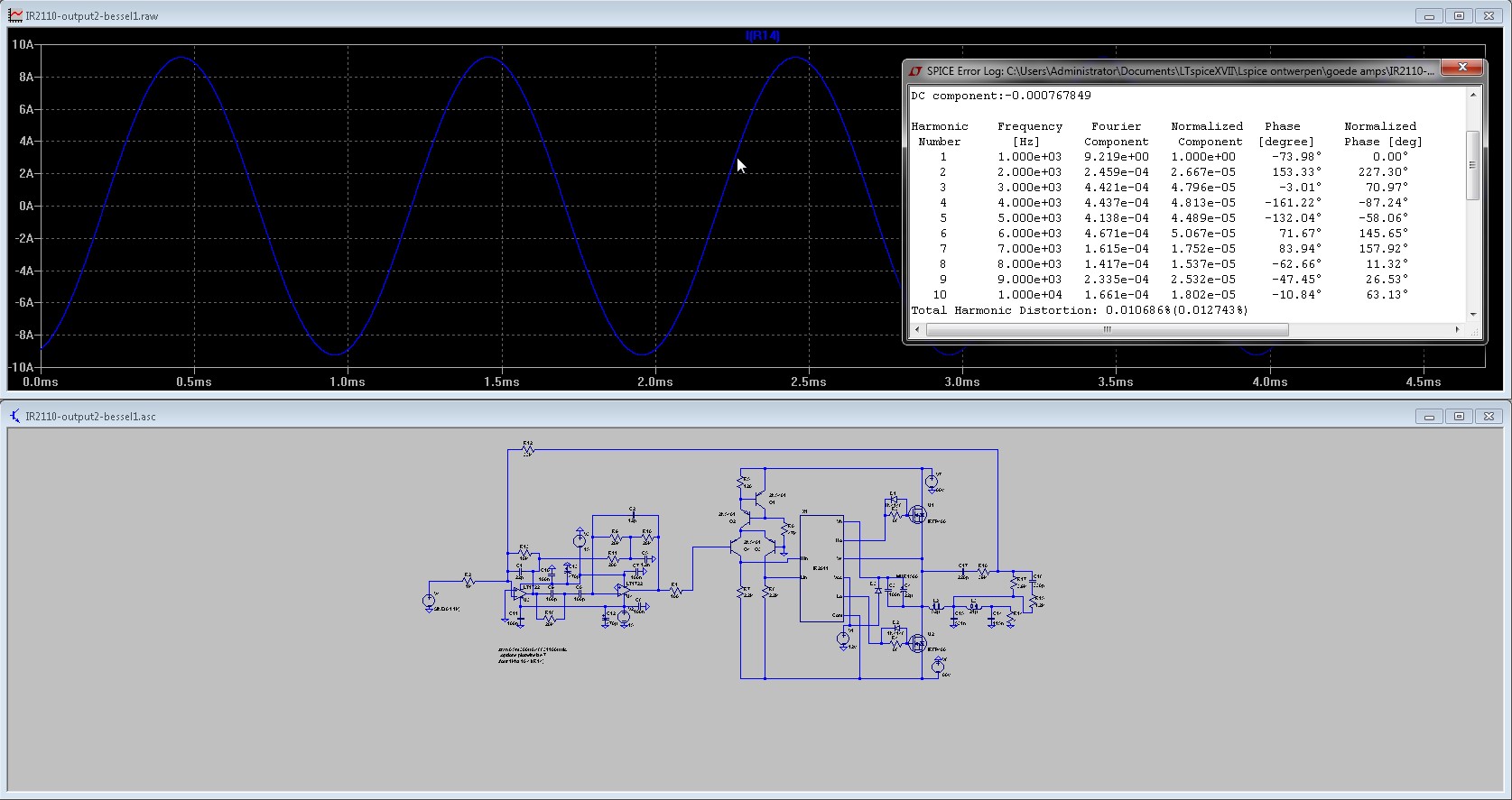

I did use a changed bessel low pass, I did see after tests that when set -3db point higher, lowpass put more power out, did get 0.023 % distortion with 2 ohms load but with a multipole filter, who needs much work to get hd low. shoot through mosfets was 18 amps.

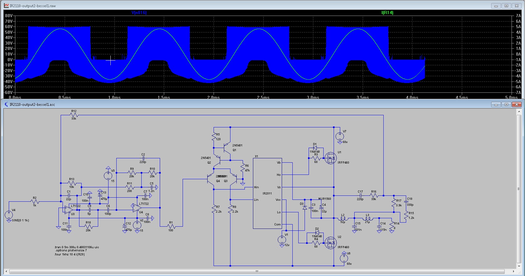

Did also play with the chip IR2011 these did go nice, has low hd also, but with multipole filter use, and not yet a dead time setup. The model is not oke or I do something wrong but the negative side mosfet do not get full on, it go to half the top fet does, so 80 volts and lower side 40 volts, I do not now why.
Last photo with the blue carrier you see that the negative side is strange, needs the same as the positive side,
