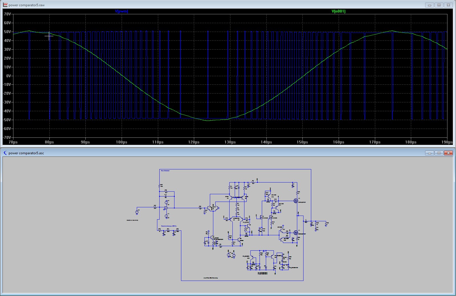

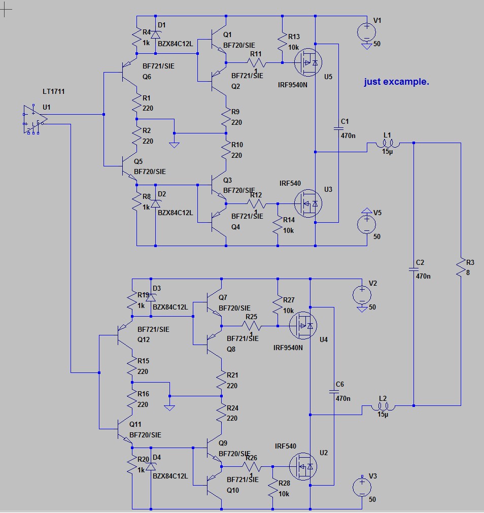

I use opa2365 and power comparator schematic for testing, but this is a example.
Hmm maybe a class D circlotron, by removing half the power stage each half.

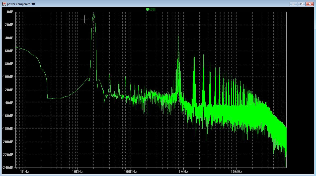

and this I did simulate, have quite low distortion because of multipole faseshift for self oscillation, the carrier stays quite stable now with overdrive.
Harmonic distortion is with 40 volts peak in 8 ohm, carrier 800 Khz, amp has 50 Khz bandwidth and there still -80 dB hd.
Just give it a try, I have not build it, just sim, I am now busy with a circlotron.
regards

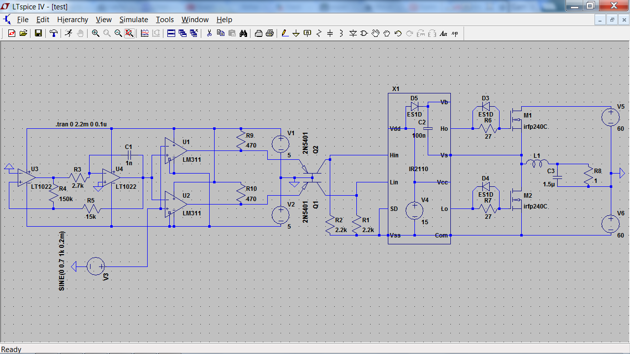

i wanted to use ir2110chip so that i can use irfb4227 n channel only fets +/-75volts full bridge. will the above dual lm311 work with ir2110 in ucd??😕
This one maybe, ir2110 chip need opposite fase input? now you need not two lm 311, I am not check that. A very fast comparator is a must for low distortion, also a fast integrator opamp with minimum 50 Khz bandwidth so feedback do have low propagation delay.

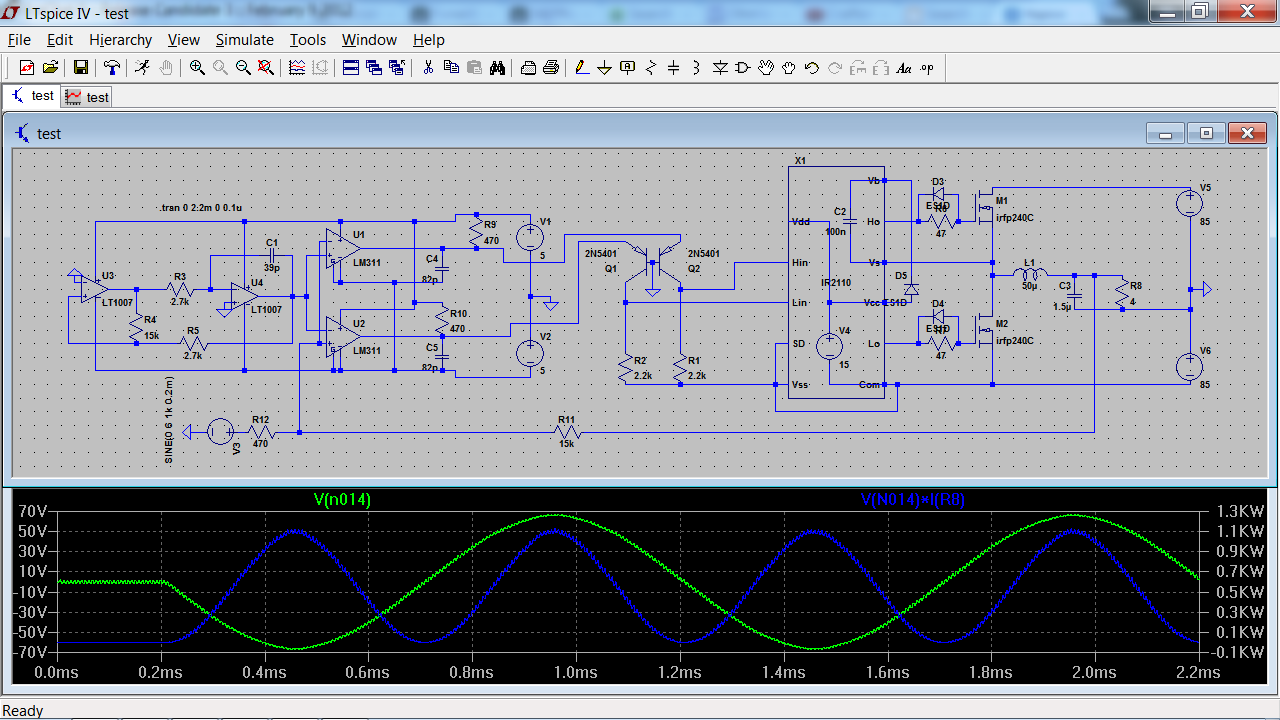

this one is quite simple, and has a power comparator , need a good pcb layout.
test with very high voltage output, but it do work on 2 x 30 or 50 volts, what I did is not right then I need to change the comparator value,s.
The output is -40 dB down Harmonics but output is then almost to rails, keep carrier quite stable in this fase shift type class D..

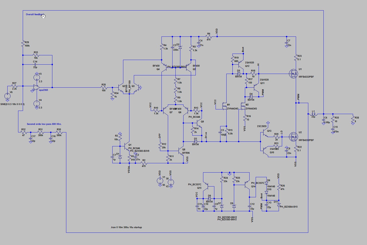

I just found this incidentally:
SOA:
Of course the IRFP4668 can handle more than 4kW, especially when used at lower frequencies. And of course you will find plenty designs that do not consider worst case situations and also no theoretical SOA check at all.
When looking to selfoscillating class D amps, then the critical situation will never be normal operation, because you only have the high currents at high modulation levels where you have low switching frequencies. This is definitely a very fortunate nature of the selfoscillating designs.
But when looking to the described worst case scenario:
-Output running into a shorted wire ==> i.e. 50m Ohms
-Input signal small, but enough to go for approx. 3V output into 50m Ohms
Then you will still have the high switching frequency and 60Amax and almost no rail sagging ==> That's the worst case scenario.
