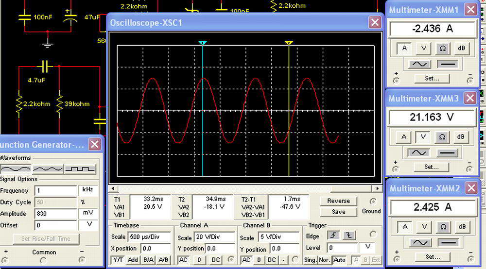

I will see if I have those transistors used.
If I have this, I would be able to sim
and get THD, Frequency bahavior and Fourier Analys diagrams.
I thought I had gotten the 2SA1216 + 2SC2922 spice models, today.
But when I tested 2SC2922 at 1 A bias
it shows 0.425 V base-emitter.
So spice model was no good - or does not fit for my MultiSim.

Simulator is a good idea, and lineup can use other transistors...respecting current
and voltage...and beeing audio frequency transistors...no troubles.
Simulator will show some distortion, for sure, as the unique amplifier that sounded good, not stérile, having complex circuit and low distortion was Symassym...the others i have constructed were not good.
Simulators have two problems...the first is that we have always to adjust something in real world.
The second, the main one, is that simulator is unable to tell us how the amplifier sounded...this needs humans listening.
But i will be happy to see some simulation too....but human informs, related audition, are more precious.

I made the simulation and some adjustments were made to increase the output voltage
The amplifier is linear related power from 20 Hertz to 20 Kilohertz.
Wave shape is fine.
Distortion simulations i do not know how to operate them in Multisim 2001...i will wait some kind friend to do this.
In blue you can see values modified during simulation, to correct the amplifier sensitivity and to increase power.
Tomorrow i will make those modifications in a real world testing.
In the differential, the trimpot was changed to 5K and the 4K7 series resistor was changed to 1K
The feedback resistor is now 10K
Stop resistors changed too.
regards,
Carlos
Wave shape is fine.
regards,
Carlos
