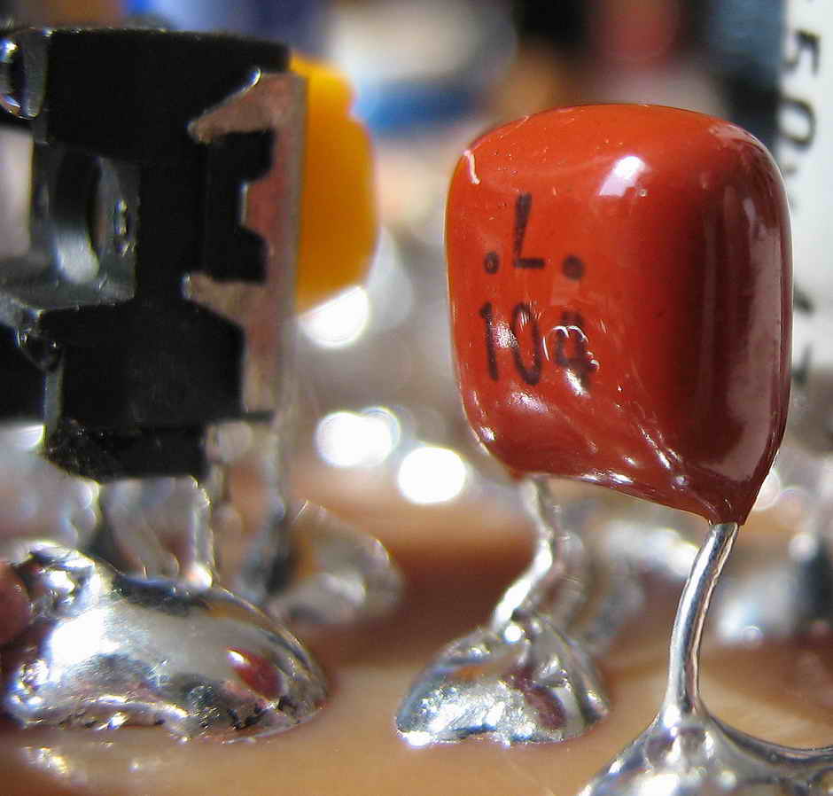

Negative...i am not so bad...images has less than 70K in average.
Bandwidth economy...more images using less data.
Image show that drivers do not need heatsink.... the choice of current was made thinking to avoid those heatsinks.
No heatsink needed represents less insulators, screws and all stuff..also you can choice smaller transistors, and those smaller ones can be selected to show better gain and lower noise....in special when thinking to the VAS.
