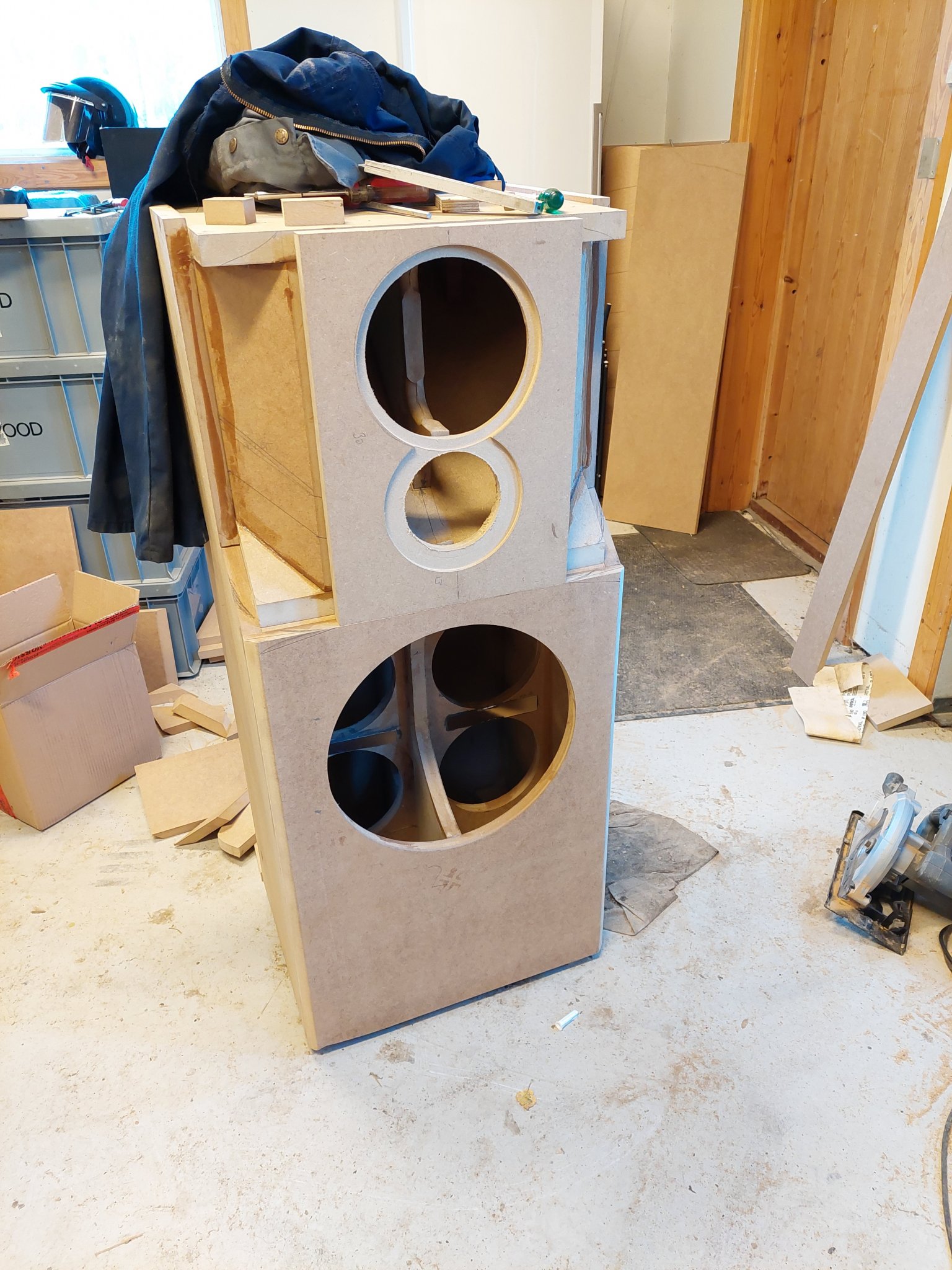

Progress is slow at the moment, but here is a small update with a picture. Have been thinking how to do the radius on the sides of the upper baffle, and I think it will be sheet metal bent over routed radius in the MDF and secured with screws, and the same screws should be used to secure the (removable) upper baffle. It's only placed there in the picture, not fastened in any way.
Taking my time, and trying to solve the problems one by one as they arise..
Did some CLD experiments with 0,5mm alu sheet glued with flexible glue (some of the alu-strips can be seen on bracing in the pic), but I was not too impressed with the result. Gluing alu to both sides of the MDF seemed more effective, but not something I would do on big cabinets like this . Tried a part of one side too, and compared to the other side of the cabinet. Nothing scientific though, just knocking test. The classic bitumen sheets seem more effective IMHO. When I did that in the past, I could easily hear the change in damping.
I have a feeling that putting some PVA glue on the braces (and in the holes) makes them stiffer. Sounds like resonance goes up in frequency on the braces where I put on some of the excess glue around the openings/holes. Same goes for the braces where I intend to support the magnets.

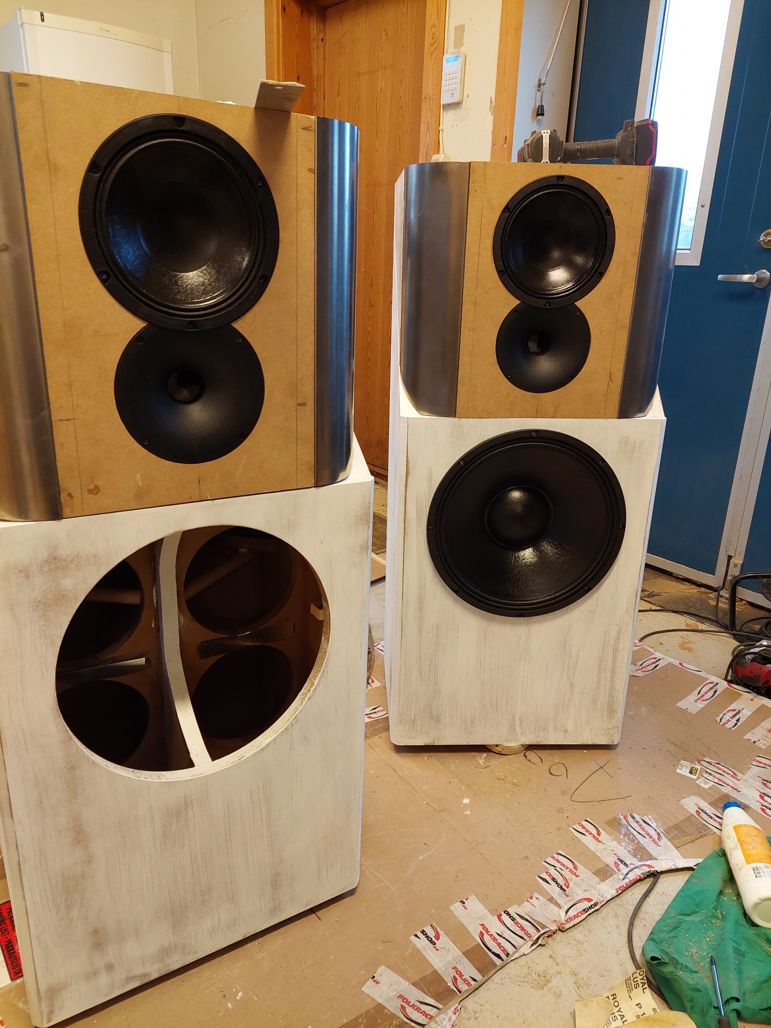

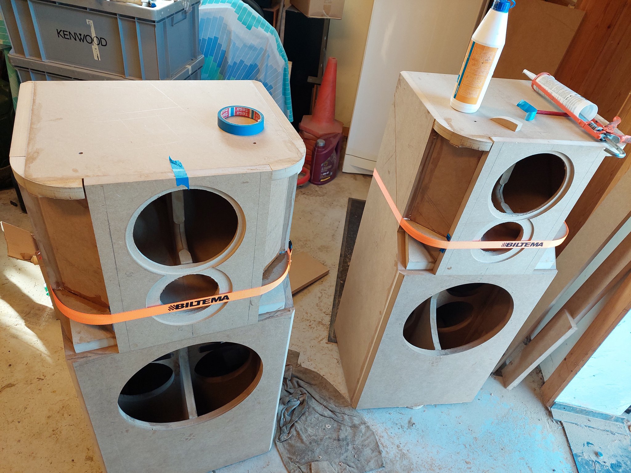

Some progress, but still no measurements..
Have put some epoxy-primer on the mdf, some more braces, some sheet metal on the round-overs etc. Trying to figure out what to do to get a more 'integrated look' between the upper and lower cabinets. The 'shelf' in the corners below the round overs disturb me a bit. I could add some chamfers on the lower cabinet I guess, but it also complicates things when I wrap them in vinyl. Another approach could be to just make some gigantic fabric grilles and cover it all up. Similar to this: http://www.troelsgravesen.dk/FUSION/fusion-6.jpg
I temporarily mounted the waveguides and drivers, and sat down and stared at them for an hour or so without getting any 'visions' on what to do, so I figured it was time to go home and sleep on it

You could also go with a less integrated look. You could accentuate the break between cabinets with a groove or paint the upper and lowers slightly different colors, etc. For something like this or the roundover idea, I would normally do multiple CAD models of various treatments to help guide my decisions.
I'll then typically mock it up in paper, cardboard, fome-cor, whatever's appropriate and fast. If you have a decent color printer at your disposal, you can print up whatever paint/vinyl colors you want and tape those on to quickly get a feel for that as well.

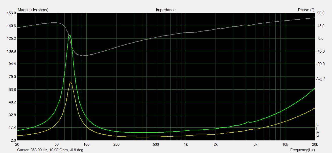

Another update with some progress, and some bad news..
I have made a jig to place the mid boxes on my gearbox lift, and today I started doing some impedance measurements, but to my surprise I found that the two mids were not the same.. Turns out one is nominal 8ohms, and the other 16ohms (also according to label on driver) I sent an email to TLHP where I ordered the drivers, I hope they have good customer support and take care of the shipment error.

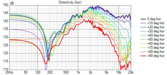

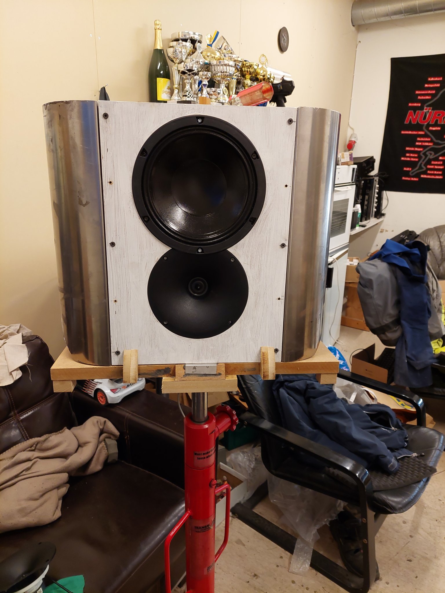

I have spent some time playing around with measurements and ''troubleshooting' today.
I have a step in the frequency response of the mid around 1,5kHz it dips down almost 3db. I tried playing around with the baffle, a separate cardboard baffle, no baffle etc, but it seems the 'step' is inherent to the driver. It smooths out more than 10 deg off-axis, so not ideal to EQ out either. I'm thinking it's either related to the surround or the plastic 'beauty ring' on the basket. I tried sticking some small pieces of butyl 'goo' to the surround and that seemed to smooth it out some.
The rise from abt 700Hz is baffle step, and the dive around 1.5k is the concern.
I was bit disappointing to find that after looking at Troels measurements and the datasheet, but it seems Troels applied significant smoothing to his measurement, and I expect the datasheet to be even more smoothed.
I played around with active and passive XO in vcad, and with this, and what I mentioned earlier, everything is pointing me in the direction of a fully active system..
Some pics attached
Tweeter is with simple passive HP, mid is without any xo

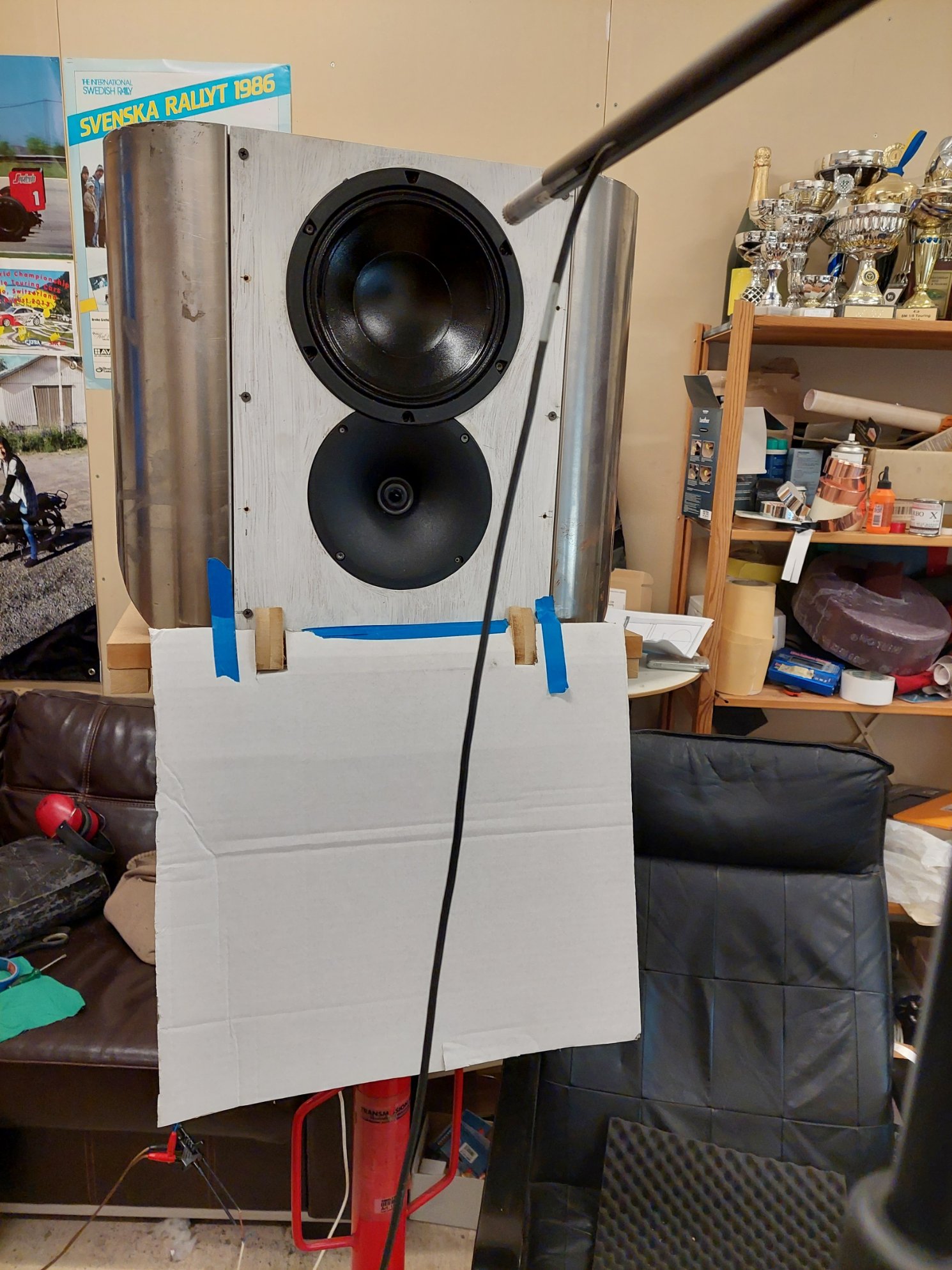

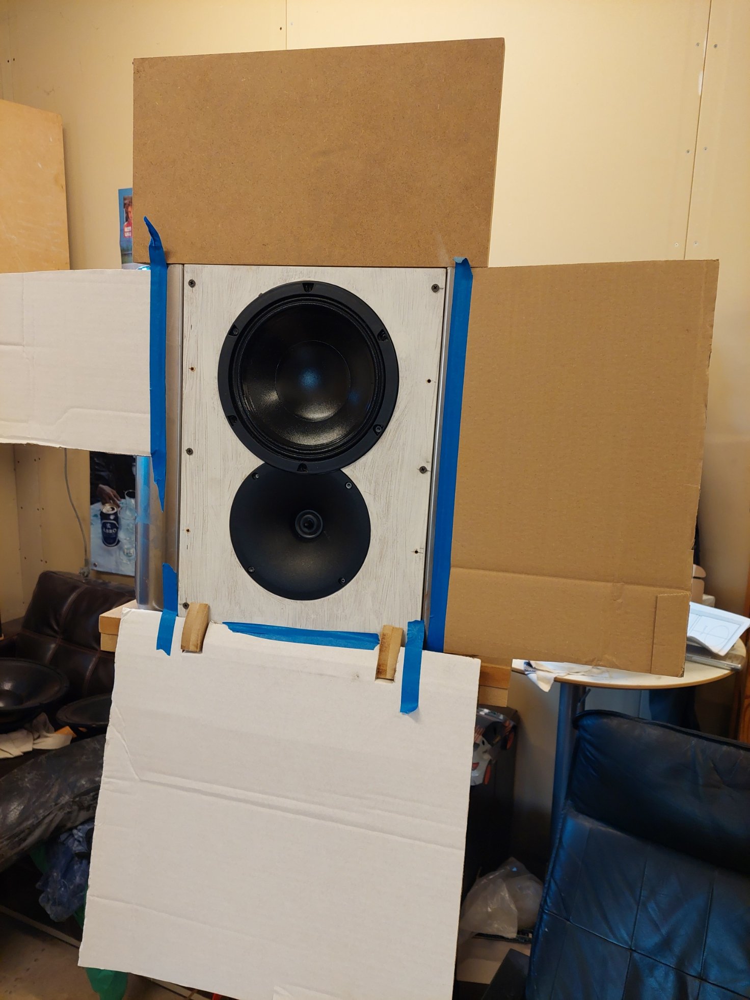

What is your measurement distance?
Is your gating adequate to remove all reflections from near items and walls/floors? If not, backing the microphone up a bit and watching the response trend can sometimes help highlight measurement anomalies that are reflection related. If the dip moves in frequency with microphone distance, it's not a driver issue.
Did you try backing up to 2 meters or so and measuring? Yes, it causes issues with gating/minimum valid frequency, but near measurements can induce there own set of errors.
On the flip side, did you try an actual near-field measurement (within about 1/4 inch of driver cone). It won't be accurate at these frequencies, but some dips and other things inherent to the driver and enclosure interior would still be there.
In your third image, is that just a flattener placed in front of your enclosure to eliminate the tweeter geometry or is something else going on?

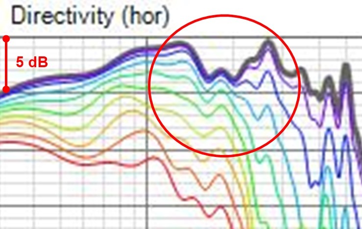

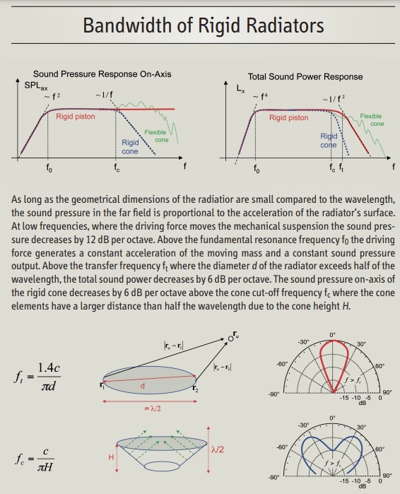

The axial dip around 2kHz in the mid is because of the cone being concave - wavelength- dependent phenomenom
https://www.klippel.de/fileadmin/_migrated/content_uploads/KLIPPEL_Sound_Radiation_Poster_01.pdf

Many replies, thank you, will try to answer them:
Seems like Juhanzi has a suggestion why! Any suggestions on what I could try to actually verify that theory? However, to me it seems like the text would explain the directivity, and dropping off off-axis, but not the dip on-axis and smoother off-axis around 1,5k. The deep off-axis dip around 2.5k looks like that IMHO.
What do you think about the plastic ring on the basket? It's abt a 5mm deep 'cylinder' around the edge of the cone.

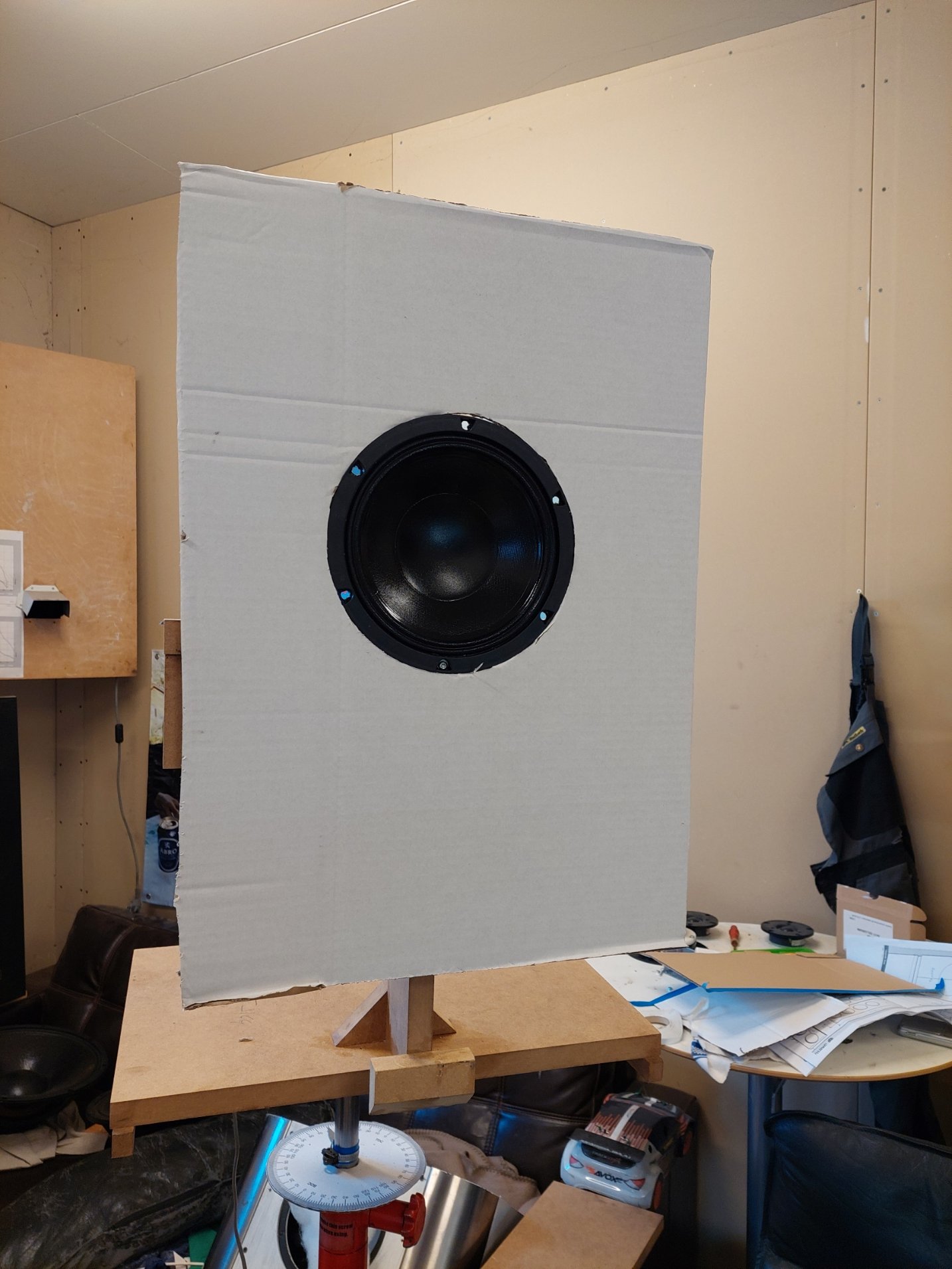

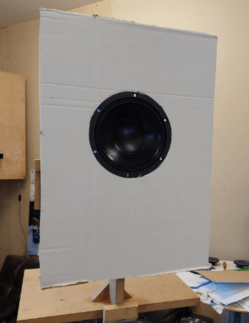

It's just the bare driver with a carboard baffle on it, I wanted to eliminate the possibility of issues with my baffle/enclosure. The 'dip' was still there.In your third image, is that just a flattener placed in front of your enclosure to eliminate the tweeter geometry or is something else going on?

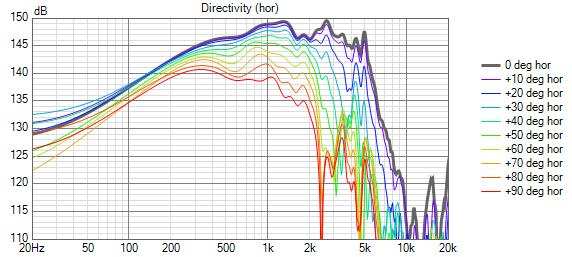

It's not 100% flush, the plastic frame on the basket sticks out 1-2mm from the baffle. This is one reason why I tested with the cardboard baffle, that was flush with the driver, different size etc, so should not do much that high in frequency,A question, the response measurement mid-directivity was that without any make-shift additions?
If so, the mid does not look flush mounted. Quite sure that causes the huge dip following the baffle diff bump.
I'd probably start by measuring the depth of the cone to see if the math is in the ballpark.Any suggestions on what I could try to actually verify that theory?

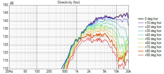

That response looks to be quite consistent with angle, if you look at the normalized graph it will show where there are areas of uneven directivity.The rise from abt 700Hz is baffle step, and the dive around 1.5k is the concern.
It looks quite normal to me. Remember the scales make things look very different. Vituix is quite squished up which makes things look bad, Troels does it the other way and stretches out the frequency scale. If you did the same much of the differences appear to vanish.
For an example look at the Purifi datasheet, the top graph is stretched out and makes the breakups look quite mild, then further down there is a square looking off axis graph where it makes them look much worse, except they are the same thing.
Maybe I'm obsessing about it, but I was expecting a smooth driver, and IMO it's not very smooth.

Scale... 20¤ off-axis is pretty smooth. With no-baffle this phenomenom is exaggerated! Similar thing happens with deep waveguides and horns tweeters.
