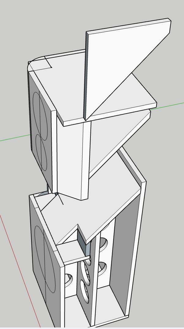

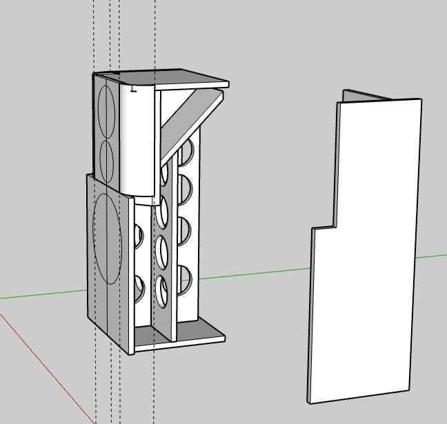

I have been wrestling with sketchup on and off for the last couple of days. My skills are improving, but there is still a lot to improve.
Below are two versions. One 'simpler' with everything in one box, and one that involves a bit more work and parts that is split in two.
I have gone with 22mm MDF, since that is what seems to be readily available around here. I have some braces in there, but thinking I might try some CLD too.
There is more than one sheet of MDF needed for each speaker, even the simpler one. Measurements are H100cm(+2.2cm on the 2-piece version), W50cm, D45cm
I have also gone with the wide and rounded baffle concept. I'm thinking the rounded shapes will be some sheet metal or pipe sections. Behind them are 45deg 'slants' in the baffle, so the radius is just a 'stick on part' for diffraction.
Comments from the experienced builders?

IMHO at this scale, there is huge benefit to doing active XO, at least for the low/mid. If you don't, you need large and expensive inductors which are either lossy (air cored) or have non-linearities (iron core). And since you're doing active, do it all active, since who cares about a couple extra channels in the amp box? The mid/high channels need very little power compared to the bass channel so can be very compact.
Using a PC for a crossover is possible but an awful hack. IMHO you will regret doing that for anything except testing purposes and the selection of crossover parameters.
I think you should try an off the shelf DSP, even though it does include an extra DAC/ADC stage. Yes, it is worse in principle than doing it all digitally before the first DAC but the loss of quality is less than what you will face just from the mechanical limitations of pretty much any speaker, and far better than the issues of using a passive crossover at any point! You can start cheaply with something like a Dayton DSP-408 and consider an upgrade to minidsp or whatever later. Latency will not be a problem because you would use the DSP (even if it's only two-way) for both sides of the LF/MF crossover point, so there will be no induced phase error. Or just use the one DSP for all 3 outputs.
If you want to go all analogue, I can sell you a PCB for a 2 channel 4-way 4th order Linkwitz Riley crossover with BSC and APF compensation - or you could design your own pretty easily; the schematics are all pretty textbook and PCB manufacture is incredibly cheap these days. Mine is 100x100mm and uses SMT passives plus 18 dual-opamps. Probably noisier than a DSP with the extra ADC+DAC stages unless you buy super-expensive opamps but if definitely won't have quantisation noise at very low signal levels.
I see you have purchased the 15NMB420 already, but they are midbass drivers. I don't think they will give you the low end punch you are probably looking for. You need really strong response and phase linearity in the 40-100Hz band.
22mm MDF is very heavy. It's probably appropriate for the front baffle with your 15" but total overkill elsewhere, especially for the mid/high cab which will not see significant pressures. Everyone else uses 19mm. You get better performance from proper bracing design than thick walls.

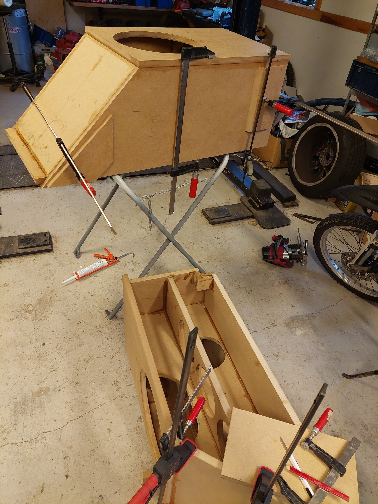

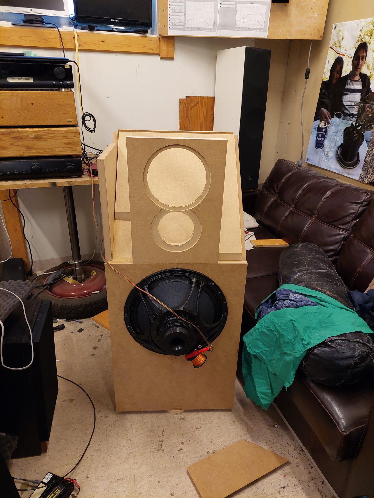

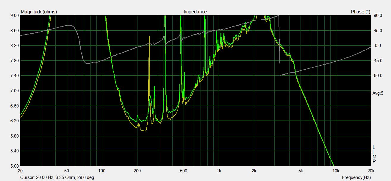

Some progress to report from the garage. Both bass boxes are now assembled. I mounted a woofer with magnet out to do some basic 'resonance hunting'. I confirmed my suspicion about the basket resonance on the woofers. The light neo magnets and pretty skinny frame gives a resonance around 250Hz. It can be felt when I put my hand on the magnet while music is playing, and I could feel it was strongest when feeding a 250Hz sine to the speaker. I also ran a impedance measurement comparing 'free resonance' and when I pushed my hand against the magnet. Picture of the impedance below. Clear difference!
The rest of the peaks are most likely from box resonances, since there is no stuffing in the box. They are not visible with the driver in free air, same goes for the basket resonance, since the spring(basket)/mass(magnet) has no 'termination' when not mounted to the box.
I think I will try to damp the basket resonance with some elastic glue on the bracing, so the magnet is pushed against it when the woofer is screwed tight to the baffle. Basically 'squeezing' the magnet against some elastic glue. I know it could be done better, but since a friend convinced me it would not be needed, I did not prepare for a better way before I glued everything together. Maybe a softer 'termination' between basket and box could do something too, I usually use some 'memory foam' gasket there. Some experimentation still needed I think. Not sure about the audibility of the resonance, but since I know it's there..
I have played some full range music through the woofers while trying to find panel vibrations, and the box feels pretty good. Sound coming from the woofer is relatively pleasant to the ear too, which corresponds to the claimed smooth frequency response.
The coil on the woofer in the picture below was a temporary test too. Upper baffle placed there just to get a first visual, and maybe some ideas on what it will look like.
Will start on the mid/tweeter boxes later.
