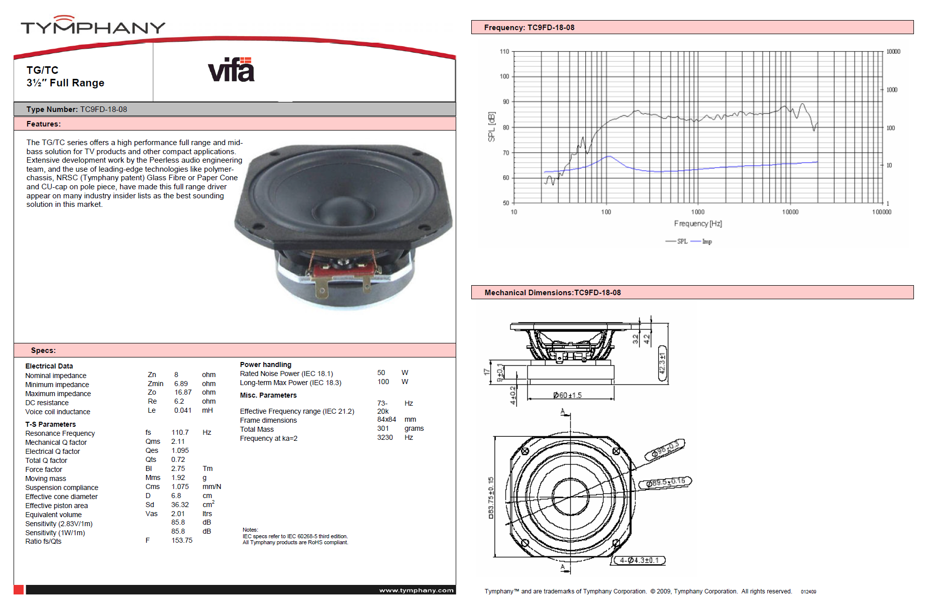

The reason why I am asking is that I doubt that such a tiny driver can receive 30 watts continuous...
It's spec is (un)clear about it, it's obviously not measured over 20 Hz to 20 KHz.
Rev 1.0 from Tymphany (10 sept '09) datasheet says: 5 watt over 120 Hz to 10 KHz 12 dB crossovers (IEC 2685 18.1)
Rev 2 from Tymphany (18 jul '12) datasheet says: 30 watt from 100 Hz to 20 KHz 12 dB crossovers (IEC 2685 18.1)
Rev 3 from Tymphany (28 apr '15) datasheet says: 30 watt from 100 Hz to 20 KHz no mention of IEC spec.

Those data seems to differ a bit between the various datasheet versions released over the years, have datasheets from 2009 where they branded VIFA and while power handling for both models was at 30W, TC9 had only 1,50mm Xmax where TG9 had 2,35mm.
Attached below is new version where they branded Peerless and Xmax is now 2,6mm for both models, efficiency is closer than ever, but TG9 have 5W lower power handling.
In a ~2L cabinet the TC9 is very much x-max limited at about 15W even on the more generous 2.6mm spec.
If you put it in a very small cabinet then the thermal rating could be more relevant, or on a horn like Art did.

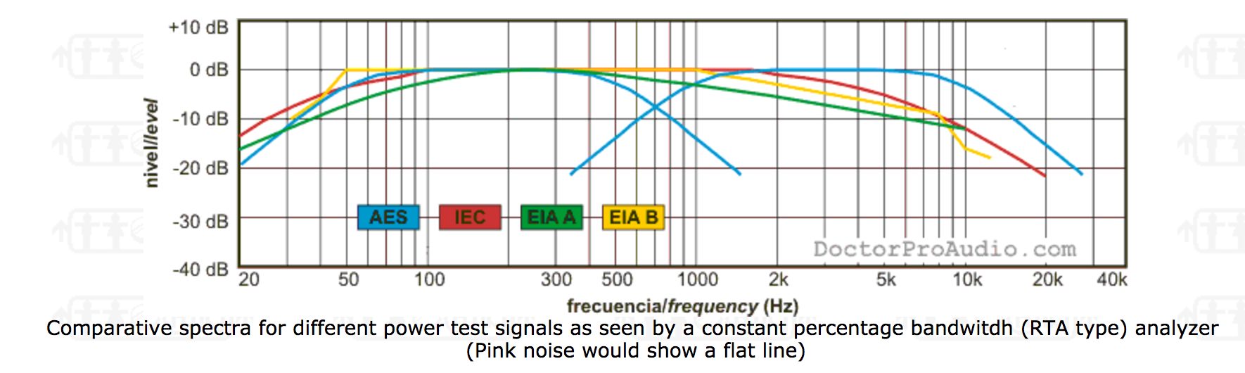

So hard to know what any manufacturer spec means as there are so many different 'standards'.
The latest TC9 sheet lists Rated noise power which should mean
"2.c. The IEC268-5 (1978) standard
This is a standard by the International Electrotechnical Commission from 1978 and reaffirmed in the eighties. It specifies a 6 dB crest factor pink noise signal over which an IEC programme filtering has been applied. This programme spectrum tries to approximate the frequency content of real music, and shows reduced lows and highs. The illustration compares this spectrum to the AES ones. The terms "Rated noise power" and "power handling capacity" are used.
Test duration is 100 hours, after which the speaker should not show appreciable damage.
NOTE: To make matters more confusing, there's another 268-5 standard from 1972 that specifies a different signal spectrum and time, but this is rarely used"

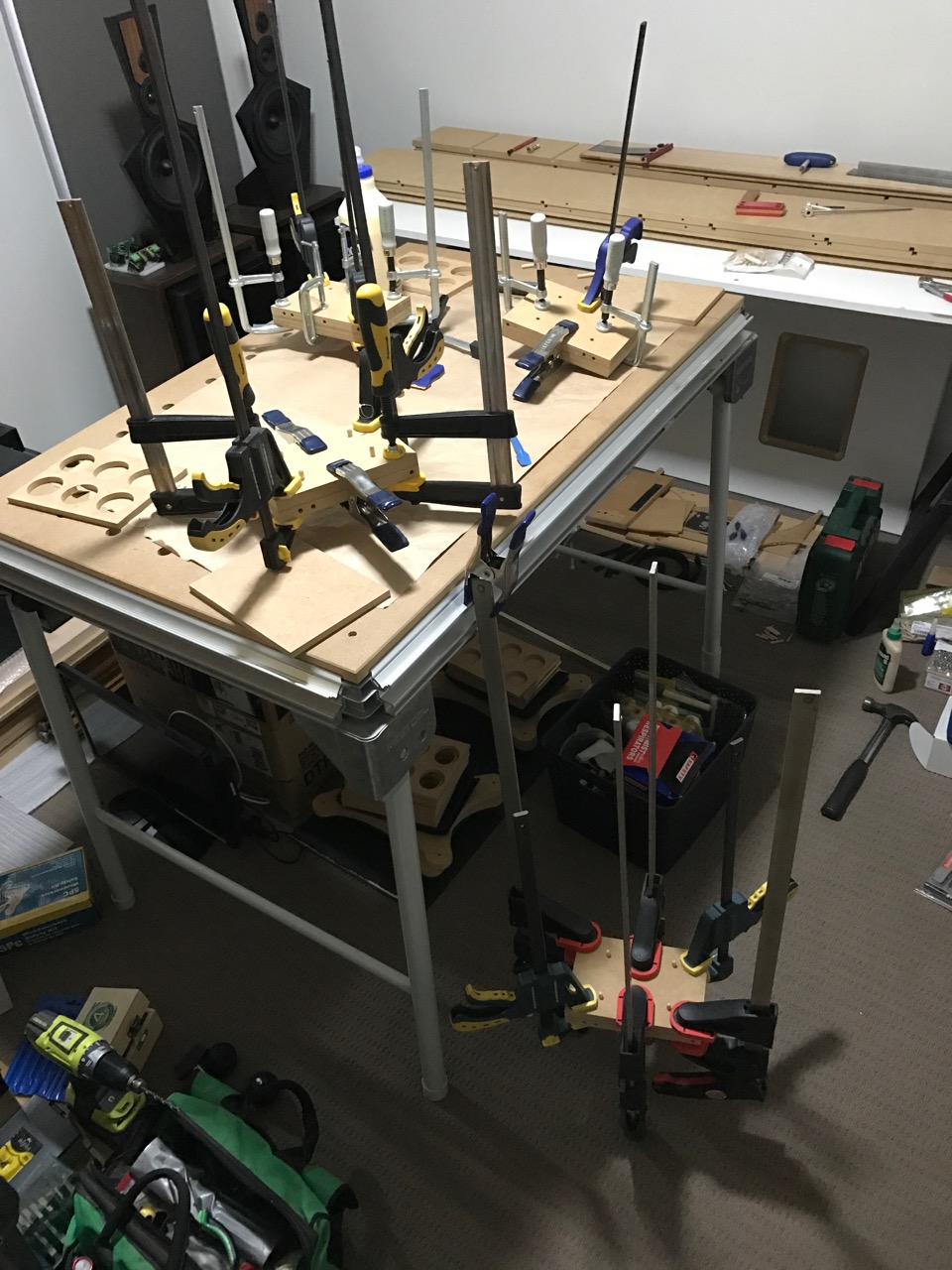

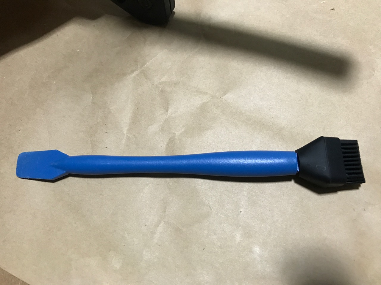

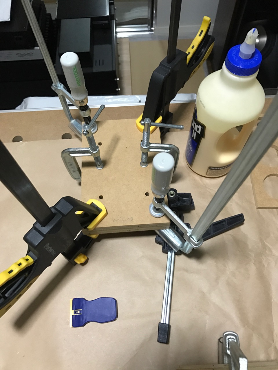

More progress
It turns out that you really cannot have enough clamps!
A silicone glue spreader is a very good accessory to have when gluing panels together.

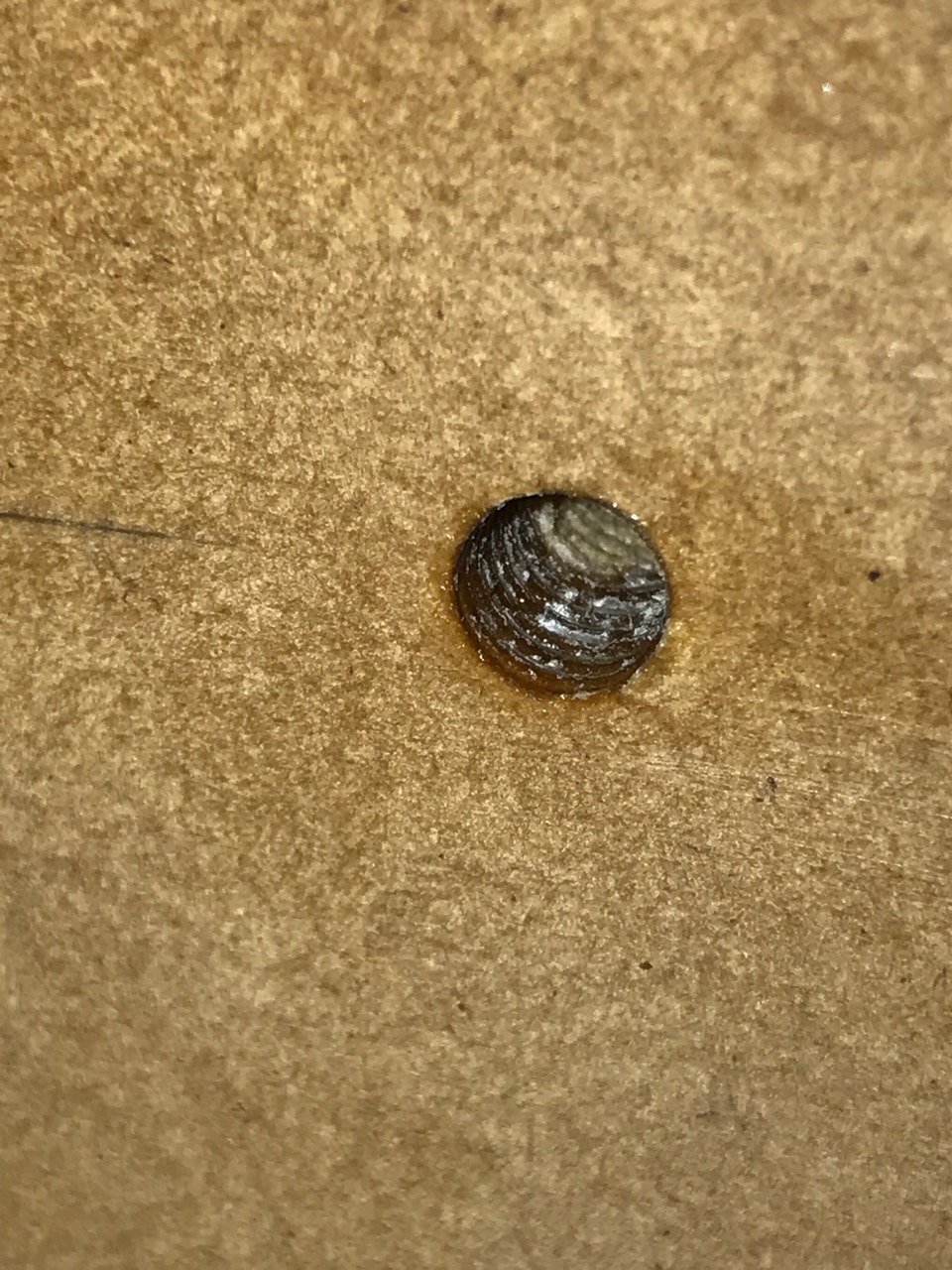

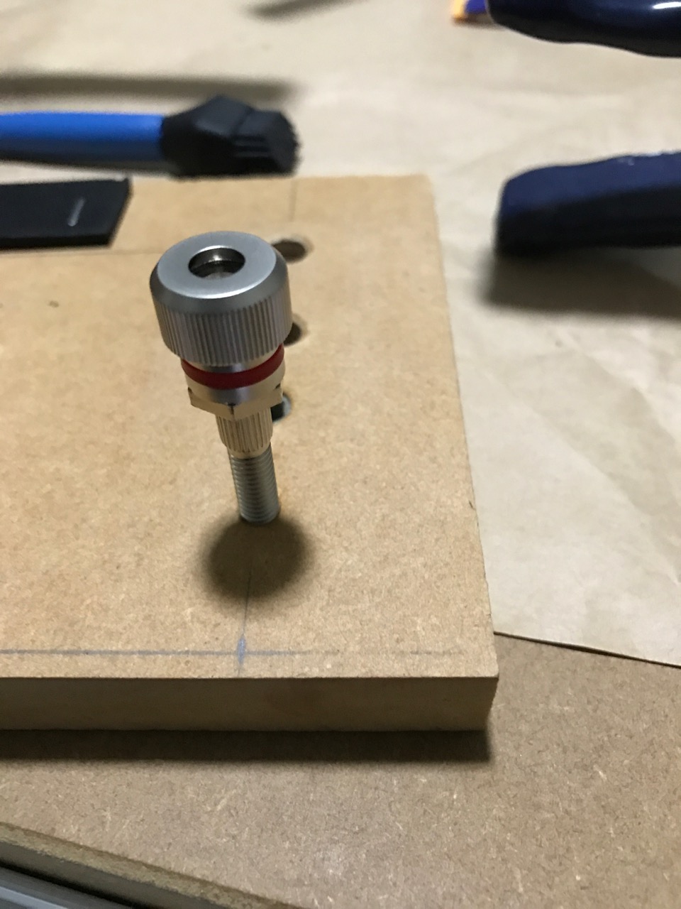

I made a test to tap the MDF for installing the binding posts. With some superglue added to strengthen the threads I needed to use a spanner to get more than halfway through the thread, very strong indeed. I think I will re-tap after the glue to make it a bit easier to install in the final panels.

Thanks, your build was very impressive! I think I read that you sold them afterwards. Was that due to not liking them or some other reason?
Good to hear that the glue is strong enough. I think clamping might have been a bad description but I still think that the outer baffle with the damping in between will help to support the drivers a little and put less pressure on the glue joint.
I am always sceptical of glue only as I have had a number of glue failures in odd points over time particularly with construction adhesives. They are great initially and can't be pulled apart without a lot of force but over time this changes and sometimes the joint just pops apart.

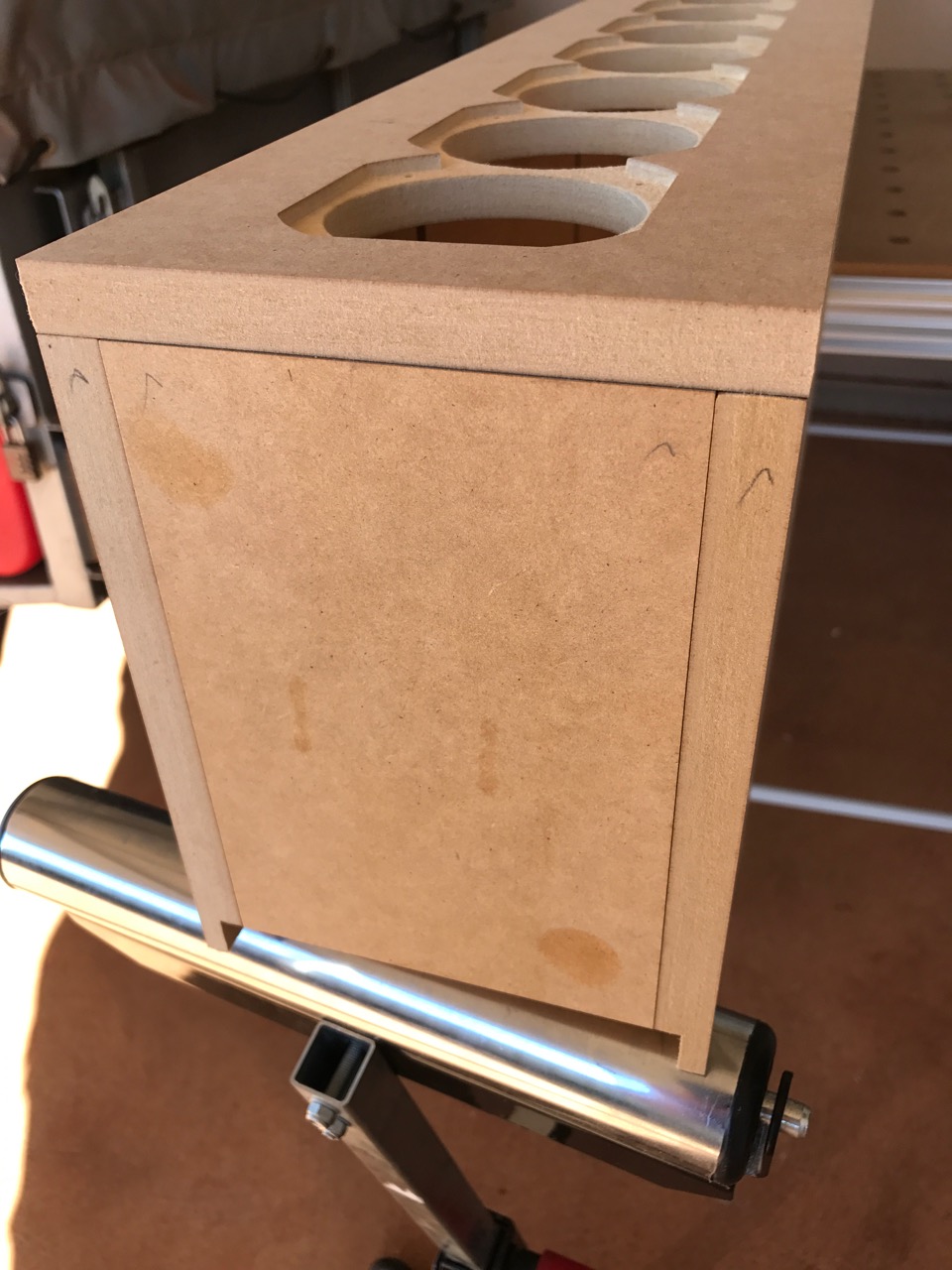

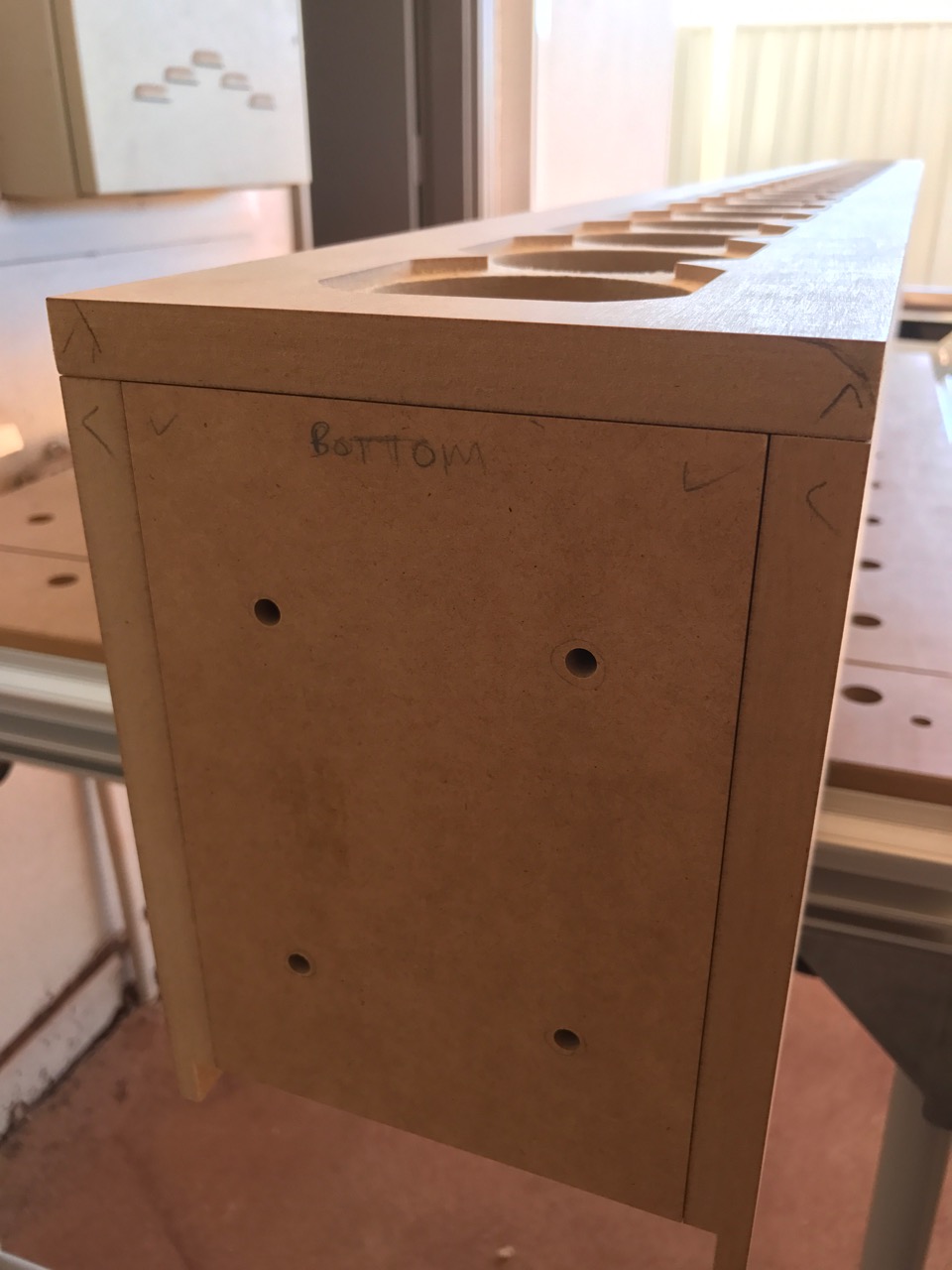

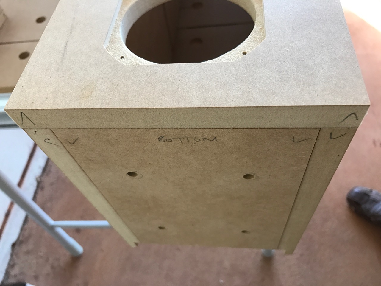

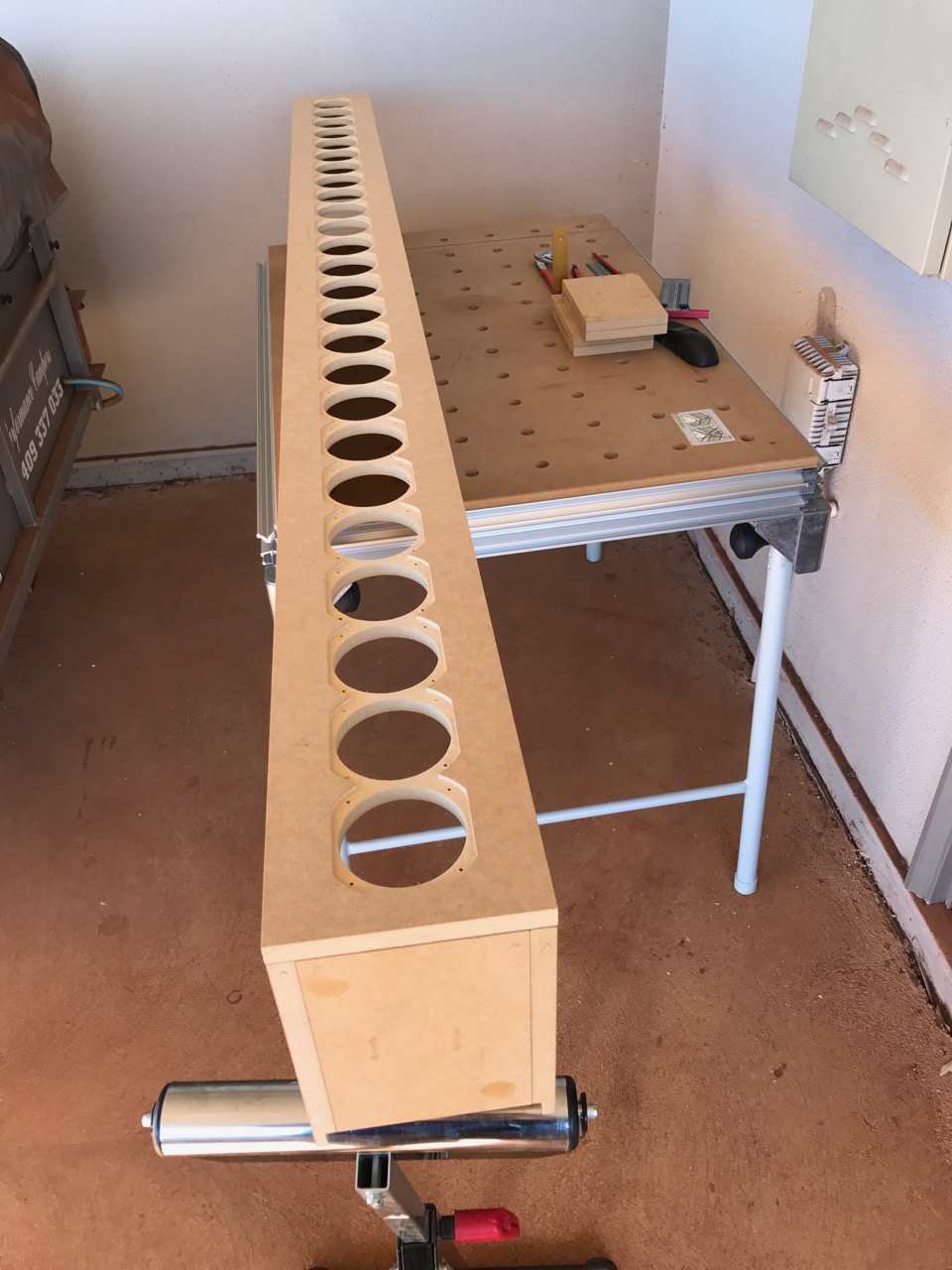

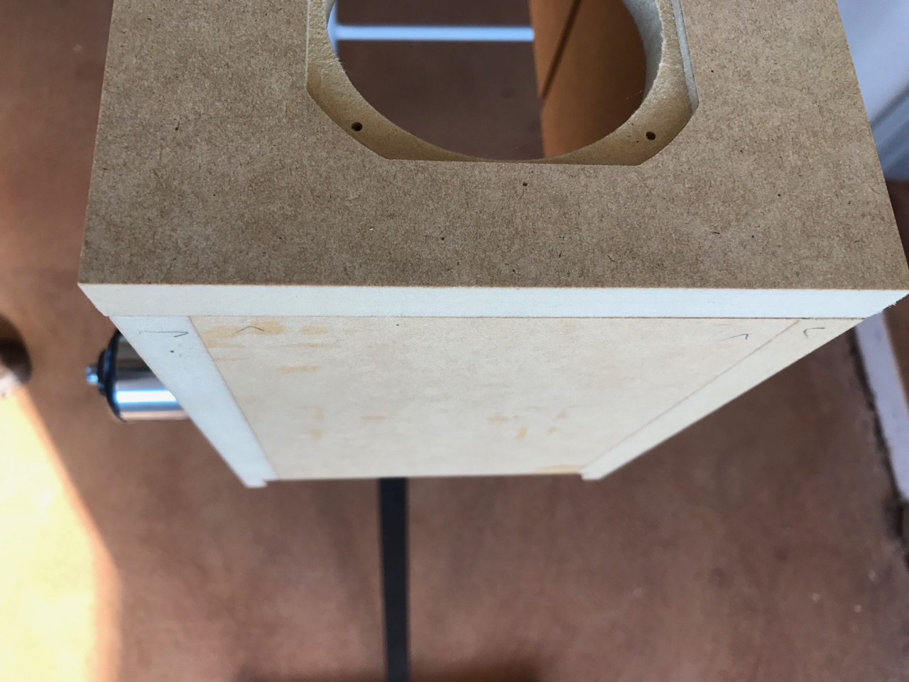

Enclosure dry assembled with dowels
When gluing one of the bottom pieces I only used two dowels for alignment on the first one and it ended up not quite being square. A few minutes with a block plane made it flat again but the slight difference in size caused a slight mismatch in alignment on that tower. I will need to see what I can do to bring it all back together a bit better.
The second one is almost perfect considering it is held together only with a few dowels.
