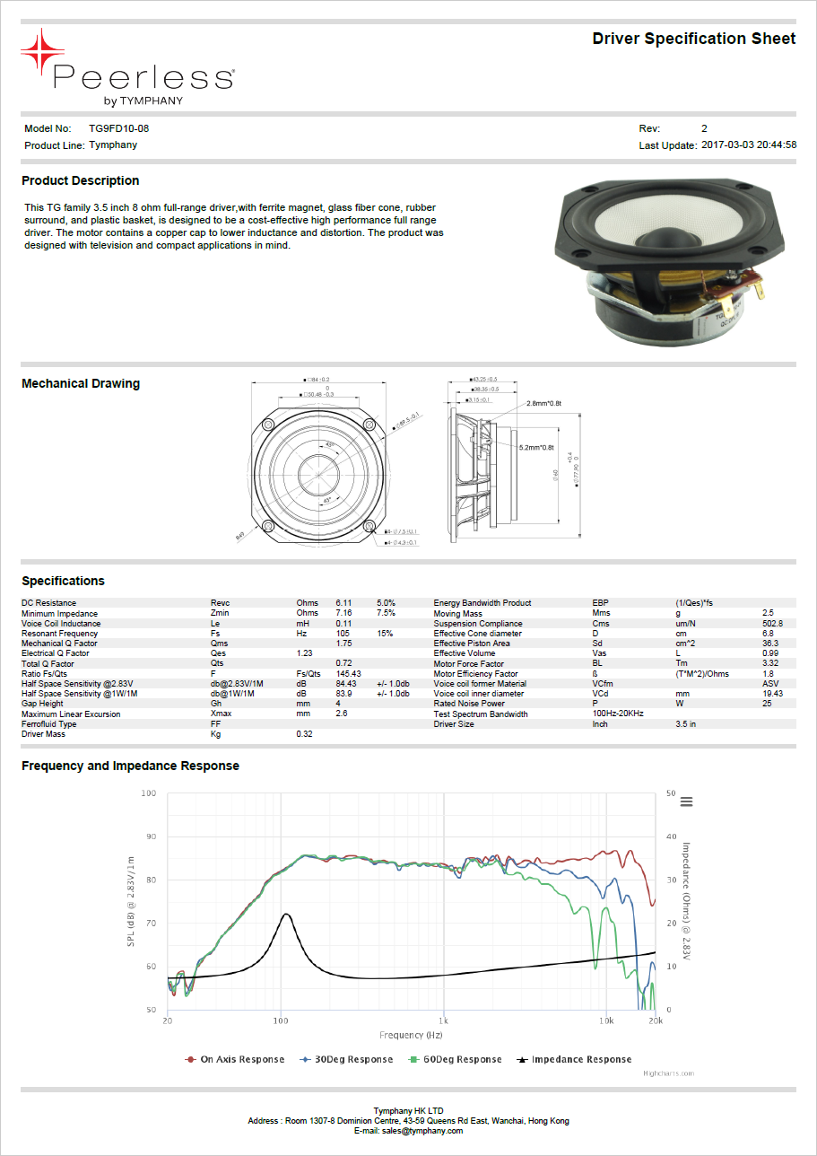

Anybody interested in a group buy of the ultimate Vifa/Peerless/Thympany driver TG9FD10-08 .
Price around $6 but there has to be many interested as minimum number of drivers for that price is >2000 pcs.

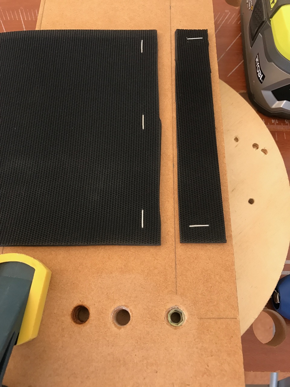

Due to a chronic lack of sleep and 40+ degree Celsius temperatures progress has been slower than normal but there has been some.
The rubber has a slight curl due to being rolled up for a number of years, unrolling and applying weight has made it better but there is still too much for it to just be glued down.
Staples seem to hold it quite nicely and should stop the curl from pulling the glue away over time.

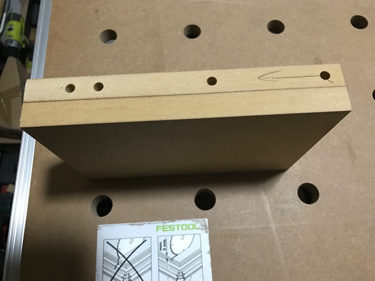

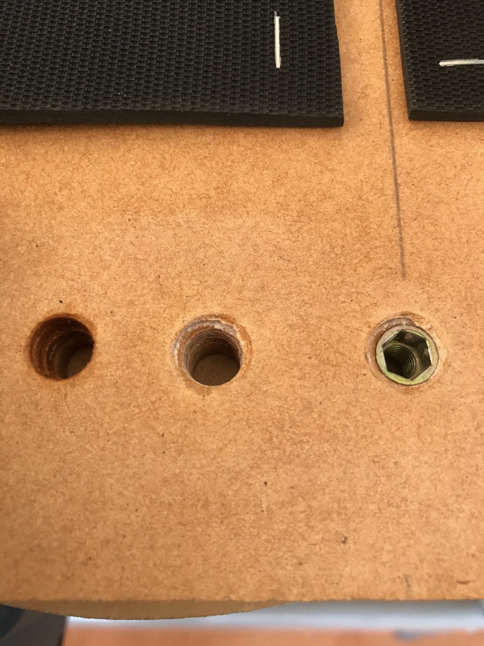

I made a few test runs to find the best way to mount the threaded nuts in the MDF as these will be holding the whole thing up so I don't want them stripping.
The two on the right I used an 8mm pilot hole and countersunk the edge as the wings on the nut were lifting the MDF at the surface.
The one on the left has an 8mm pilot hole with a 9mm one for the first few mm. This gives enough clearance for the body of the nut without lifting the top layers.
I have used superglue to harden the threads after the nut has cut them. This has worked better than I expected and the nuts go back in very tight and feel a lot more secure. You can see the one on the left is still wet and the two on the right have a white look to them where the thread has recut.

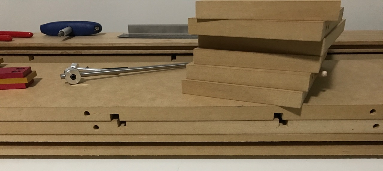

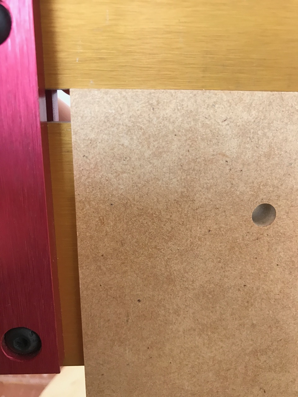

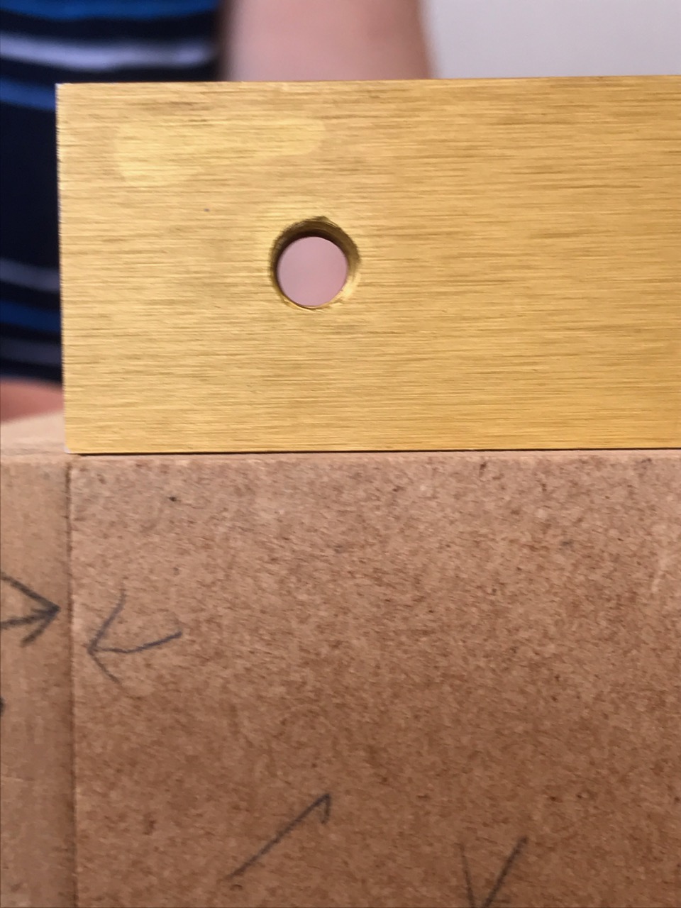

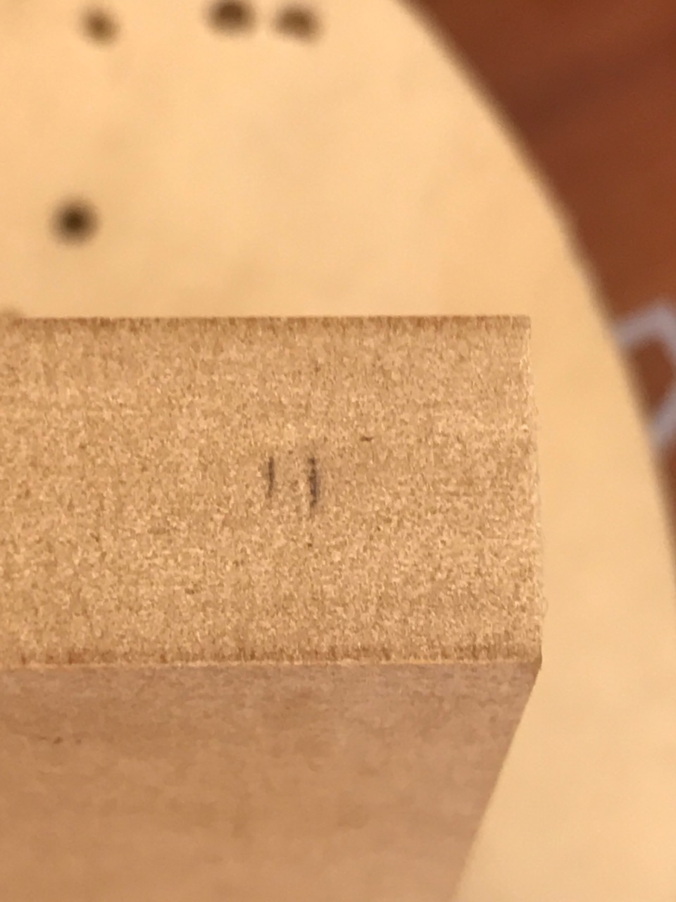

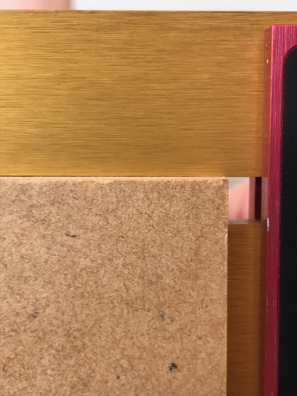

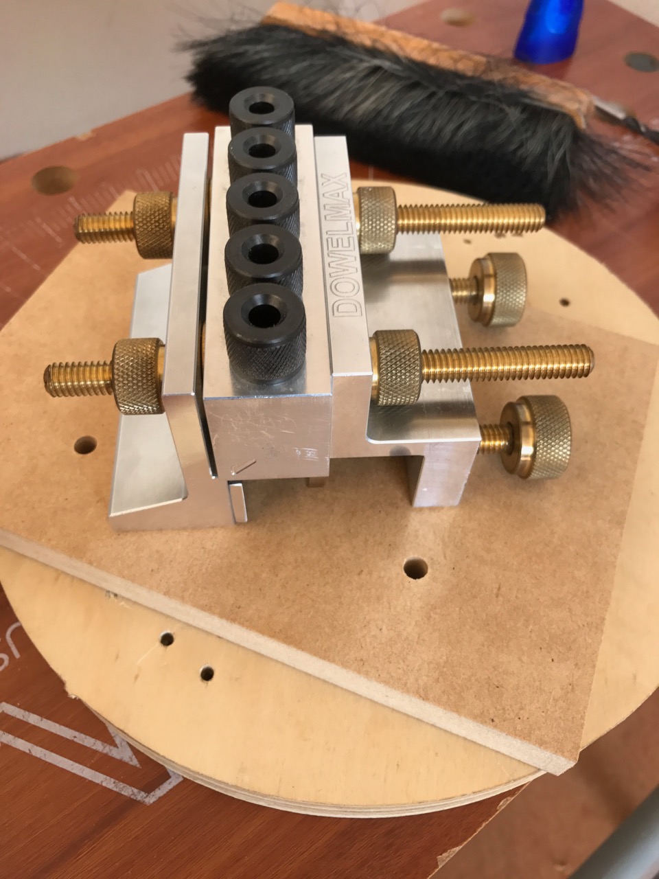

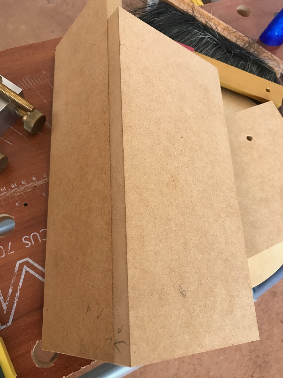

I have got my Dowelmax out to cut dowel holes to assist with alignment and gluing. It is setup for 5/8" material so as long as I am careful about matching the faces together the slight difference doesn't matter.
I dropped it and was worried that it wasn't perfectly true anymore. Glad to say that it is still accurate. In this picture the block was flipped end to end and there are two marks from a transfer punch in between the pencil marks, pretty hard to pick them apart.
The CNC cut parts are very accurate and completely square which is important for the jig to work at it's best.

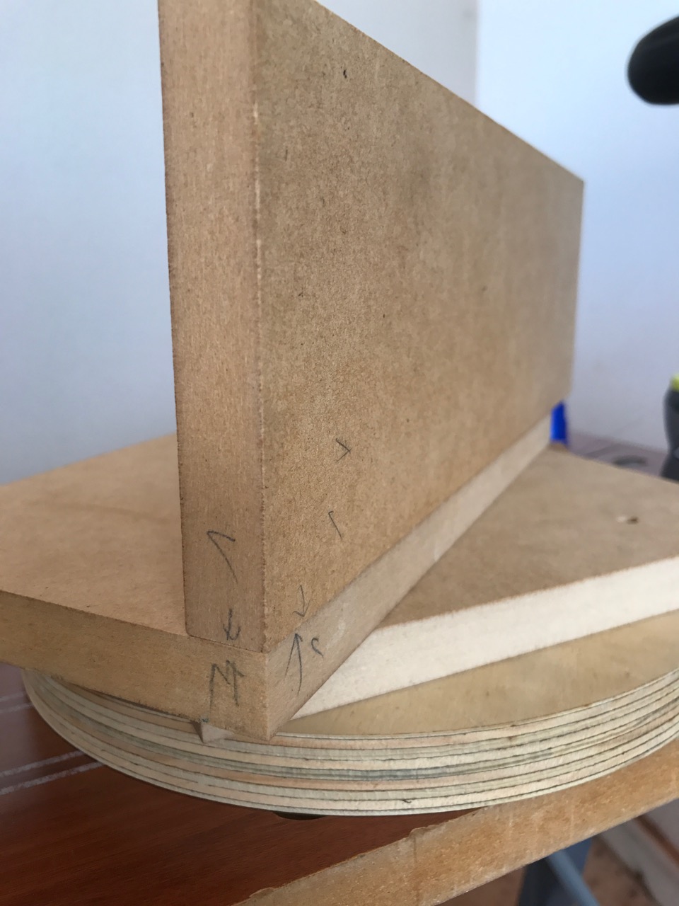

My test pieces have gone together quite well but there is a slight gap which gets longer over the piece.
These test pieces are not accurately cut enough to work without this error creeping in.
Square at the corner but not all the way along.

I've got Selley's 3 in 1 Silicone adhesive / sealer. It would likely hold it down but for how long is the question. I don't want to find them floating in the cabinet in a years time and have to take it all apart again.
As the rubber is curled the material wants to move that way. It will be easier to staple it down as that will hold it to the MDF while the glue dries and relieve some of the tension in the material. As you can see in the picture the staples really help to hold it nice and flat.
I am only using the one layer of rubber and it is more for mass and not really intended to be a constrained layer. With the silicone glue layer and limited direct connection from a few staples I hope it will still have a small lossy effect.
I would probably use a few staples to assist the MLV or Dynamat as it is quite heavy for it's size and vertically mounting it will put more strain on the pressure glue. Apart from the foil MLV and Dynamat are pretty much the same thing why a lamination of the two?

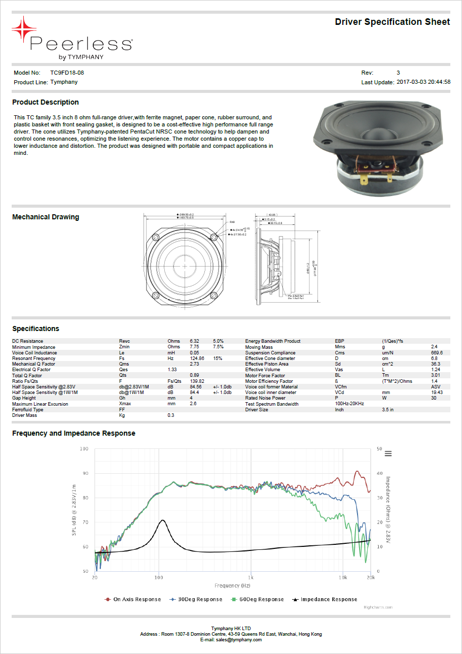

Those data seems to differ a bit between the various datasheet versions released over the years, have datasheets from 2009 where they branded VIFA and while power handling for both models was at 30W, TC9 had only 1,50mm Xmax where TG9 had 2,35mm.
Attached below is new version where they branded Peerless and Xmax is now 2,6mm for both models, efficiency is closer than ever, but TG9 have 5W lower power handling.

I think I have at least 4 different versions of that datasheet of the TC9. 🙂
I chose paper, but I don't think the differences would be big after DSP FIR correction.
The power handling is a hard part to interpret. I've seen many numbers fly around. In these arrays they can handle a lot of power though! But x-max will be a limiting factor at the extreme low end. The different cones can make a difference in power needed. For instance an array of Scan Speak 10F's could produce the same curves as the TC9 array with only 70 watt, while the TC9 array would need 240 watt.
