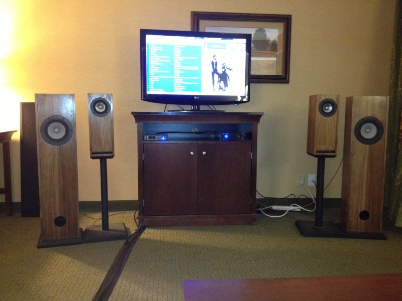

This is the first chance I have had to compare the A7.3 against the A12P in the same venue. This is the setup in Room 217 at LSAF. (Y'all come down tomorrow!) The A12P absolutely smokes the A7.3 in every way. It is cleaner, clearer, goes higher, goes lower and is more dynamic. I used to love the A7.3's. They were the best I had ever heard. Until the A21P's. For sure I will get a pair of A10P's when they become available.
