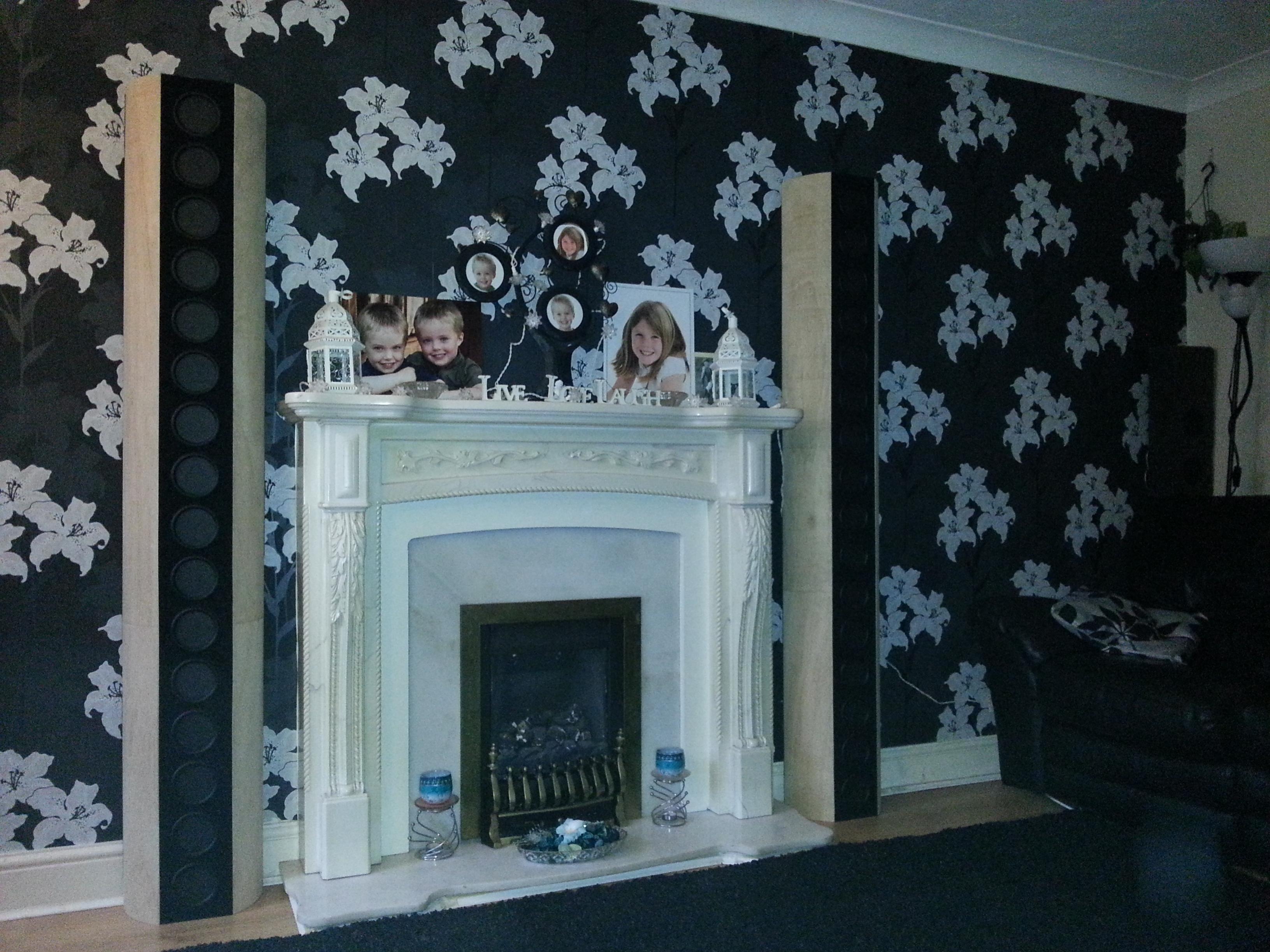

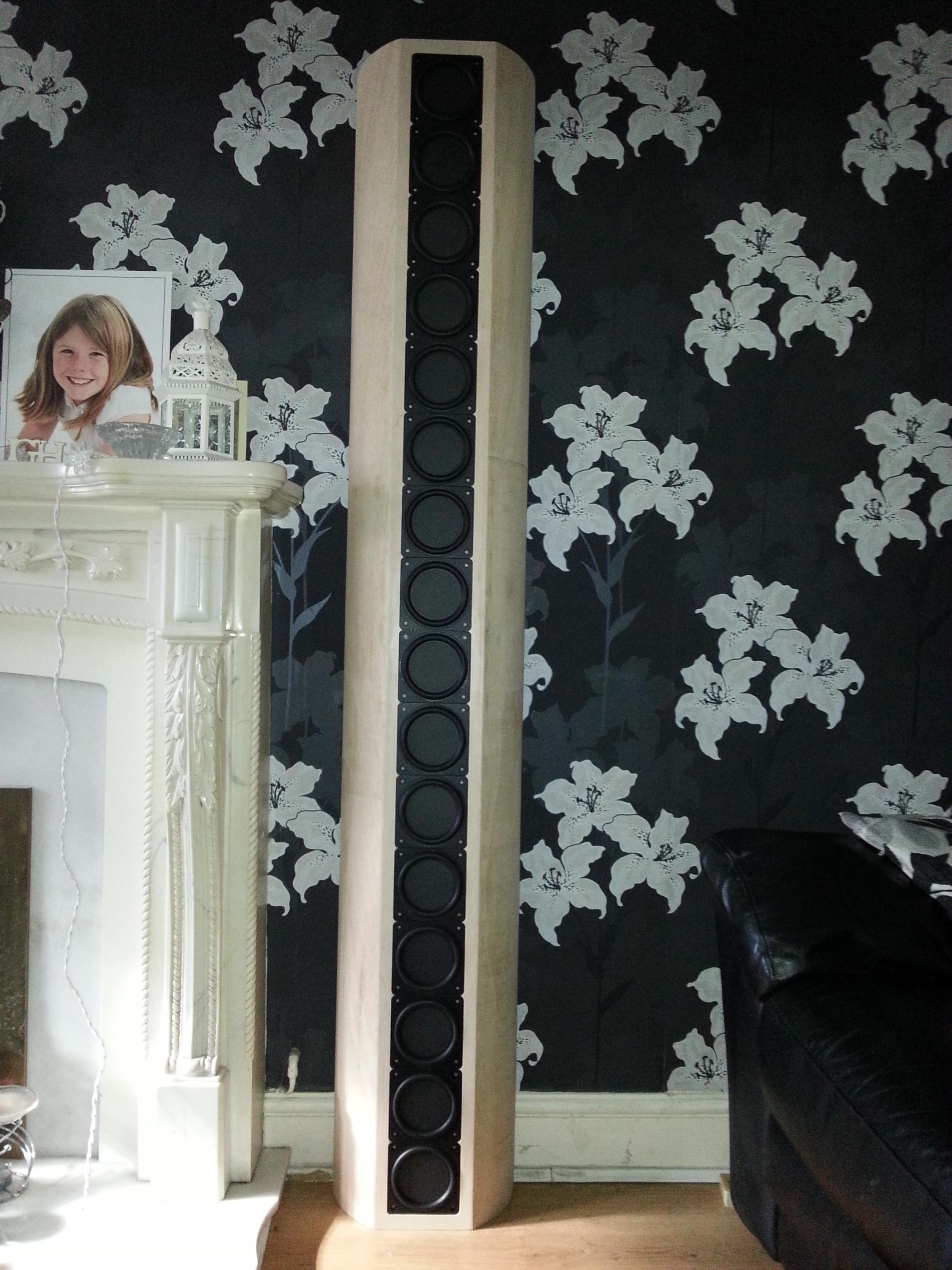

Multiple driver inductance
Hi Doug,
Thanks, yes my daughter is a real cute kid, her twin brothers are cool dudes too...Going to be a bit crazy round here when they are all teenagers...Gulp!
Re driver inductance, basically its not a problem, in fact using multiple drivers gives you a much cleaner and more open top end ( and midrange too).
It sounds even more extended than a single driver, but measurements show no real difference, only tiny plus or minus driver tolerance variance.
The reason the mid and top sound way better than a single driver is that the each cone in the multiple driver speaker is only moving a fraction ( a sixteenth in this case) as much as a single driver cone would for the same SPL.
This basically eliminates all the problems that single full range drivers have such as : no percussive impact, no bass, high distortion at any decent volume, confused and muddled sound with complex music...etc. etc.
Traditional line arrays have their own problems, esp. two or three way arrays using separate lines of tweeters, bass mids and or woofers. The crossovers can be a real nightmare, and both horizontal and vertical interference can be problematic as well as off axis lobes and rear wall bounce.
Also fake or " mini arrays" i.e. 3 or 4 feet lines of drivers which are the worst of all worlds, wont bore you here but suffice to say you are better off with a good old 3 way rather than a pint sized array.
Hope this helps and all the best
Derek.
