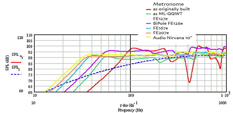

I have continued to read about these type of speakers and came across an interesting post. you willhave to look at the pic if you have not seen it before.
Hi Guys
I just been reminded to explain the reasons for much of my tweaking. Sorry this is quick, time is short but briefly........... See - graph - green areas marked 1,2 and 3.
1 - the +dB hump helps to off-set baffle step losses. Less correction (if any) is needed when using my drivers that have this feature.
2 - Lowering the output in the mid range helps the reduce "shout" and "sibilance. Vocals benefit with more balance. In particular, I can't stand vocal sibilance...sssssss. Drive's me nuts so I tweak driver output in this part of the range to help reduce the phenomenon.
3 - Rising HF response usually from 5-kHz up gives more choice on on-off axis positioning. You want more brightness in your music - toe in, want more Jazzy smooth, toe out. I personally tend to listen at about 10 degrees off axis. Suits my room set-up. Pick you position.
I'll do another sticky when time permits.
Cheers
Mark.
Based on his statements, I was looking at the Metronome chart and noticed that the bipole 126e and the 167e shared similar characteristics to his explanation. Is this an incorrect understadning of what he was saying? Should i be looking at premodeled response curves. If flat response is what i am after, then the 207e looks interesting.
