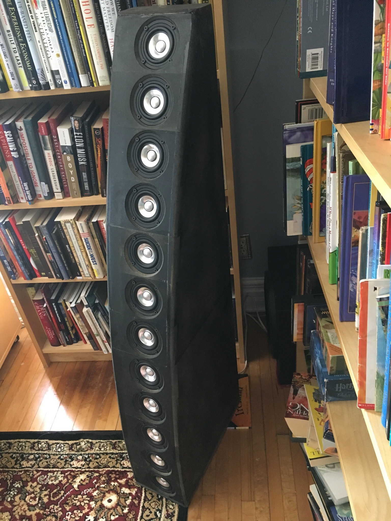

I used twelve Fountek 3.5" full range drivers in this Shaded Array / Constant Beamwidth Transducer based on Don Keele's work. 35Hz-25KHz, high output, 9 octaves bandwidth.
Full technical details in this thread: https://www.diyaudio.com/community/...e-drivers-with-35hz-25khz-high-output.412154/
The thing I'm most proud of is the RC network that shades the signal to each of the 12 drivers differently, which is a solid family of curves. It ensures that all 12 drivers equally share the bass load below 100Hz while shifting the treble to the lower drivers to achieve the desired polar pattern above 500Hz. This also eliminates most of the comb filtering that you get with arrays:
Complete tech details here.
