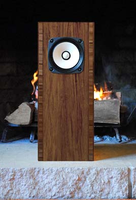

Stranded bamboo plywood dMar-Ken7 with Alpair7eN.

Chris gets credit for the boxes. Box is another in a series that has flowed from the Fonken. Drivers are my work on top of Mark's masterpiece.
dave
dave
rather easier to draw than to fabricate - the rabbeting is particularly fiddly
what the photos don't show and what took rather a bit of bother is the perimeter wrap grain matching
It is certainly a lot easier for me to fix my mistakes. Chris does awesome work
The bottom matches too.

One curiosity: the cutted edge of the front panel of the uFonken, (they are 45 degree in the drawings) have sonic reason or only aesthetic ?
Thanks,
Davide
The 45 degree cut is to decrease baffle diffraction. As far as i know.
And yes, the Fonken/Mar-Ken/Mar-Kel are not very easy to build 😛
Nice job on the cabs Chris. What's your veneering method?
What finish is on those?
These are in Smith & Fong Plyboo solid 3-ply Bamboo (Neopolitan) , with sides fronts & backs rabbeted into the top/bottoms.
The finish is 4 sprayed coats of ML Campbell Magnamx Pre-Catalyzed Lacquer 25deg sheen, hand sanded between coats.
On post veneered boxes, I use paper backed veneers and the old cheap trick of iron-on yellow glue.
Whatever the materials, I personally prefer a continuous grain matching wrap around the perimeter of the enclosure. Of course even with 4x10ft sheets this is not possible with largest of cabinets. With highly figured grain patterns the layout for desired results is rather tedious, and usually lower yield. .
With regards to the chamfered baffles, the larger the chamfer the better, which is one of the reasons that the "Prime" series of this topology has the multiple vents on each long edge. Cutting across the three layers of exterior side panel, spacer blocks and interior panel/front baffle allow for a much deeper bevel than for example the milli-size or GR (Golden Ratio) enclosure with the more conventional bottom mounted port slots.
What is that? 😛
Trade name for a brand of bamboo plywood
Smith & Fong Plyboo | Bamboo Flooring & Plywood
not the most forgiving material to work with, but can make for very pretty cabinets
Note that the material used is the solid block core plywood, not the flooring material.

The outer plys are stranded bamboo, not the solid strip more commonly seen. This stranded ply is an awesome sheet material for loudspeakers.
PlyBoo is one of the major suppliers. PlybooStrand Bamboo Plywood and Flooring - Smith & Fong Plyboo | Bamboo Flooring & Plywood The soecif product used in the speakers in question: Plyboo Neopolitan Bamboo Plywood and Flooring - Smith & Fong Plyboo | Bamboo Flooring & Plywood
