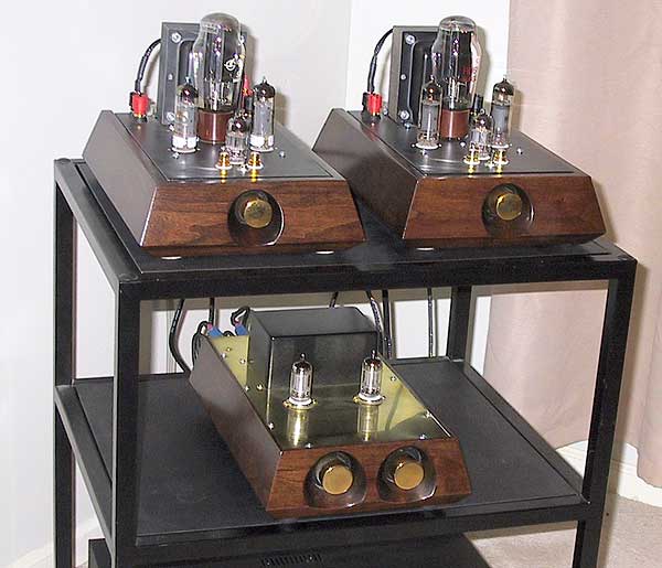

Well here we go again discussing the "suitability" of amps / speaker sensitivity / individual listener preference issue - I guess the parsing of the preceding gives a hint as to my take on it. :rolleyes:
FWIW, I've built and listened to many dozens of enclosures with FE 127E in mono and bi-pole configurations and one of the sweeter sounding amps I've heard them with is a variation on Alex Kitic's RH84 design. (my scribbled schematic attached) This particular project arouse from some dabbling around with spare parts after performing some simple mods to a pair of Zen C and building a matching Bottlehead ForeplayII a few years back - and had approx the same power as the Zen. To my taste, I preferred the triode connected EF86 as driver to a variety of 6922/6N1P/ 6DJ8 etc types that I sampled at the time - the only downside is that it's not a dual section device.
Slightly higher on my preferred amp list for the FE127 is a custom EL34 SET designed by Eddie Vaughn - GZ34/film cap & choke filtered power supply, Raytheon 5842 driver, Bud Purvine OPT. More power than the Carina that a friend of mine had - also a very sweet amp, but quite frankly between the 2, I preferred the EL34.
From the DHTs in my collection, I prefer the Bottlehead Paramour 2A3 (3.?? watts) to the George Wright Mono7 300B for driving the FE127E.
As to any miniscule loss of sensitivity resulting from the EnABL process, I find that the extra depth of information it unmasks more than makes amends for that. As very little of my musical listening is over SPL of 90dB, I can happily enjoy the match of 2 or 3 "tube" watts and 91/92 sensitivity drivers - certainly more so than 20-30watts of SS - including T-amps and a DIY mini-Aleph. If that means my taste is on the "romantic" side - so be it.

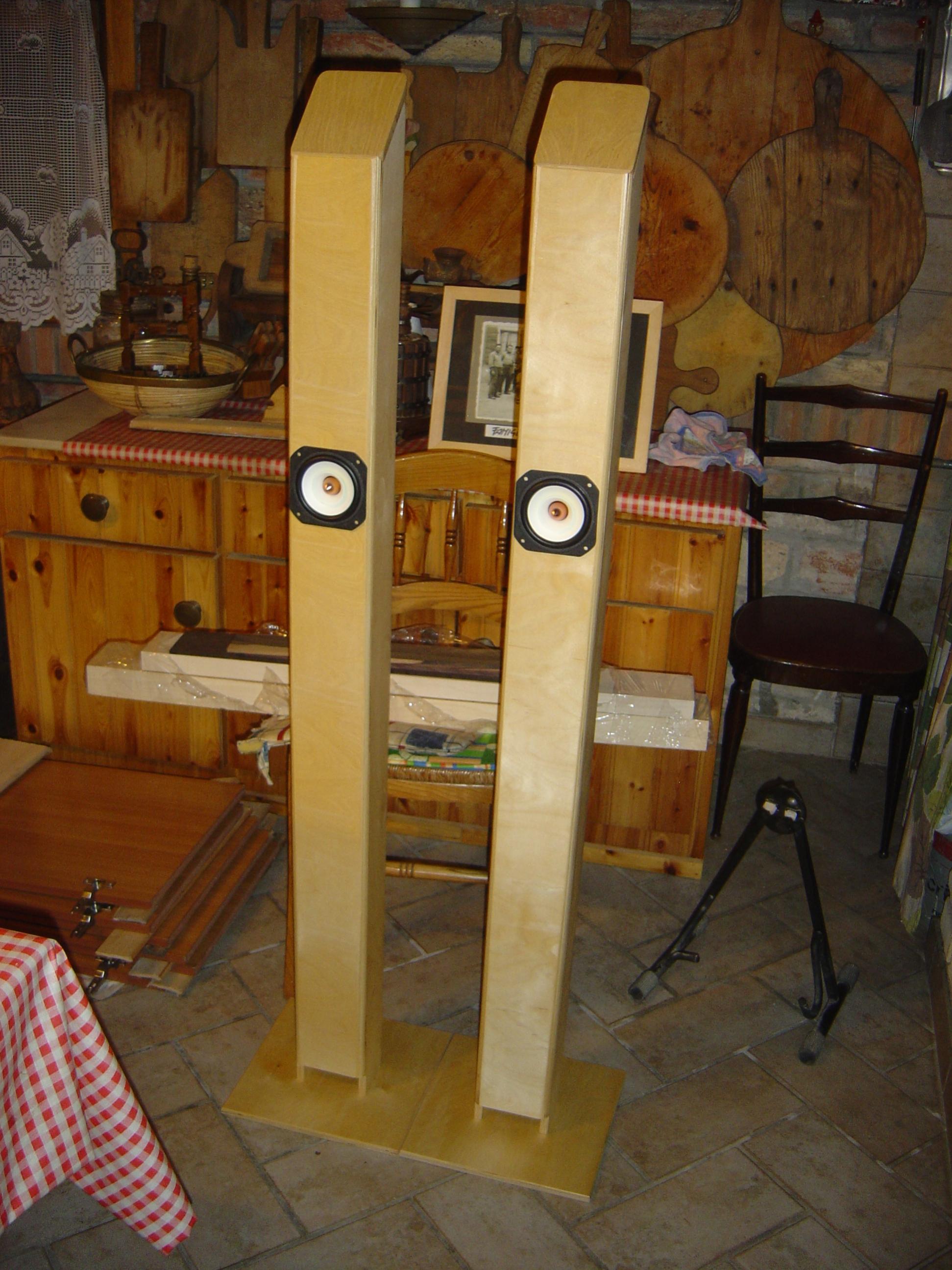

My contribution
I thought it was about time I posted my contribution to the Full Range picture thread after being inspired by what other people had done. (mind you most of you know what you are doing....I don't:D)
Mass Loaded Transmission Line (2.2m long TL) approx 20 litres volume, drivers are CSS 125's.
Hope you like;)
Well, initially they were a bit bright and base light which I was surprised about given the TL. :eek: However through a comination of running in and adding quite a Bit of stuffing behind the driver and down the start of the TL. I soon got a better balance. Firing them straight ahead also helps. After a week of continous use and playing around with wool/foam I'm quite happy with them now. If you wanted proper bass power a sub would be needed, but this could be to do with the power amp which is a bit bass light (tripath 2020 amp).
Driver link below
http://diyaudioprojects.com/Drivers/CSS-FR125SR/
Nick

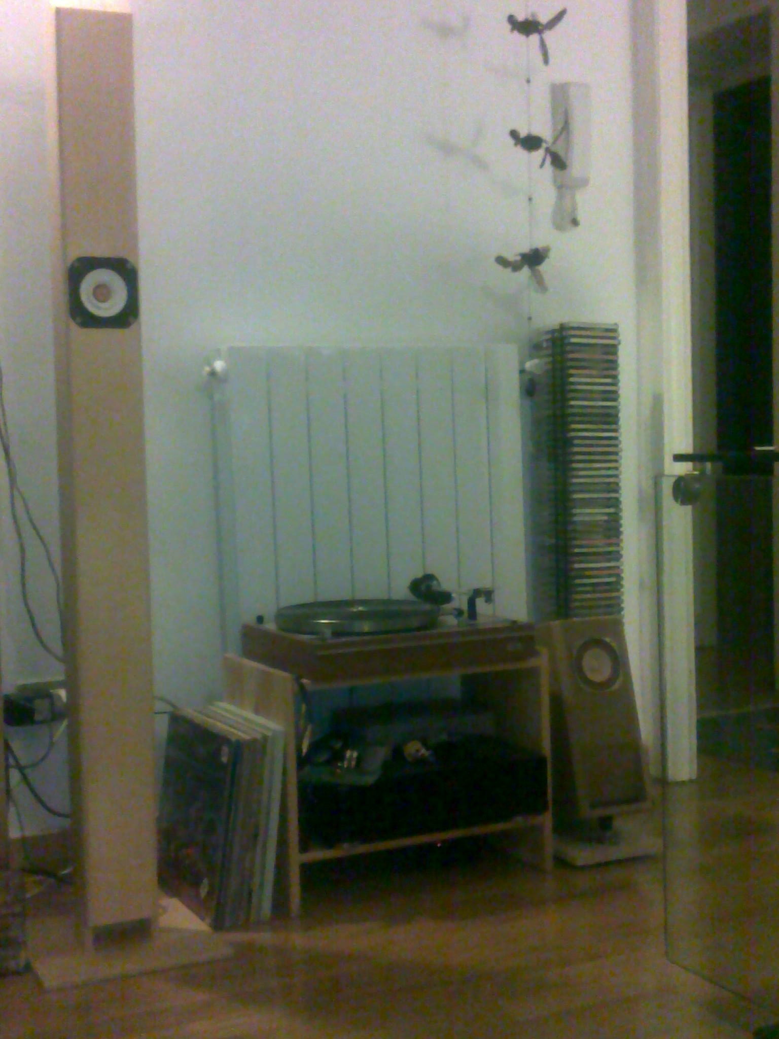

My fullrange experiments!
Here they are!
As a consequence of moving in a smaller house, I left my beloved JBL Jubal and started the "fullrange-low power" way.
It's not bad at all!!
For you to see my "Pico-Lino" with fe-103 and my Zigmahornet with a strange chinese 4" fullrange I bought on e-bay.
The latter are a sort of fe-103 with loudness on: absolutely recommended as they overcome the limits in freq. response of the fostex.
