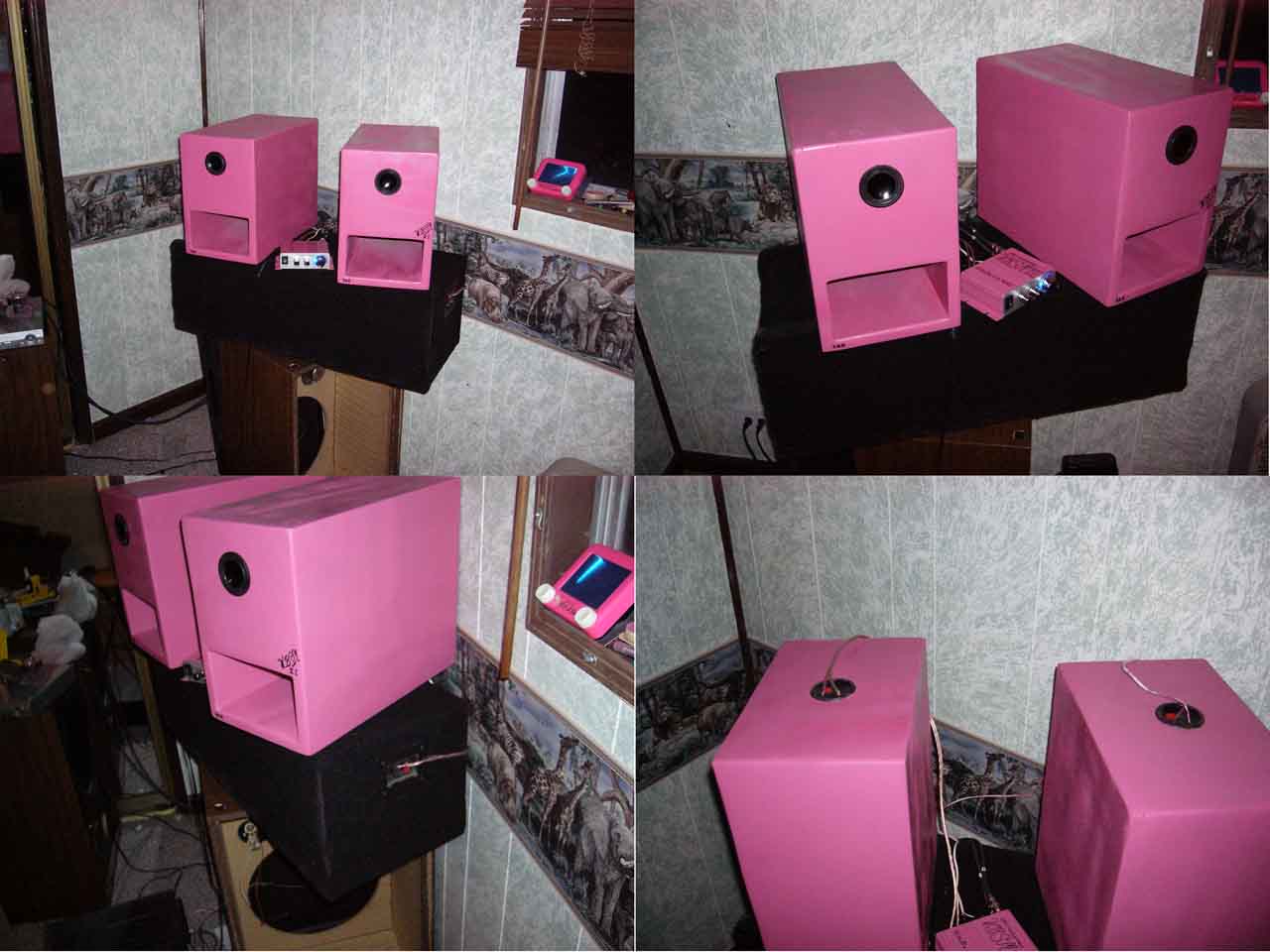

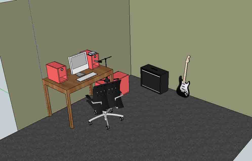

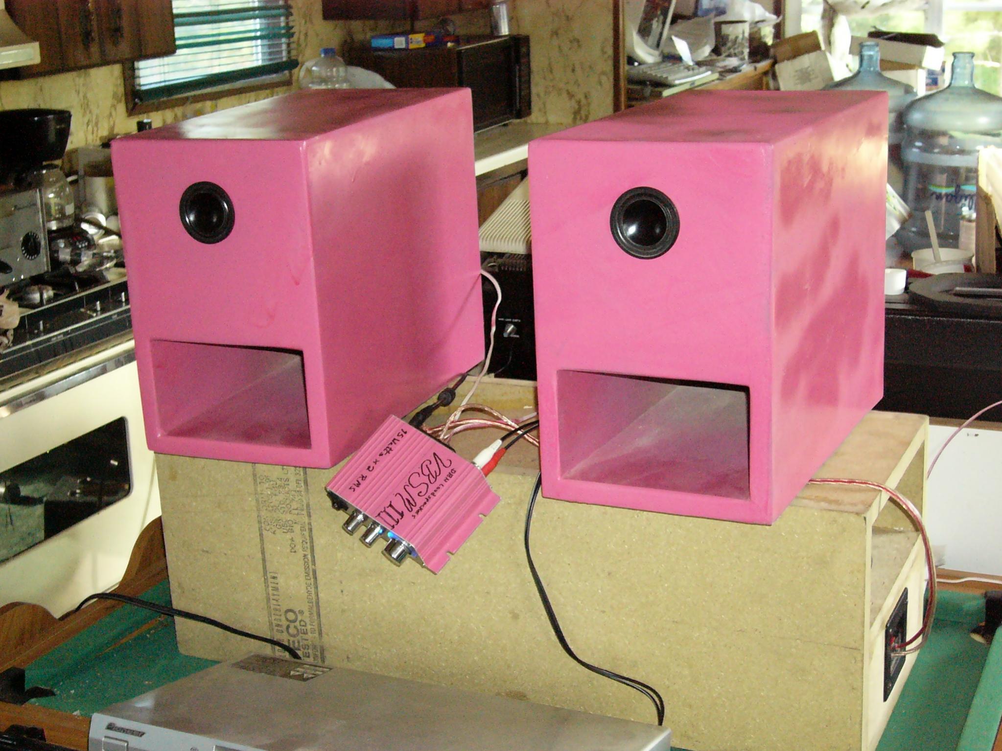

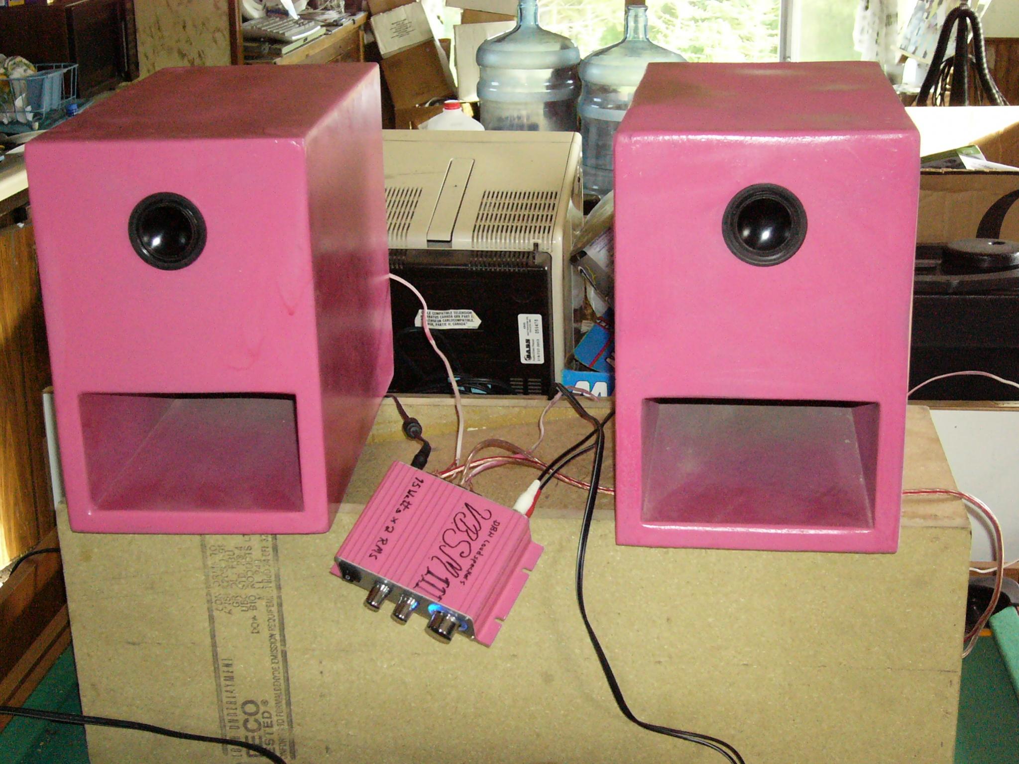

Here is a set of RLH/TH studio monitors I designed and helped build for a graduation gift for a friend of mine with a beautiful singing voice. She was using a guitar amp plugged into her Mac to listen to her recordings so I decided to design some nice near field listening monitors for her. The satalites still need some more sanding and another coat of paint and I'll be carpeting the tapped horn subwoofer, but these babies sound fantastic powered by a 15W+15W T-amp.
I forgot to give details. The wide-range drivers are Tang Band W2-748SGs the horns go down to 100hz, and the tapped horn has an MCM 55-2421 8" Subwoofer than goes down to about 35Hz in this cabinet. They are all connected to a 15W + 15W T-amp that I bought on ebay, with the sub connected bridged. I didn't think this would work but the left and right still seem to have seperation so all is well I guess. Probably too low of an impedence on the amp but it sounds good. The TB are considerable more sensitive than the sub so I'll be installing L-pads in the sats the sub has a coil on it that seems to be attenuating the mids fairly well, I don't know it's value as I just found it lying around. I'll probably look for some good sized caps to put on the sats just to keep them from popping when they are cranked. Please feel free to respond and ask questions.

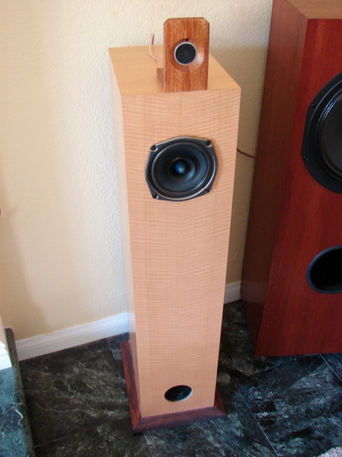

RS 40-1354 in Bob Brines Folded ML TQWT
I found a pair of Realistic 40-1354 on the cheap. I had some tiger maple cabinet doors that I salvaged from a dumpster and decided to build Bob Brines Folded ML TQWT
Brine Acoustics
For my ears, the need some HF help. I found some ribbon tweeters for $1, crossed with 2.2uf cap. It seems to do the trick.
I was a nice project. They sound quite nice. Did not have to use BSC.
There are additional pictures in link below
RS 40-1354 More Pictures

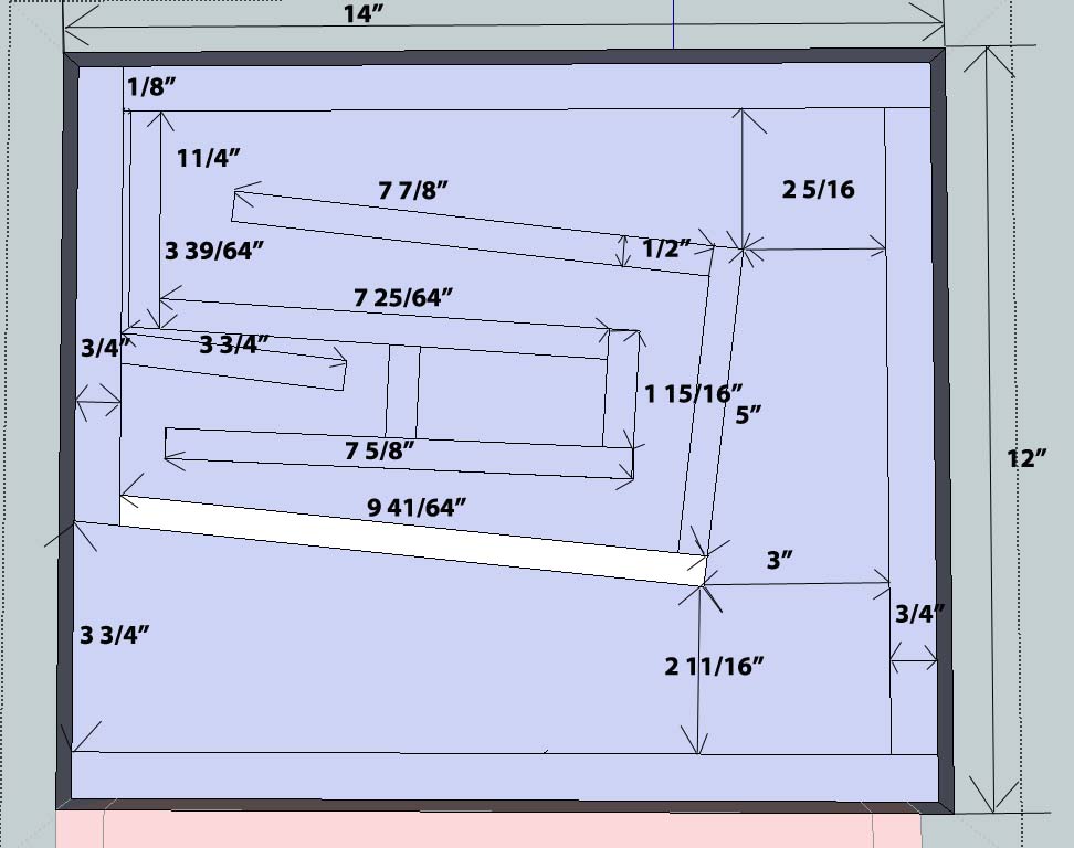

So I'm curious what'd ya'll think of the pink monitors? I gave them to the girl last night and I still have yet to hear what she thinks of them. But I guess this IS show and tell so what do ya think? Oh yeah here is a drawing of the inside of the horns.
