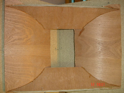

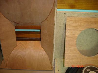

thanhVNS said:.
Thanks, could you explain exactly which you want to see then I will show you in detailes. Hope to see you soon, there are some pics FYR
BR,
ThanhVNS
Sorry, I can not post multi pics in my reply.

Hi, felixx
This is Horn Bafle FYR. By the way could you explain the reason why I can't post multi pics in the one reply?

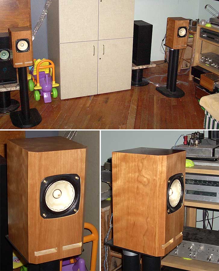

Here is a picture of the 3rd revision of the mFonken (milliFonken). I've not yet givem them a proper listen so i can't say yet if we achieved the goals we set for ourself with this development. Note: these have an extra piece on the bottom which changes the aspect slightly and slightly spoils the cosmetic ffect of the port placement.

Woah! Loks very similar to mine 🙂
jleaman said:Woah! Loks very similar to mine 🙂
Both the boxes i designed for you, and these intentionally echo the Fonken.
dave

Looks nice. What is the approx volume and tuning?

It is 4.5 litres. I never pay attention to the tuning frequency, i just make the curve look right and then make it aperiodic. By adjusting the added resistance of the port i can tune the bass (hence 3 versions so far). The 1st was a regulkar ported box just to prove to ourselves that the idea of a box this small for the FE127 wasn't crazy. Then in version 2, the port had a little too much R, this one takes the R back, the goal to get a little bit fuller bass (response goes to somewhere in the neighborhood of 100 Hz).

Hi, Planet 10
Very nice cabinet, I dit one long times ago but its could not produce a good Low Frequency as I described. How about your?

Do you have impedance plot for the ported and damped enclosures?
gmilitano said:Do you have impedance plot for the ported and damped enclosures?
Nope. I never got a chance to measure the 1st versions.
The ports have no damping in them, they are just long with a high aspect ratio.

Hi, Planet 10
Regards
Yes, no real deep bass - these are really intended for small room/nearfield use (would make great 'puter monitors with class T amp), as well as part of a very portable demo unit for the capabilities of the FE127eN
In larger venues, high pass around 100-120 and powered woofers would be worth consideration.
