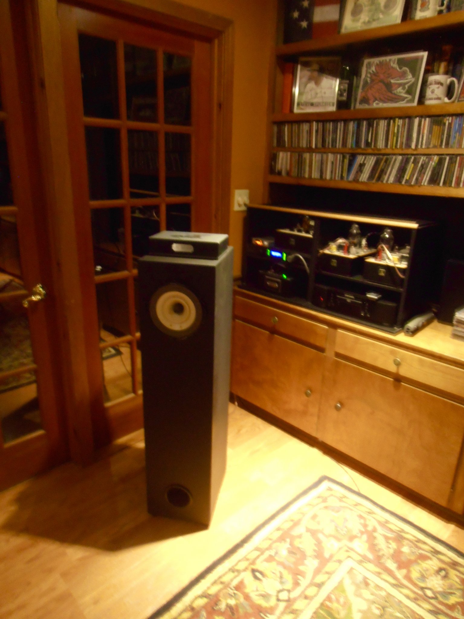

There are many people who make use of the air recordings on YouTube.
I have no problem with people using YouTube as source material (not good enuff for critical listening), but trying to convey what a system sounds like by recording it and putting it up on YouTube to illustrate how it sounds to others is next to useless.
The really important differences are lost. And there are so many other factors that conflate the end result…
dave
In partocular all the small details that put life into an instrument or voice and the tiny bits of information needed to create the illusion of a solid 43D image/soundstage.
If you are trying to convey what the speaker sounds like… speaker (this is what we want to listen to) > mic (immediately you ar ethrowing information away) > recorder (with an ADC) > uploaded to youTube (where it is usually compressed — ie more information thrown away) > downloaded > played back with a DAC, another amplifier and who knows what speakers.
Just too much is lost to realistically tell anything.
dave
dave

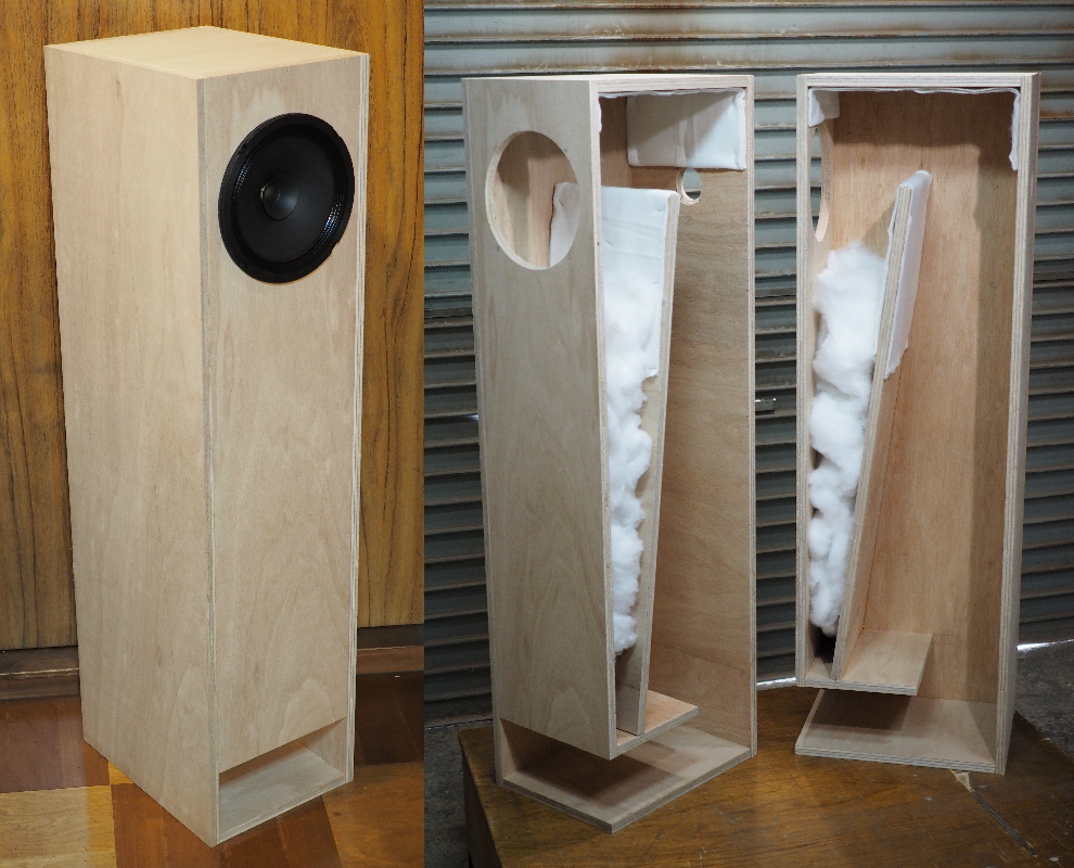

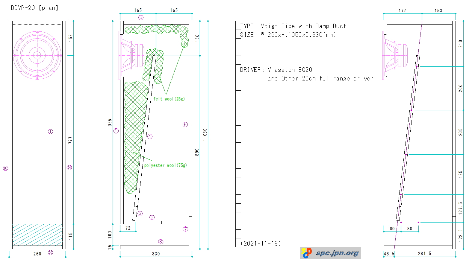

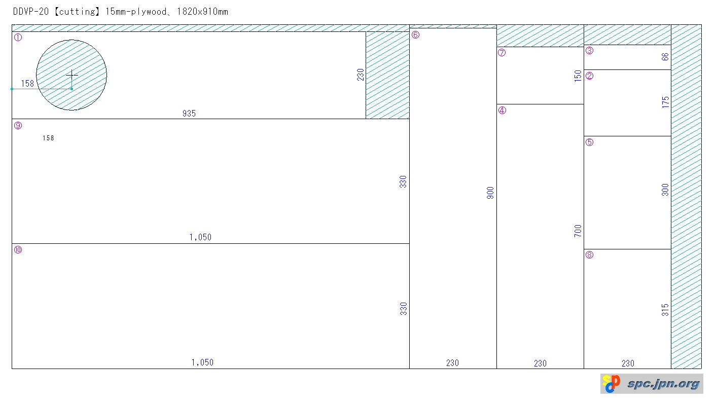

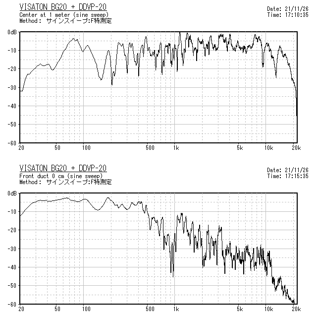

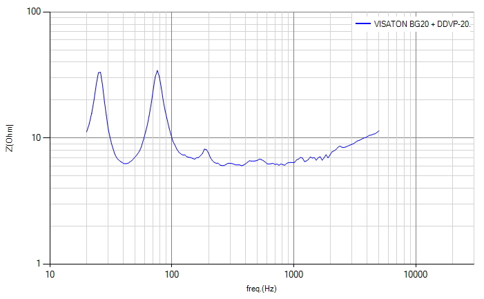

VISATON BG20 + TQWT
Low price, easy assemble, good sound there.
BG20 YouTube
VISATON BG20[20cm fullrange] + DDVP-20[TQWT] / air-recorded at 2.5 meter away - YouTube
BG20 YouTube

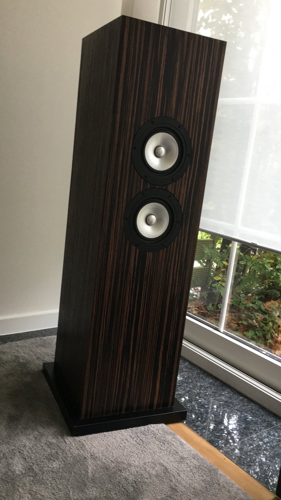

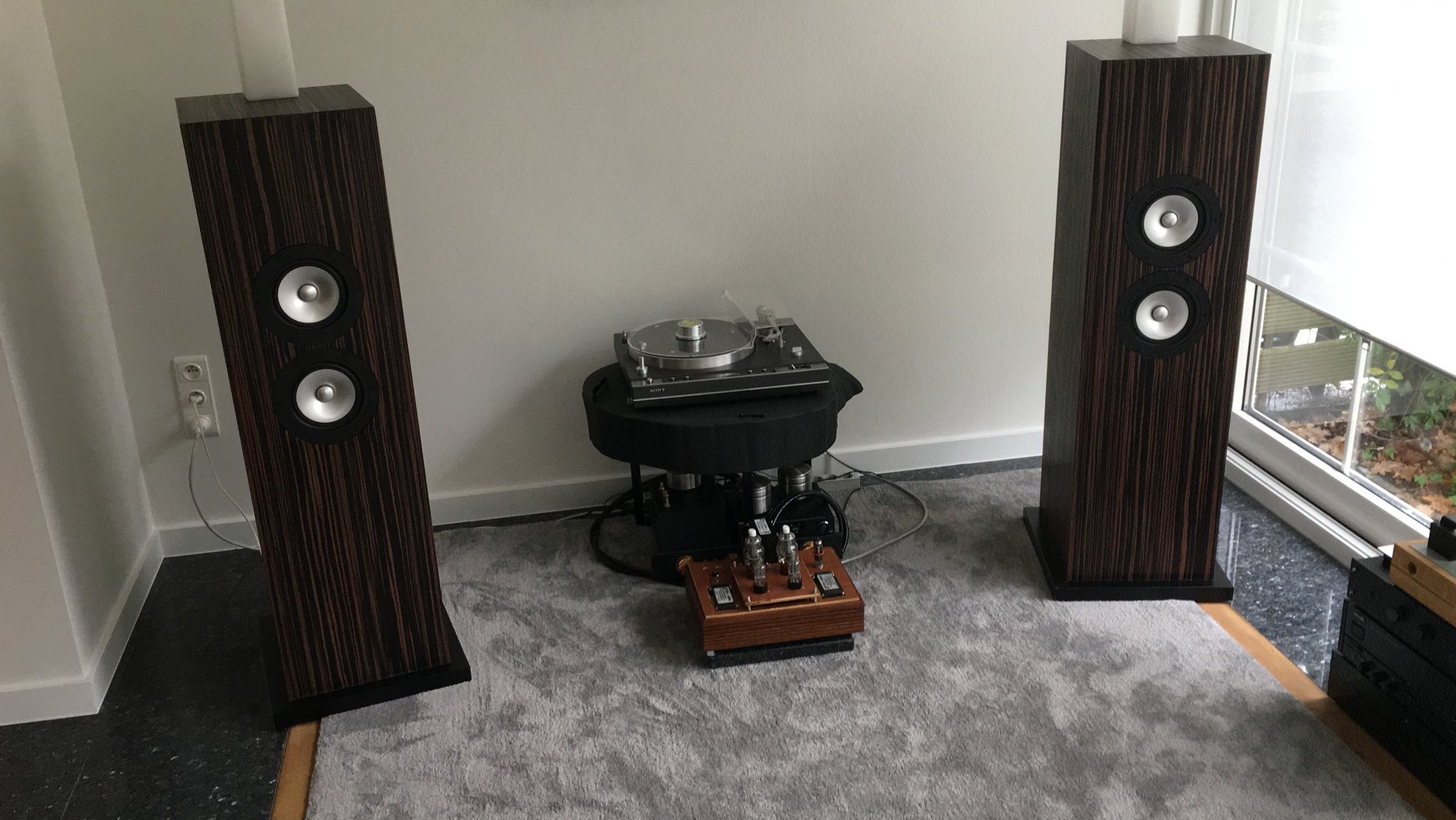

Hello to you all, greetings from Belgium…
here are a few pictures off my recent build Markaudio CHR-120 Hirola speakers, very good sounding,g speakers for my diy 807 poweramp!
Now I am building the Markaudio Orykx with the same driver, curious what they will Sound like 😉
kind Regards
kind Regards
Wow, they look great. I love the design and the plinth at the bottom.Hello to you all, greetings from Belgium…
kind Regards
What have you used to finish them?
Hello F, I thank you, used a designer veneer, I thought it called IPA or so, it is real veneer no vinyl or so… then i put 3 coats off shipvarnish satin on it!
regards Rudi
regards Rudi

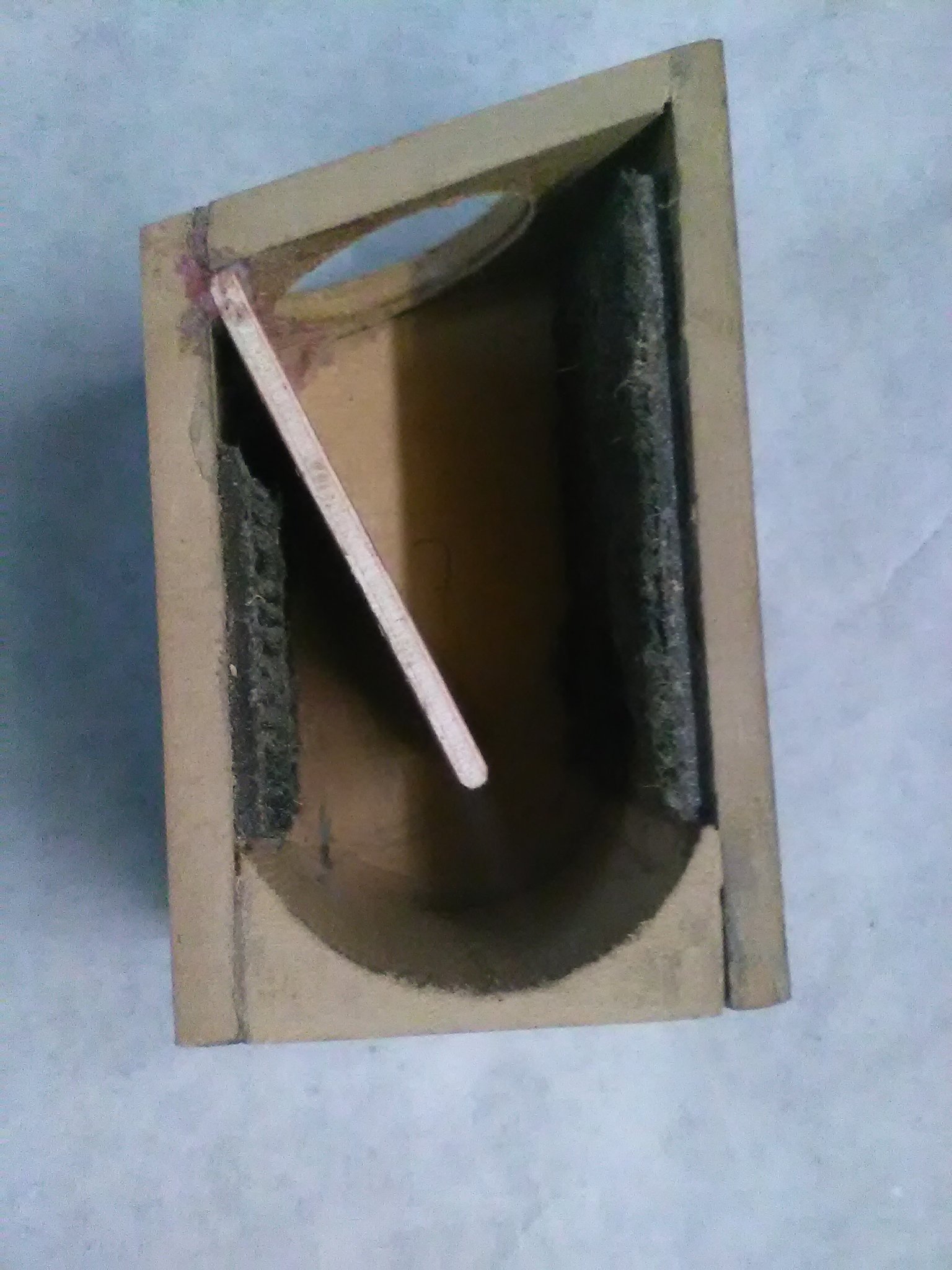

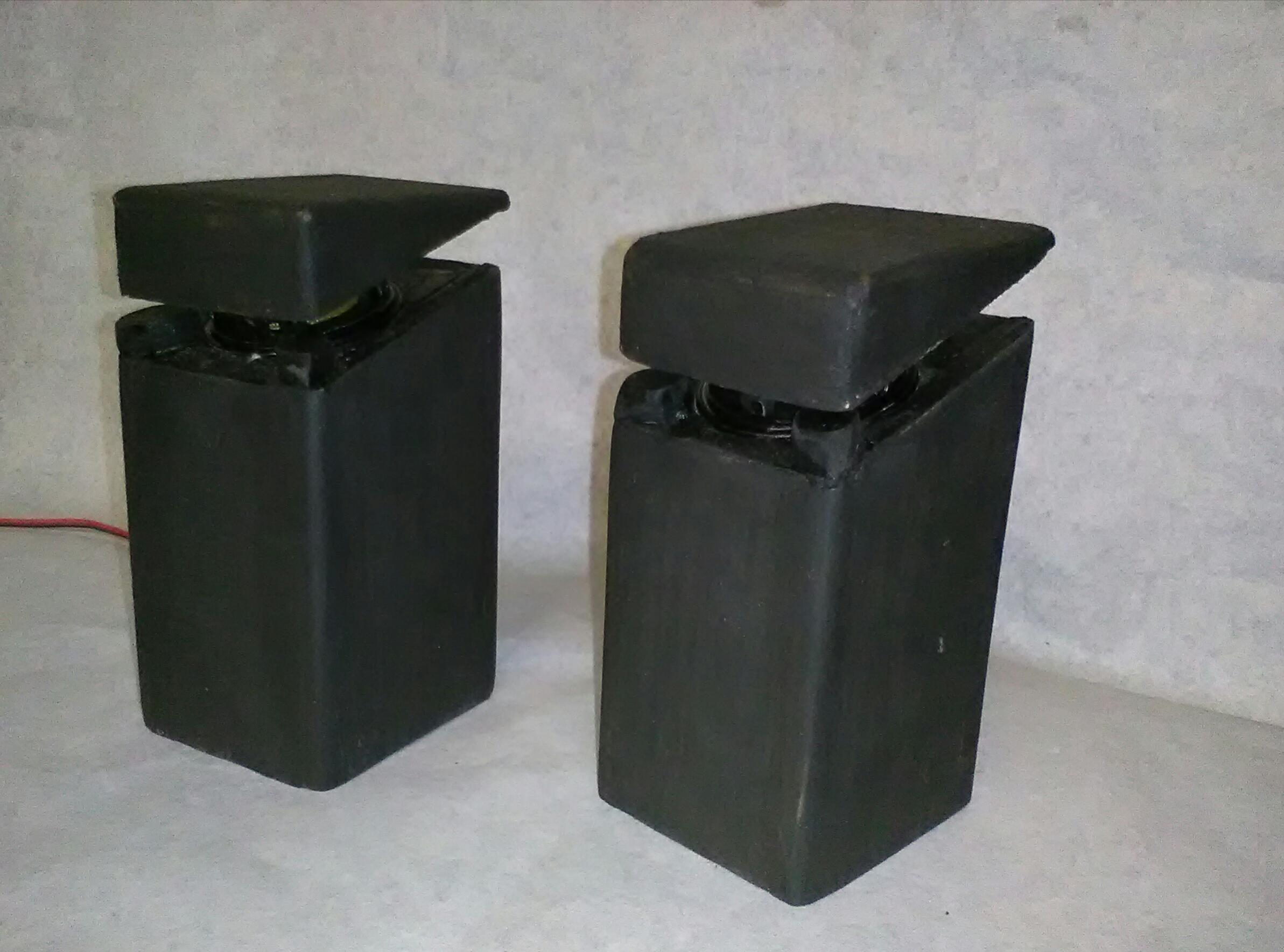

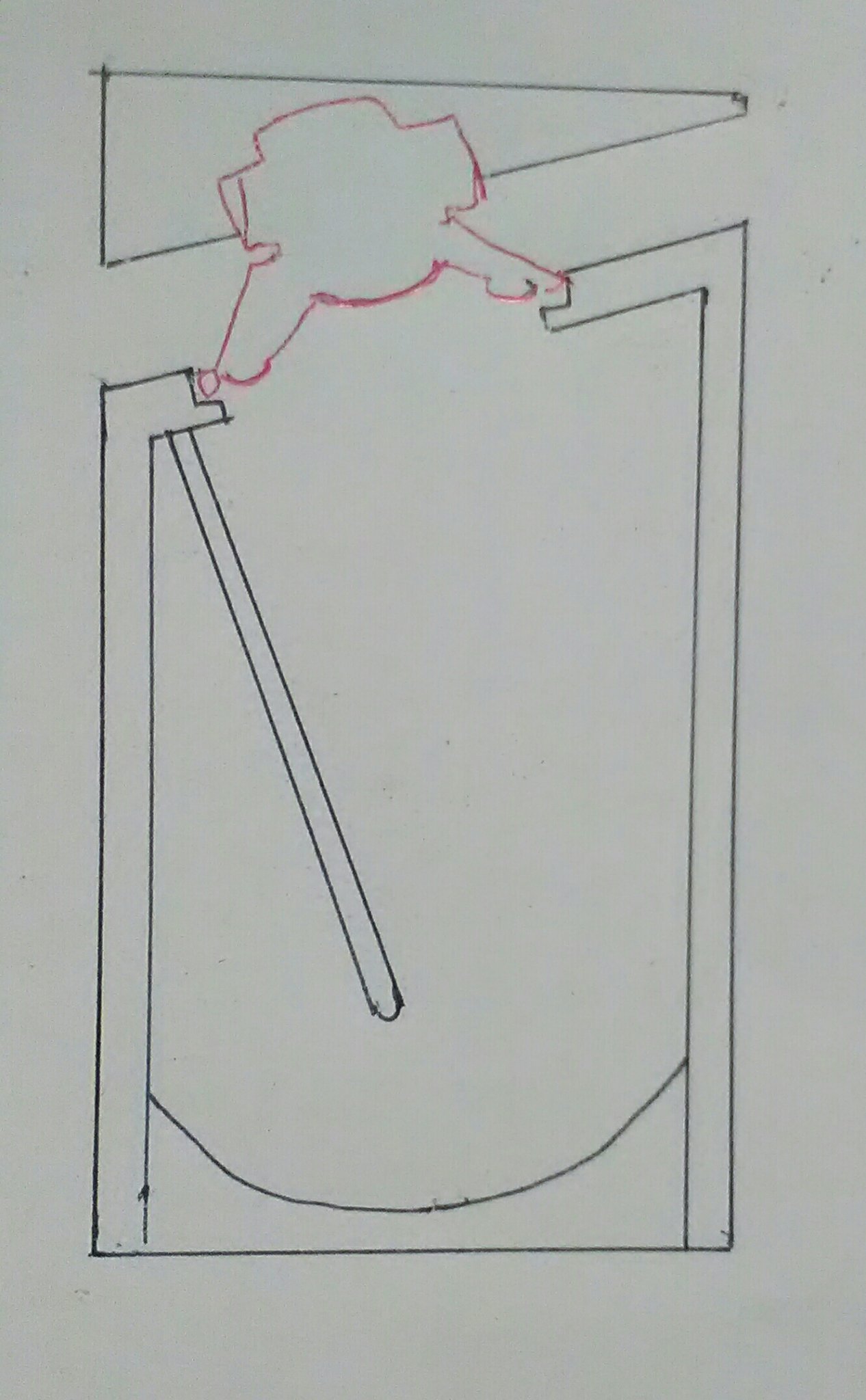

Greets!Markaudio CHR-120 Hirola speakers
I give up! What are these?
They are ( tiny ) omnidirectional speakers, the driver is mounted with the magnet on the outside, so the cone disperses the sound radially. The enclosure is designed to absorb the rear sound wave, hence the baffle inside that also acts as a brace. The top wedge is currently made of wood, however I intend on making some out of solid steel to add weight to the driver; I did experiment with using small weights on the wood wedges and it did seem to reduce vibration in the enclosure. I initially tried them on their own, at first the lack of bass was very obvious, however after a while and becoming acclimatized to the sound I started to hear bass despite it's absence, an interesting effect. I have since used them as a sat and sub system with an amp/sub for cheap computer set up. Despite a ( presumed ) gap in the frequency range between the omnis and the sub, and the boomy one note nature of the sub, they provided a surprisingly enjoyable sound, good enough for TV or DAB radio. They may be toy speakers, but they do sound decent in the mid and treble. I know that the workmanship is a bit lacklustre, however I thought that they might inspire others to try something different.
They are ( tiny ) omnidirectional speakers...
Neat! What driver do you use? Did you ever measure the frequency response? Is the tapered line stuffed in actual usage? If not, it'll help. I'd even advise drilling out a terminus at the apex of the pipe and stuff it well. As it is, it's a half-wave resonator, with a terminus it'll be quarter-wave and be effective lower in frequency. Thanks for sharing a not often seen design!
