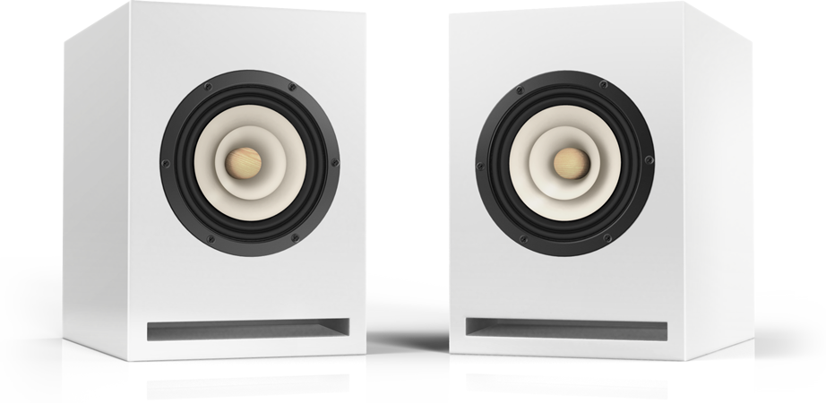

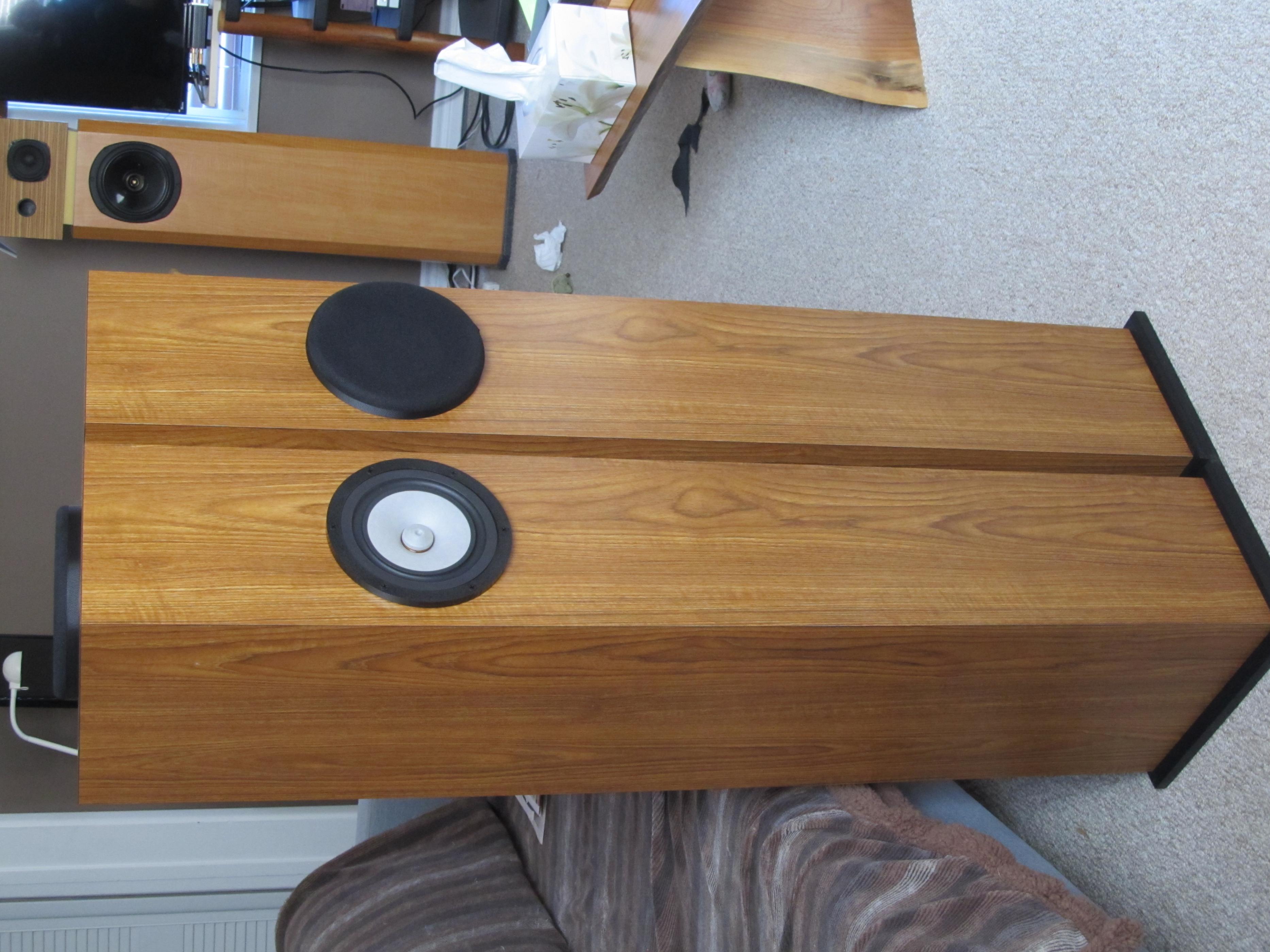

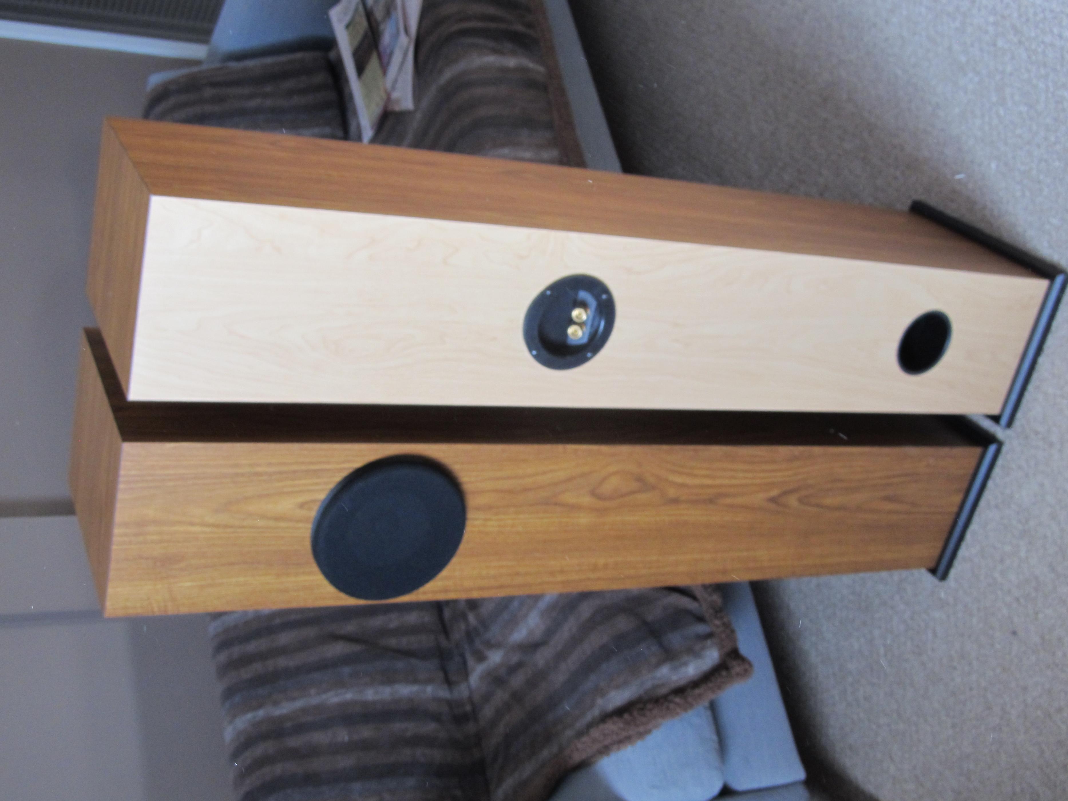

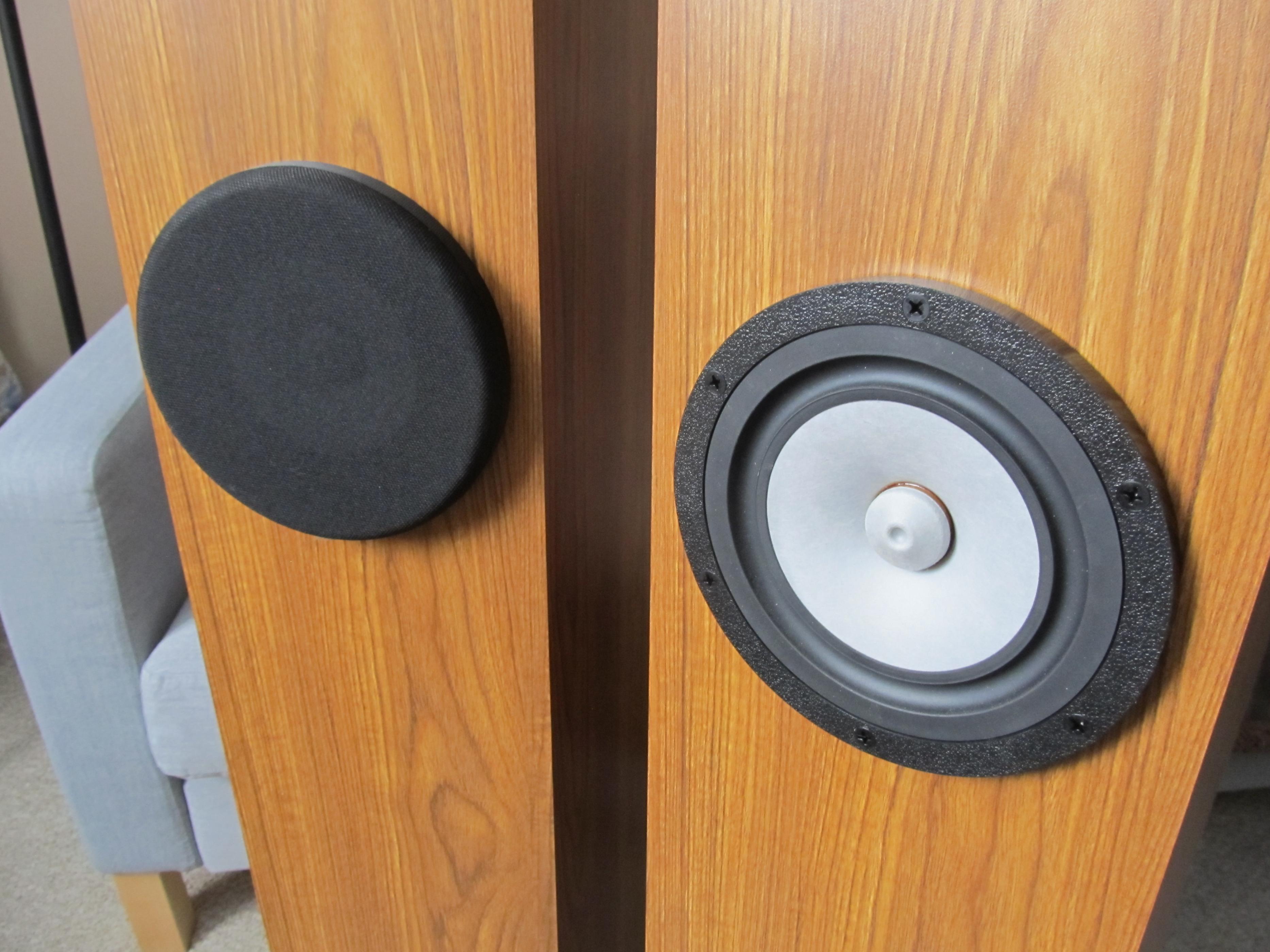

Nope, my own design. I thought it out in my head. I wanted something different...not the tall rectangular box most folks build. I wanted something curvy. I decided to go with curved sides. That's the only thing different with my speakers compared to the regular speakers. Oh... and my TLC that has been added.
oh wow. what a coincidence. stefano's design is a tad bigger and has port that has valve so he can switch between sealed and ported. anyway, very nice im pretty sure that its more rigid a than a conventional design. keep us posted.
*here are some photos of his speakers.
Wow! It is very similar to what I am building. I'm curious as to what his specs are. My specs are 33" tall, 14" wide and 17" long and the material is Baltic birchwood. And how does the valve work? Does he have something that he uses to plug the front port to seal it? I'm thinking about using thin sheets of metal in my ports with the ability to move the sheets from side to side, and up and down. Kind of like the vents in a car where you can control the directions of the airflow and seal off the air if you chose to. Again, this is just a thought. This is one of the things I will soon be testing. I'm interested in knowing how my being able to control the direction of the airflow will affect the speaker. Nonetheless, I'm extremely pleased with the sound and the wife loves them too. Cant wait till Im done.

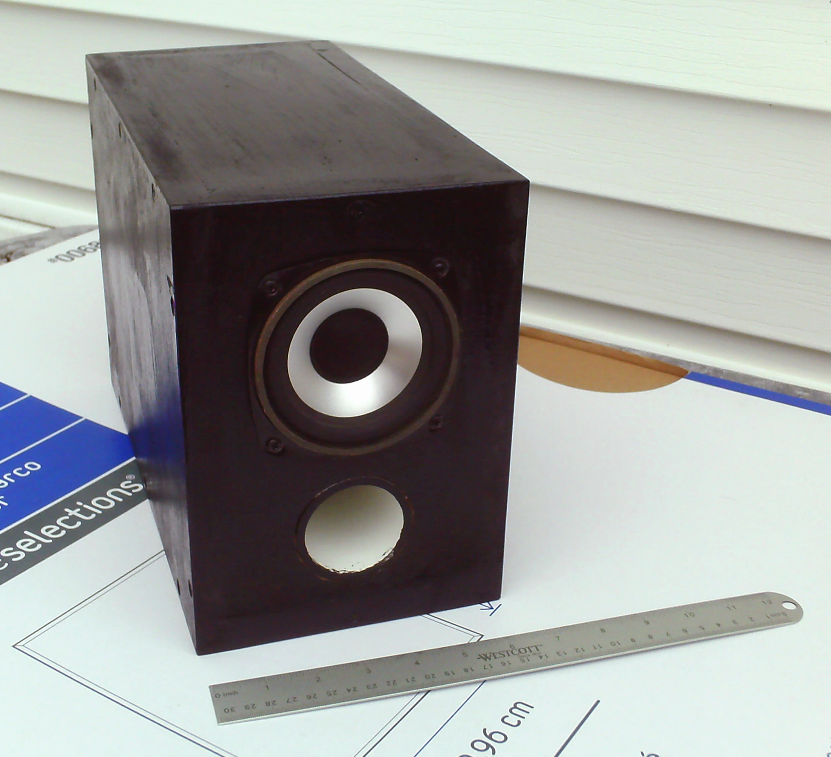

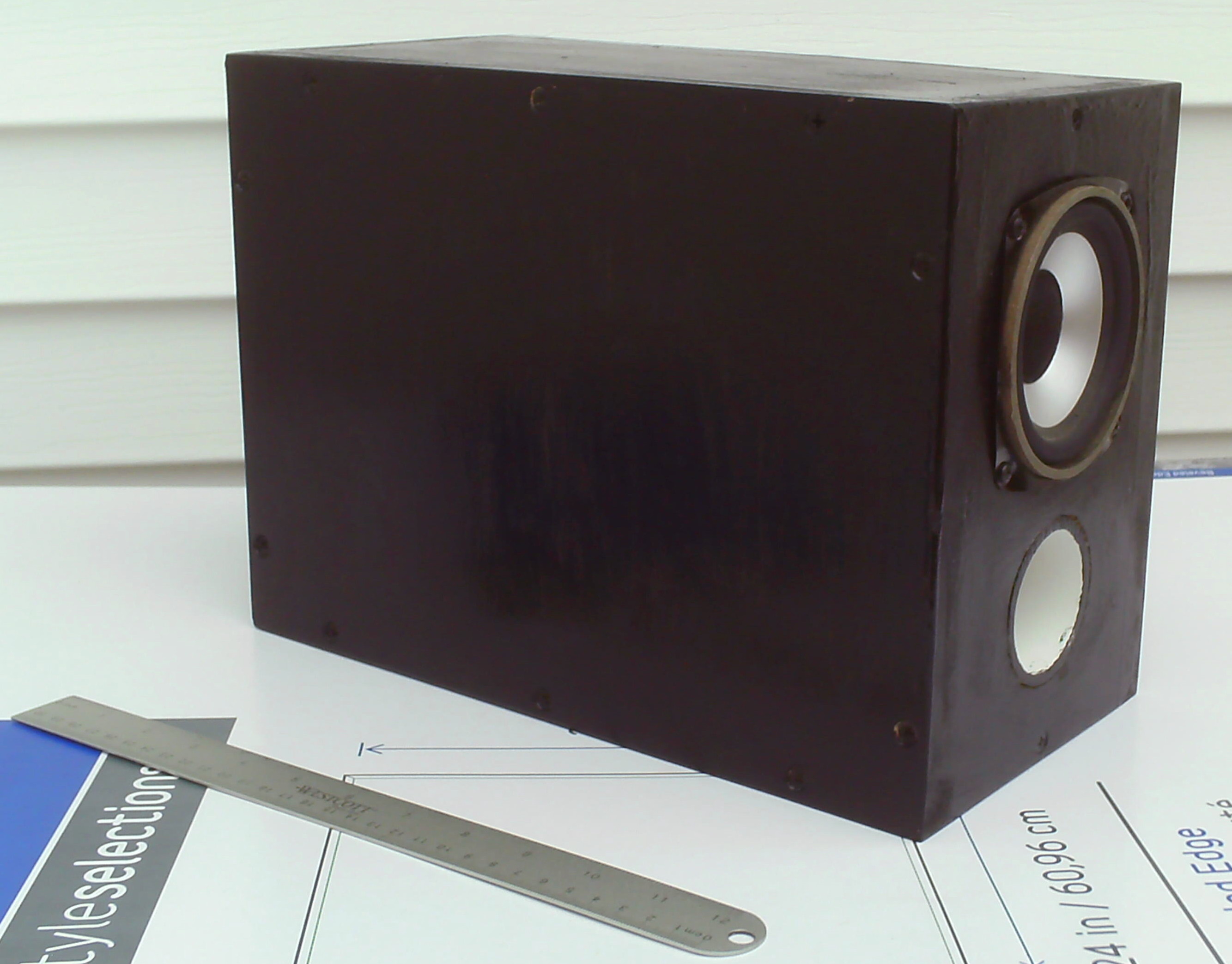

Compared to the other systems posted here, this is quite a humble one. My impression, however, is that this is a good design with the main limitations being not very flat frequency response and the need to listen to them about no more than 2 meters distant if the reproduction is going to be loud enough for the satisfaction of most listeners.
Besides the two photos, I'm attaching a write up on my design explaining what I wanted to achieve, how I arrived at the design, and a construction plan. There is a 12 inch ruler next to the speaker in the two photos to give an idea of the size of the speaker.

What is the size,Xmax, and manufacturer of the driver of your system ? What is f3 of your system? Does it have the same problem as the Eclipse in not being able to reproduce very loudly? What is the vent area of your system? If the vent area is small, this produces distortion by way of power compression.
Your system certainly does have a better appearance than the Eclipse that I built, but of course that is just a matter of the skill and tools that the builder has.
The data sheet for the driver of my system, Newark 55-1853, has a dip in its response from 3 kHz to 10 kHz which is why I say that the frequency response of the system must not be very flat. Possibly that defect is made up for by the fact that it has a f3 of 55 Hz?
Pete

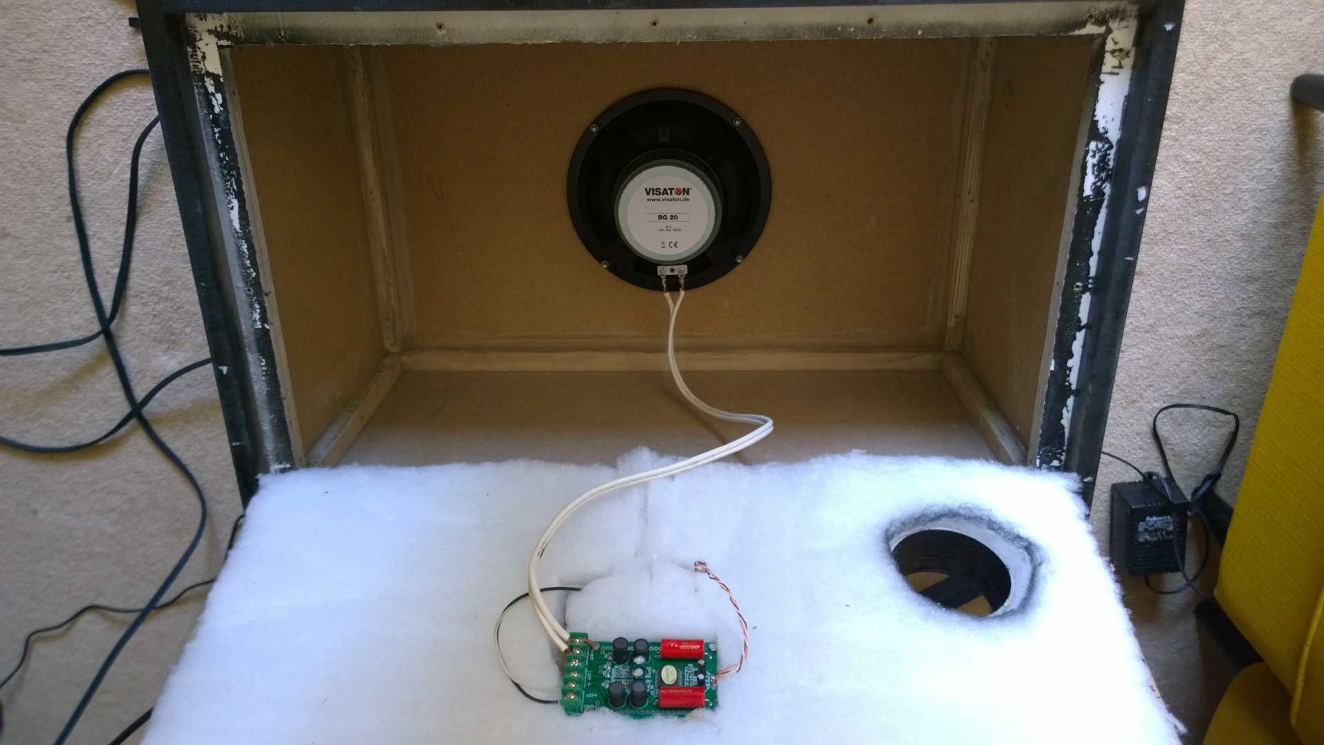

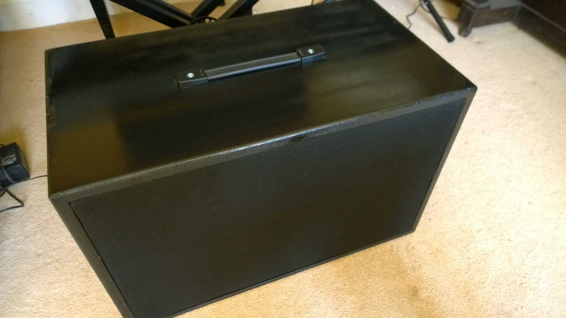

I needed a keyboard monitor for small venues and didn't want to spend a fortune so came up the this simple design.
It's only a 10watt Tripath TA2024 amplifier but the Visaton BG20 Fullrange is 93db W/m so it plays plenty loud enough for what I need and works happily powered by 8 AA batteries.
I haven't measured the frequency response, WINISD put the f3 at 44Hz and f6 at 38Hz in this 72l box and it certainly has a very pleasant sounding and controlled bass response.
High frequencies could be smoother but as it mostly plays piano it's not of great concern.
It performs much better than it ought to at this price, so I'm very pleased.

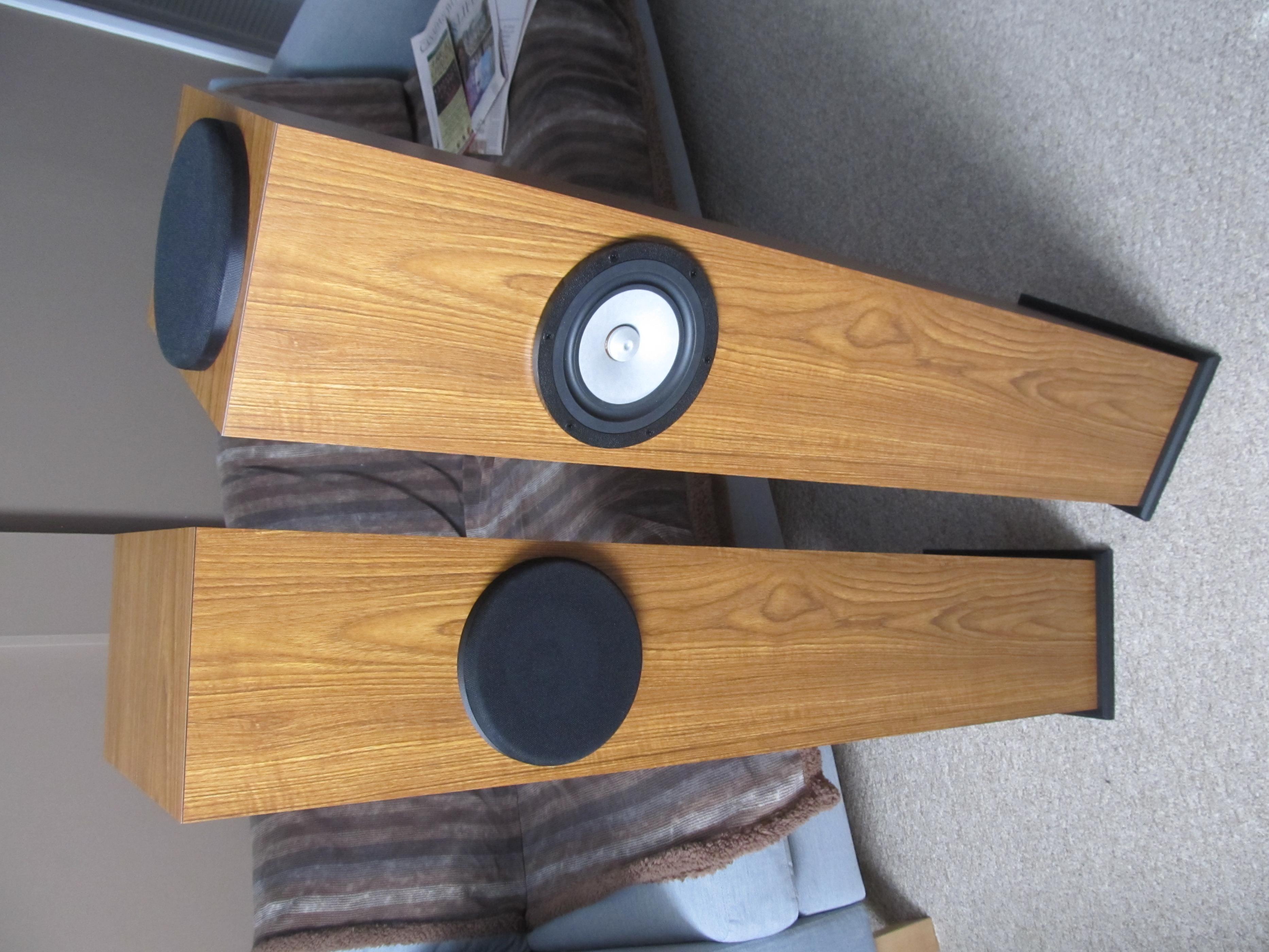

I have been looking forward to posting my own project here for quite some time, it's now finally ready.
Alpair 10.3 in sealed top parts + active bass reflex bottom parts with Ground Zero 250X 10" drivers.
-5db notch filter between 5-15kHz
Goes down to 15hz -3db.
Birch ply with Black 2.0 surface coat on sides.
Nice build indeed! I still like my ml-tqwt / alpair 10.3 speakers. Definitely no need for subwoofer. Notch filter was my opinion too but I wanted to avoid any passive components.
Highs does have some "metallic" harshness around 8-10kHz but I'm using active EQ to fix it. There are some claims that harshness will go away after 100's hours of "burn in" but its just not possible in reality.
Good drivers overall, very clean mids and amazing smooth but fast bass down to 40Hz in tqwt enclosure. Perfect integration. Walls are shaking with these little buggers! There is dip at 300Hz tho.. propably reflection from the floor or standing wave inside the enclosure.
